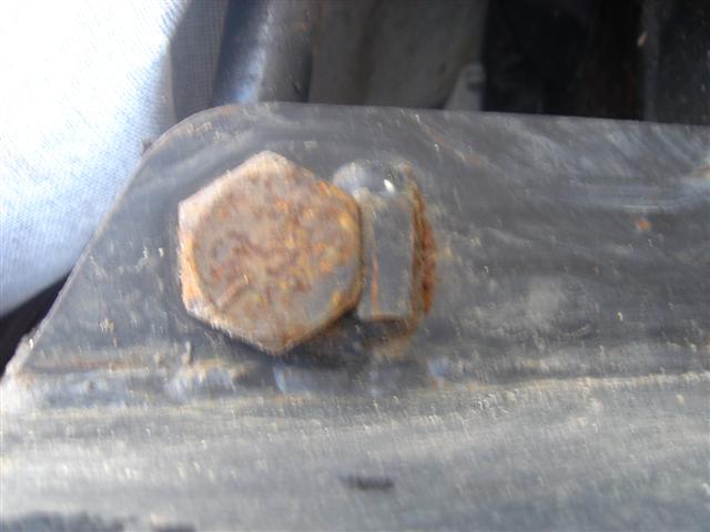

Here's a pic of how it's done on my minihoe. It works good. All you need is an adjustable wrench to take off the nut.

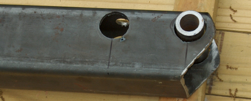

Be careful on that pin stock. True pin stock is 63/64 Both the pin stock and bushings can be found at www.metkit.com
That 1 in steel rod, could be cold rolled, hot rolled, cold drawn. and drill rod. Price varies. Hot rolled would be the cheapest.
I decided on the 1 in grade 8 bolts. 6 in at $3.95 ea. Nylon lock nuts about $1.00
4x4x1/4 square tubing cost $185 for 12 ft. You saved a lot using what you have acquired. The beefed up ends are a good idea, but you have to cut or drill through a lot of steel.
If you know anybody that does plasma, or laser cutting, those 1.5 in holes should come out perfect for your bushings. .
I cut these out with a plasma cutter with a home made wire circle cutter.

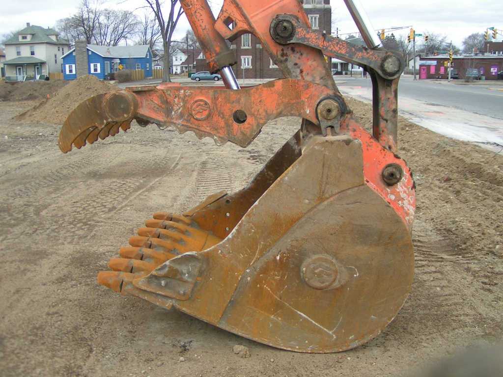

Got my bucket and thumb built.... see attachment.... OK, just kidding. I couldn't resist taking a few pictures of this across the street from my work. But it does illustrate most of the pivot points that I will have to deal with. Good thing to keep for reference.

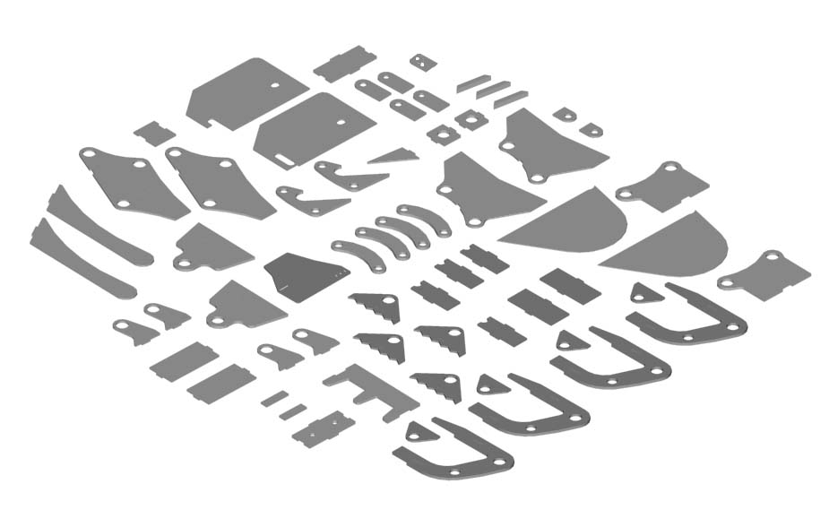

David, here is a picture of the backhoe laser cut parts kit. I had to purchase the square tubing locally.
   / Build A Backhoe For PT425... It Could Happen
#58
Very nice kit. The plans I have don't call for that many parts. I'm sure it will look much more crude than yours when finished. I went and looked at band saws last night. Harbor freight had one on sale for $179.00 I may get it. I have a friend that has the same model that he bought for the same price about 25 years ago. He said it works fine for personal use.

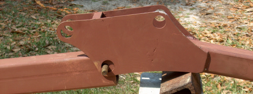

For anyone wondering where I got the plans, here's the link to the page at Vintage Farm Plans. There is a link on that page that will take you to a page with two PDF files. I have downloaded them and printed them out. They are pretty darn good, for the price! /forums/images/graemlins/wink.gif
There was only one place where I had a little trouble understanding what he was talking about VS the drawing. That is the part where you make and attach the two brackets that will attach to the end of the boom to accept the dipper stick. I thought they looked a little weak in that area as compared to the other plans that I looked at, until I went and looked at that excavator across the street. It is built the exact same way, only on a larger scale.
