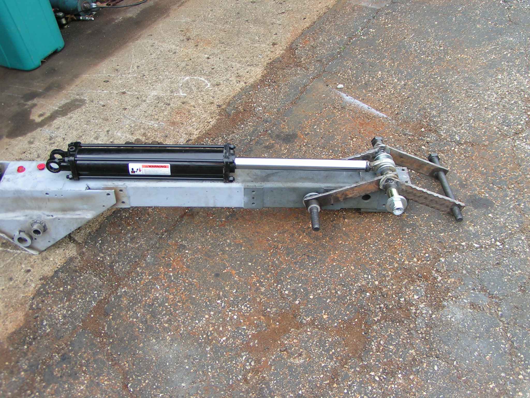

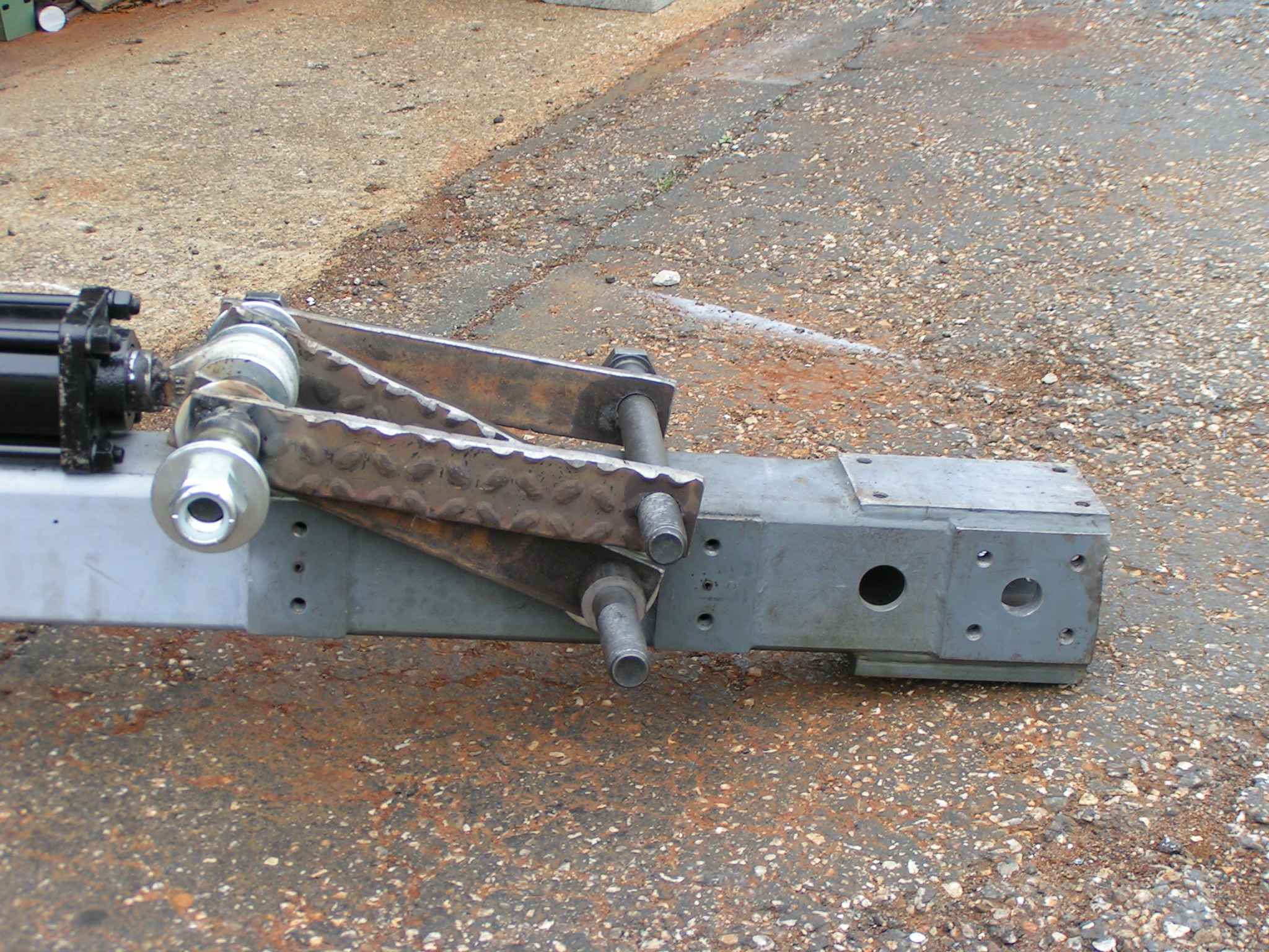

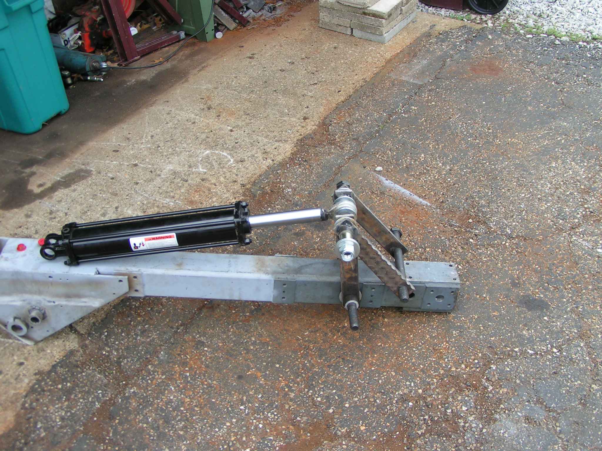

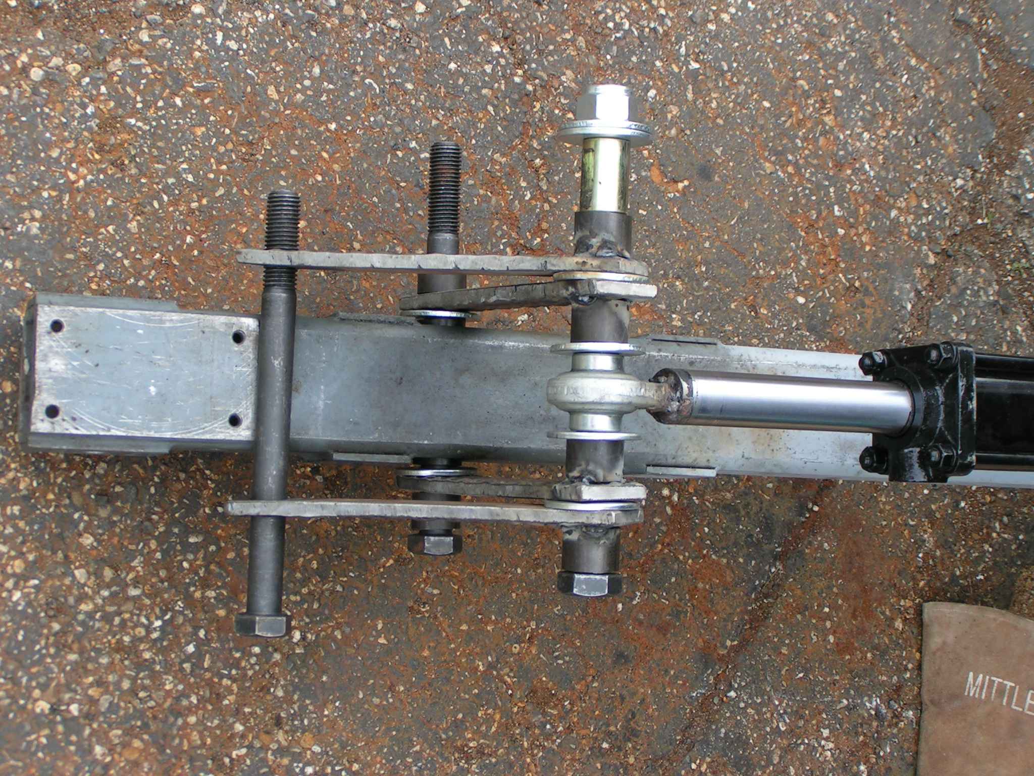

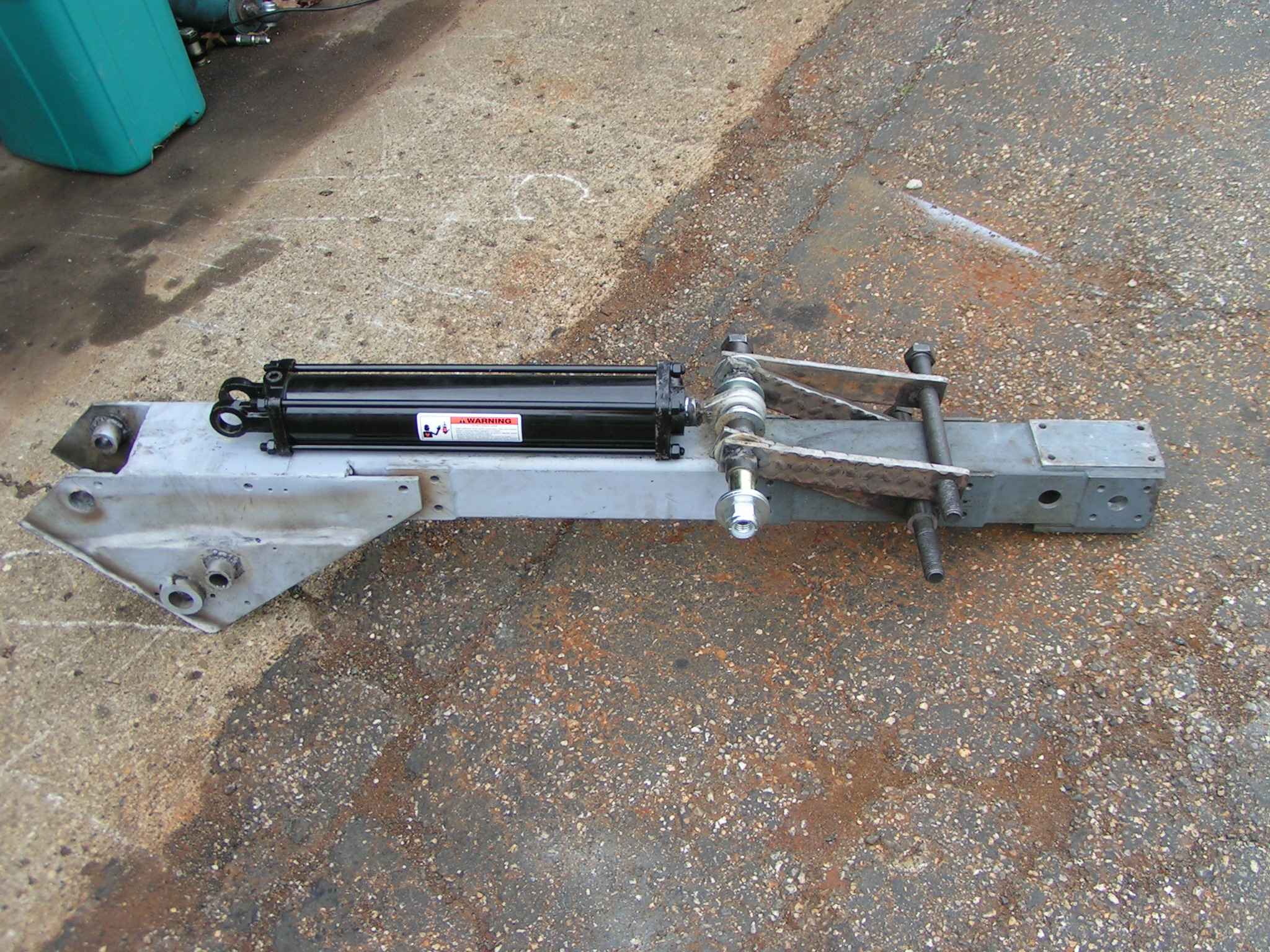

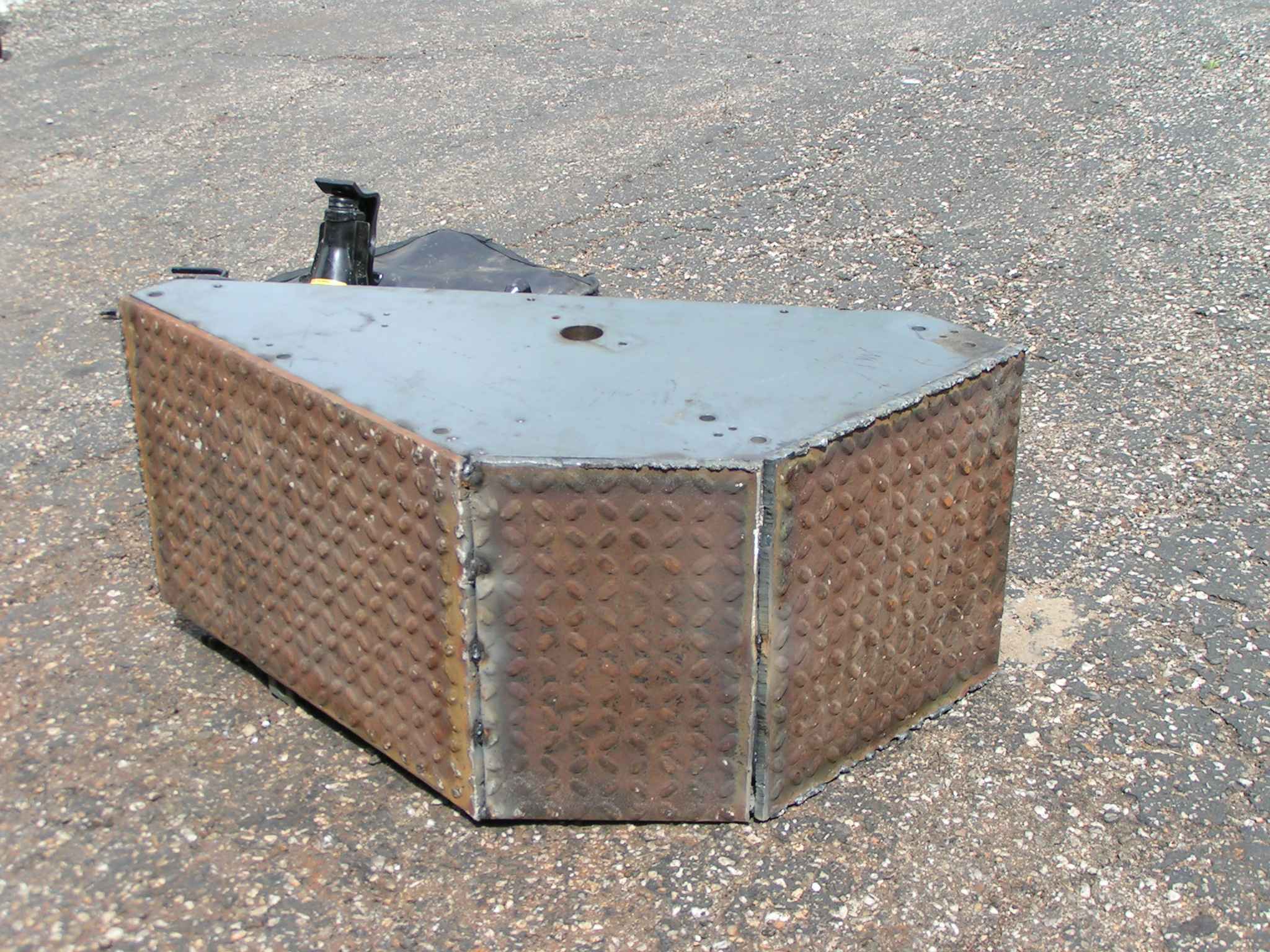

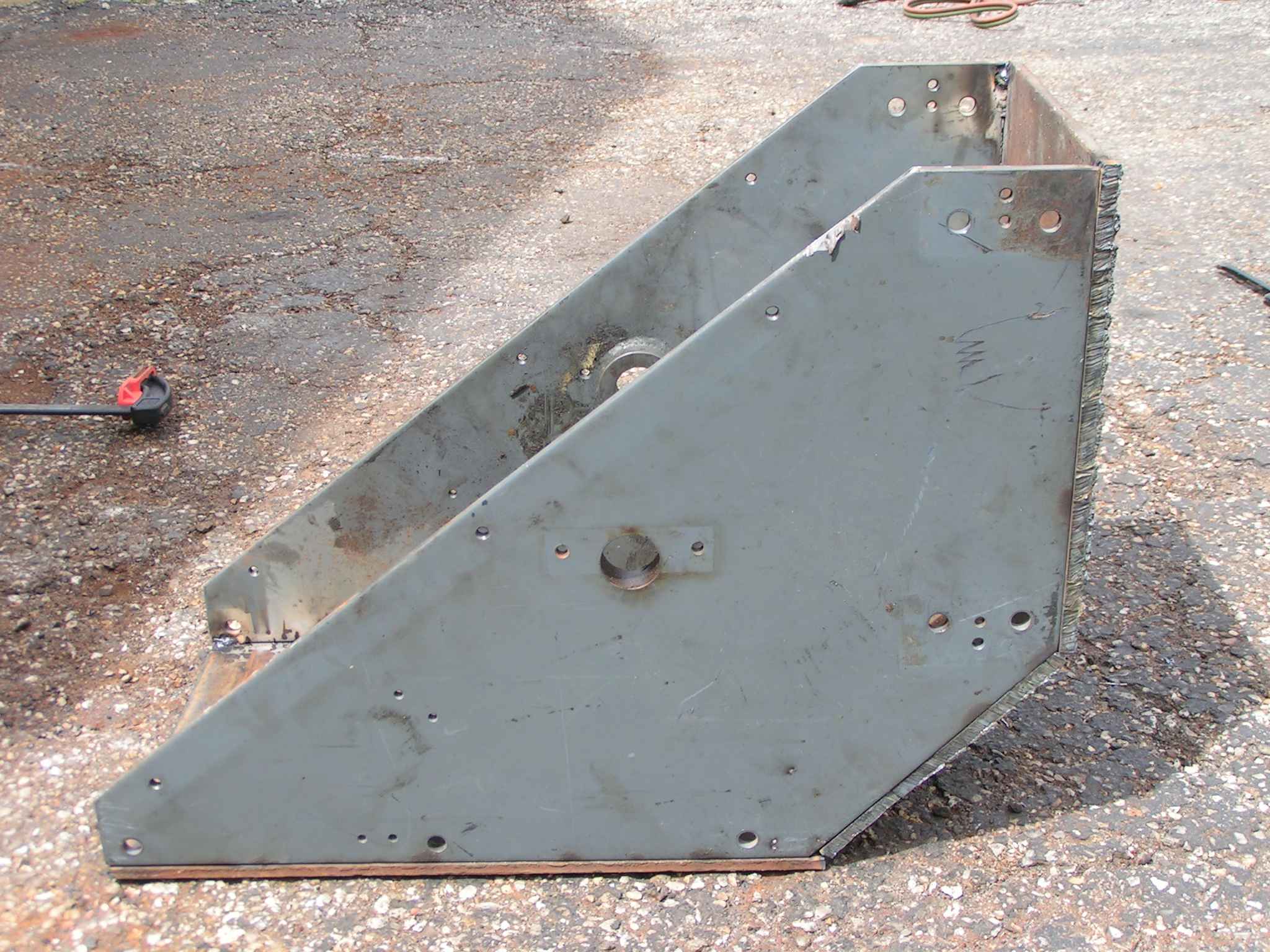

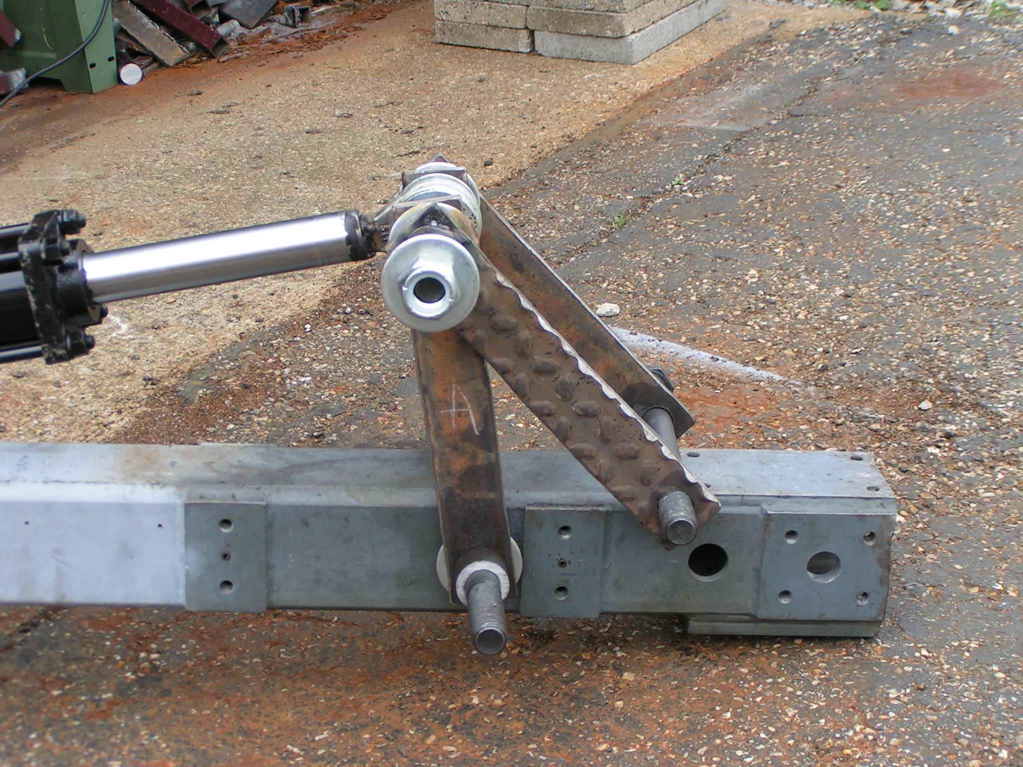

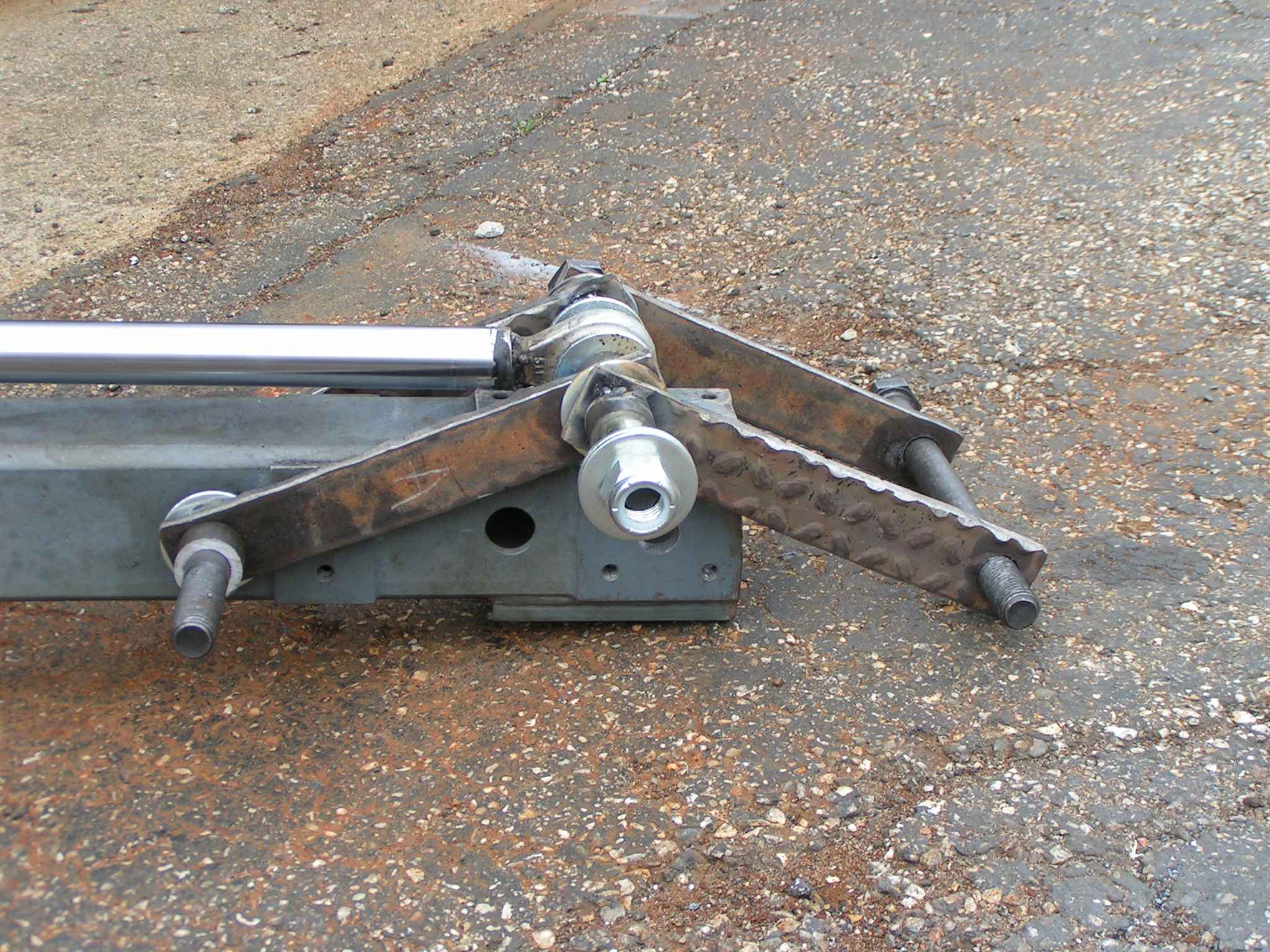

Between people stopping by and occasional spits of rain, I was lucky to get 2 hours in today.
I fabricated the bucket linkage, mounted it to the dipper stick, tacked the spacers and bushings in place and checked for articulation. I need to adjust the cross tube that goes through the dipper stick a foot up from the end. It is not quite square and makes for a small bind. I will ream out the bottom of the hole on the side that is too high and keep test fitting until it operates smoothly and is square with the dipper stick before I tack the tube in place.
I also started fabricating the 12" bucket. The plans call for making the bucket from 1/8 inch plate. However, I don't have any. I am using 1/4 triangular plates for the sides that I think will make for a good bucket shape and size. The bottom and back of the bucket will be from 3/8 diamond plated. The smooth side will go inside the bucket and the diamond side will go on the outside.
Pictures will be taken before I continue. ;)

Pictures as promised. ;)
Running totals:
Time = 55 hrs.
Approximate Cost = $1600.00

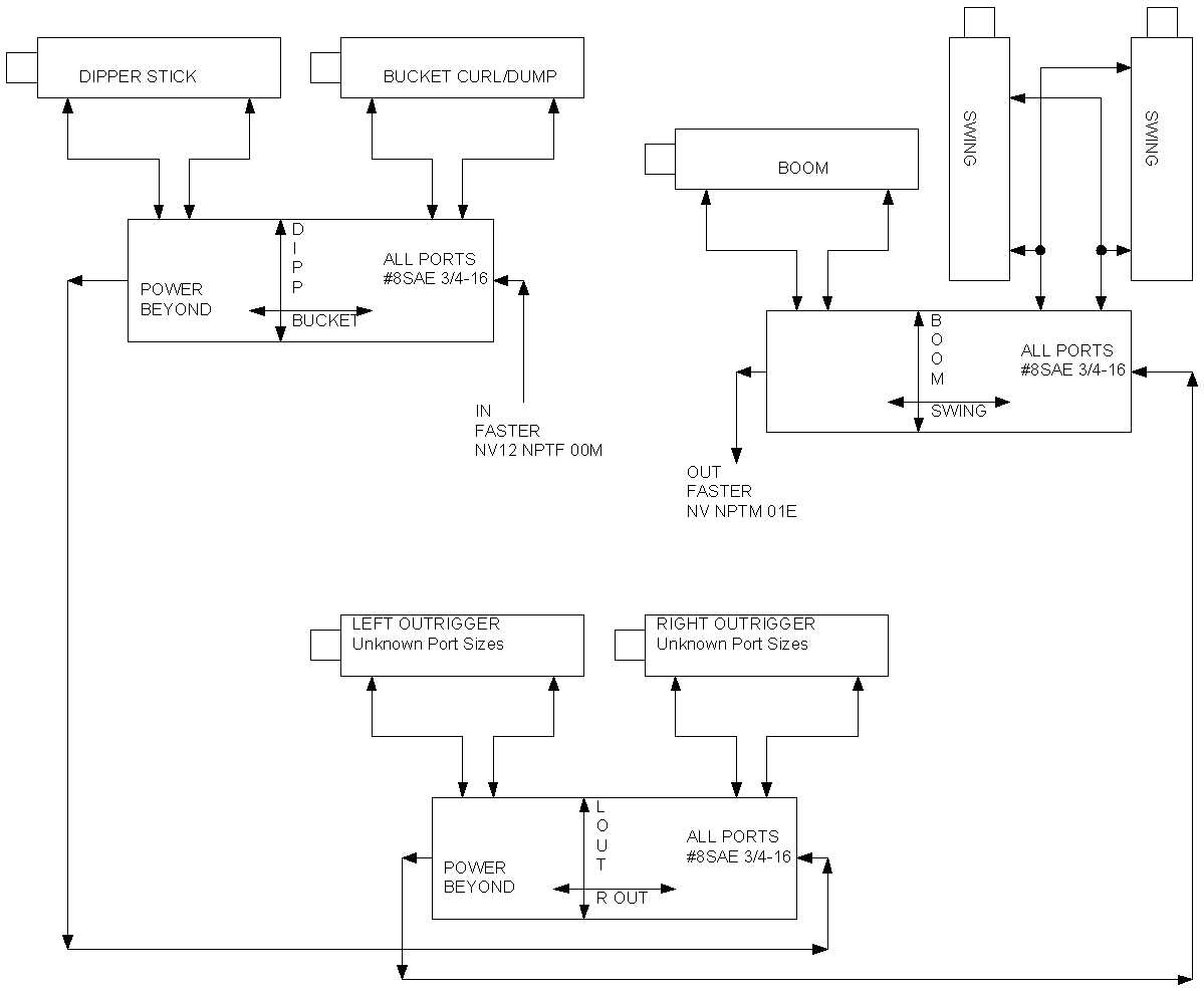

Spent some time going over my hydraulic schematic tonight and checking all the port sizes. It looks like I got lucky and all ports are SAE#8 3/4-16 with the exception of the free cylinders that I am going to use for the swing function. I pulled an adapter that was on one of them and will take it to a local hydraulic shop to figure out what I need to adapt it to SAE#8 3/4-16. It also looks like some sort of restrictor device. I will try it without the restrictor, first just because I can. :) Attached is the hydraulic schematic that I drew up tonight. Anyone interested, please take a look and see if you see any glaring problems. Thanks in advance.

I should note that there are two swing cylinders, working like this...
When one is pushing, the other is pulling and vice versa. I have them Teed together as shown in the schematic with dots.
