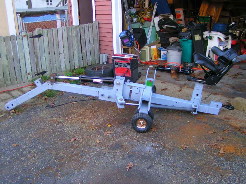

Threw another hour at it the other day. Mounted the boom cylinder.
Running totals:
Time = 47 hrs.
Approximate Cost = $850

   / Build A Backhoe For PT425... It Could Happen
#365
In the up position, once the dipper is installed, I am guessing I will be able to lift well over 6'. Probably closer to 7' and still keep the bucket curled up. In the down position, once the dipper is installed, I know it will be able to dig 6' deep. The boom cylinder still has another 4" of travel and that does not include the depth of the bucket, either. So I'm guessing it will be closer to 8' deep. Not bad. Hopefully I can get back on it this weekend and mount the dipper and start working on the outriggers. :rolleyes:

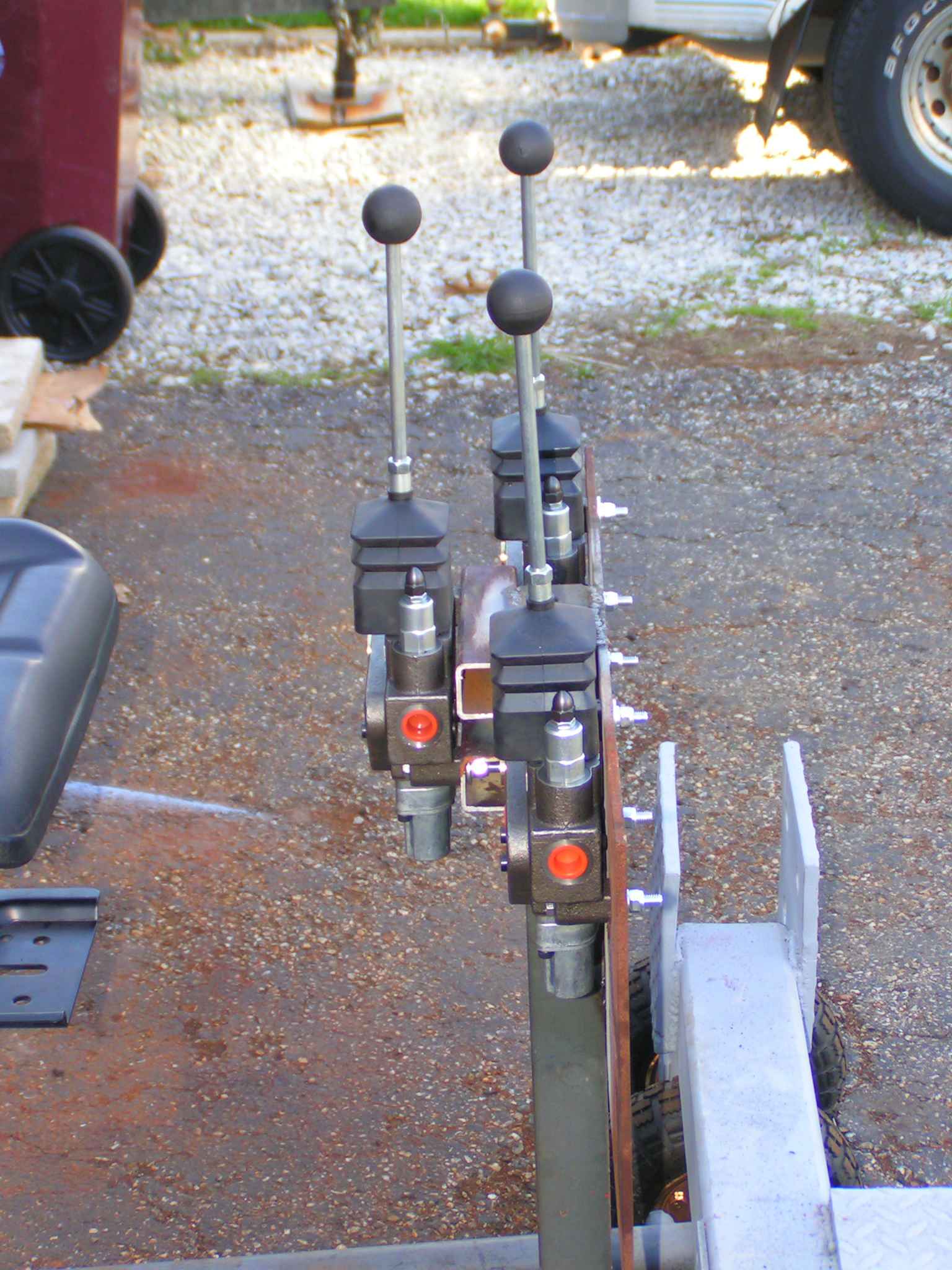

#367
Ordered three, two spool valves with joysticks from Surplus Center yesterday. Due to arrive in a week or so. I also ordered three power beyond plugs, just in case I need them to power stuff down stream. Total was under $700.00.
Plan is to stack them across the front of the operator on a pedestal. Left and right joysticks will control boom swing, depth, dipper extension and bucket curl. The center joystick will control the left and right outriggers and I will add a manual diverter valve to allow it to control a powered thumb. I don't want to use an electric diverter valve so I don't have to run DC to the attachment.
The reason I chose the valves with joysticks already attached is that assembling a stacked valve, then adding joysticks to it, like the prince valves, turned out to be more expensive to get all the features that the valves I ordered already had.

   / Build A Backhoe For PT425... It Could Happen #368
Thanks for the update, MR. I was wondering when you'd get back to this -- or if if was going to turn into another "grapple bucket" project... :p :D :D
Did you get straight or angled shafts on the joysticks? Just wondering, as to how the operator position and the mounting of the valves would be considered. It seems that short, straight shafts would be the better alternative for the operator...

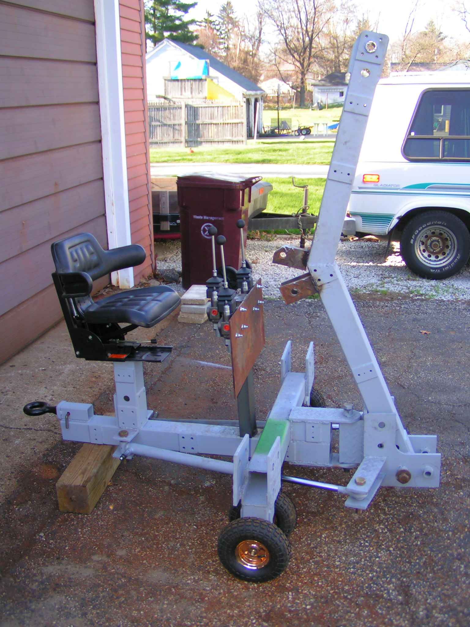

#370
My valves with joysticks arrived this week and I was able to mount them today. Here are some pictures. All I need to do now is plumb them, make sure everything works correctly, add the floor, the outrigger pads, a bucket and linkage, then disassemble everything and paint it.
