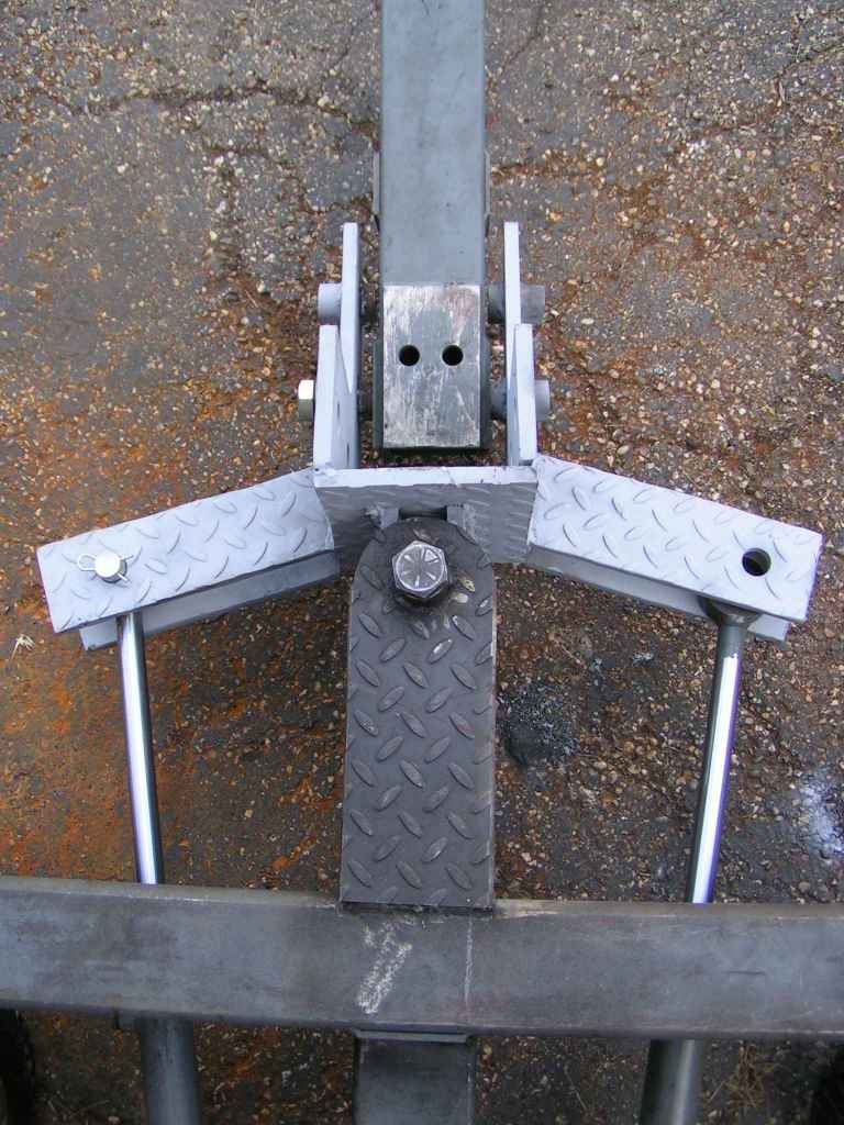

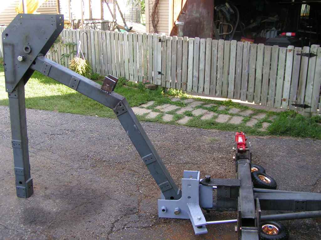

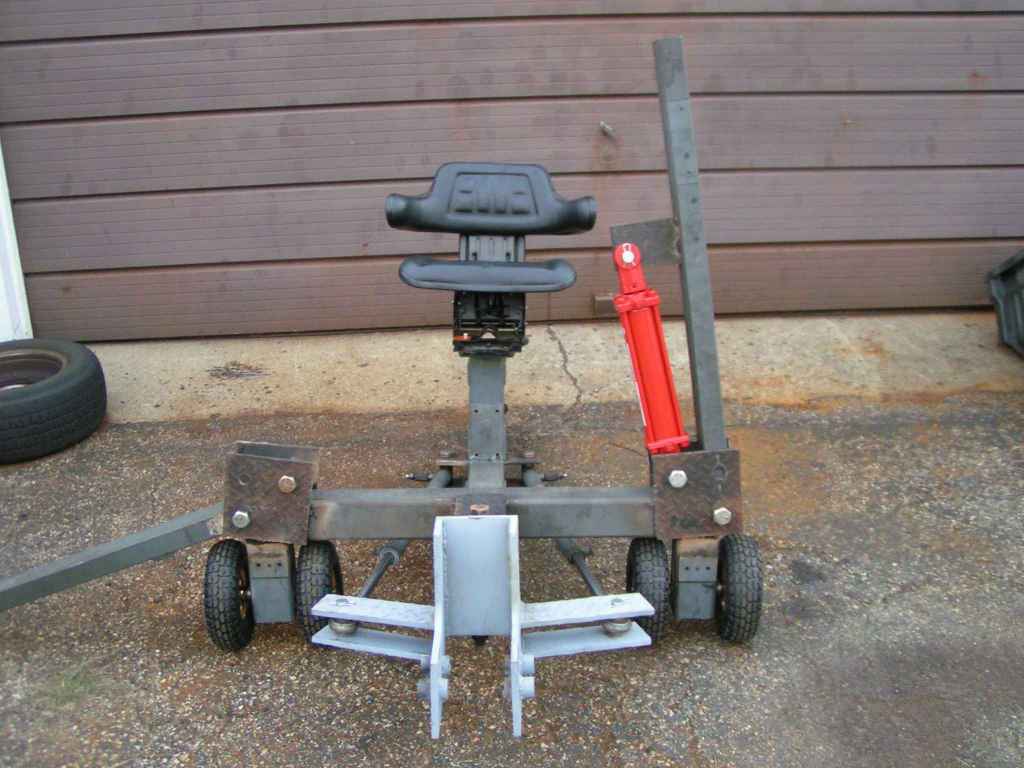

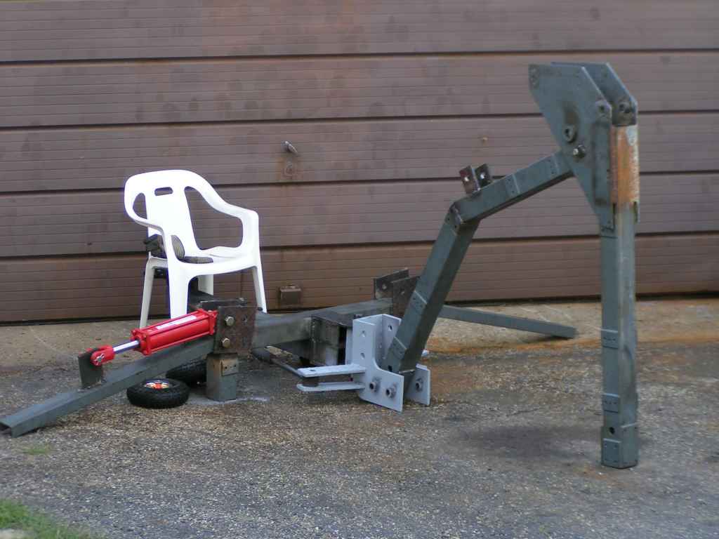

Here's a few pictures of this weekend's progress.
This is how it is working out... fine! :)
1st picture is an overall view from the front right side.
2nd picture is a side view with the boom curled up a bit. Note that much of those brackets at the joint between the boom and dipper stick will get cut off and discarded after final fit up and tests.
3rd picture shows the maximum swing to the right side. The left is the same. It is a tad over 120 degrees. Not too bad.
4th picture is a view of what will be under the operator. Shows the swing cylinders that will be covered by 1/4" diamond plate flooring.
5th picture shows the pivot assembly.
When I have the boom fully extended and step on the tow ring, the unit will tip the balance to the rear of the unit. This is good, because I will still have to add the floor plate, seat and hydraulic controls to the rear of the unit and the bucket and cylinders to the front. It is just about neutral. Once I put my butt in the seat and attach it to the tractor, I should have plenty of counterweight for full out reaches.
Also notice the 8" wheels under the unit. They will be attached to those legs sticking down from the main cross member. There will be a total of 4 wheels. They are rated at 300# each, and four of them should allow me to roll across the terrain fairly easily when the outriggers are up. They will lift off the ground as the outriggers are lowered.

David, from looking at the pictures, and you mentioning about 120 degrees of swing, I would think the front swing tabs should point more forward than aft. At the current angle, you can never get the 180 degrees of swing. It may require moving the back tabs out. I am having the same problem trying to find the right geomerty. I may use a curved front tab.

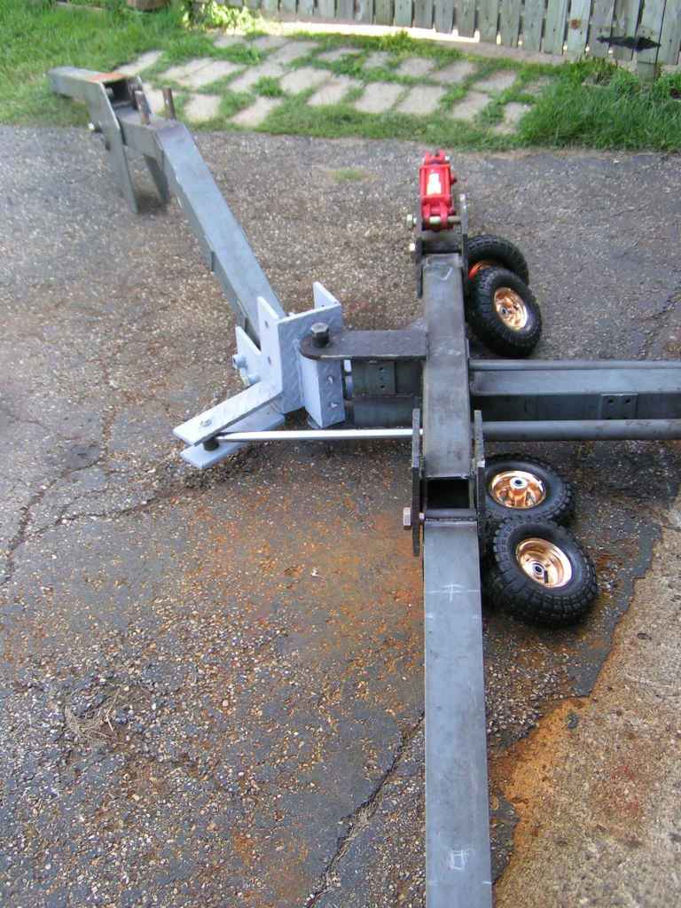

I put the wheels on it last night. Man, that is a lot easier to roll than carry!!! :D
As suspected, when I extended the arm all the way out, the tail lifted off the ground. I stepped on the tail and it easily came down, so there is a very good balance there. I need to put a grease zerk in each wheel. I just used 5/8" bolts tacked to the leg stands for axles. Four of them make it roll pretty easy. Now I need to get the floor installed so I can plan out where I want my hydraulic controls. Then figure out the seating location.

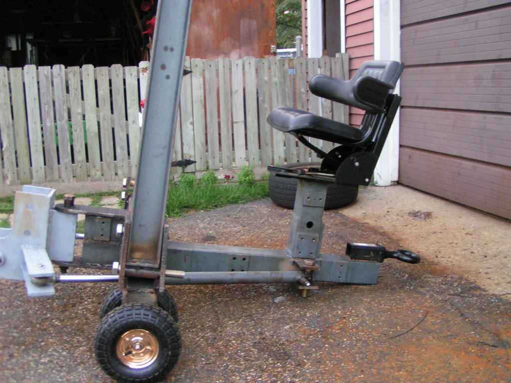

Picked up a seat at Rural King yesterday. $69.00 for a suspension seat. Not bad. Tacked it on. Feels nice.:)
Running totals:
Time = 43 hrs.
Approximate Cost = $520
