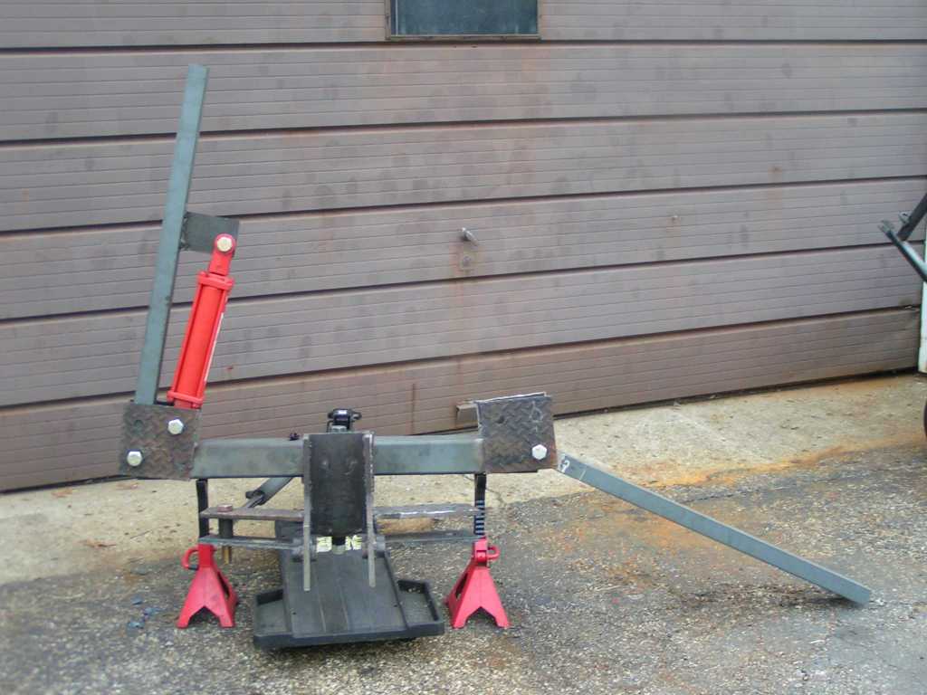

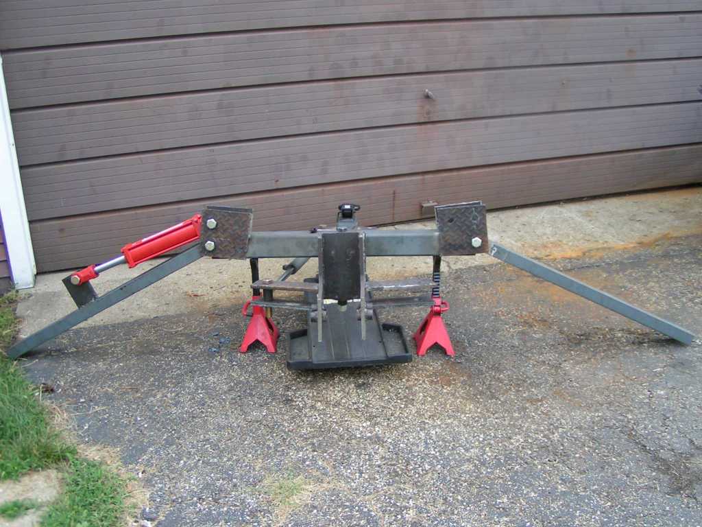

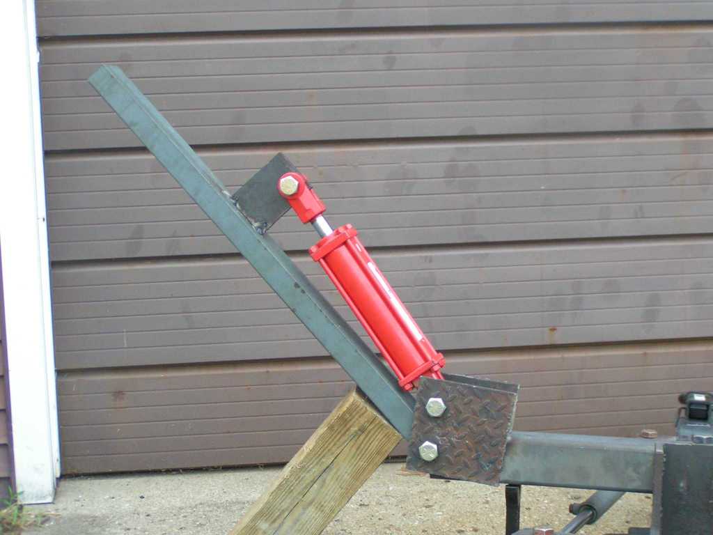

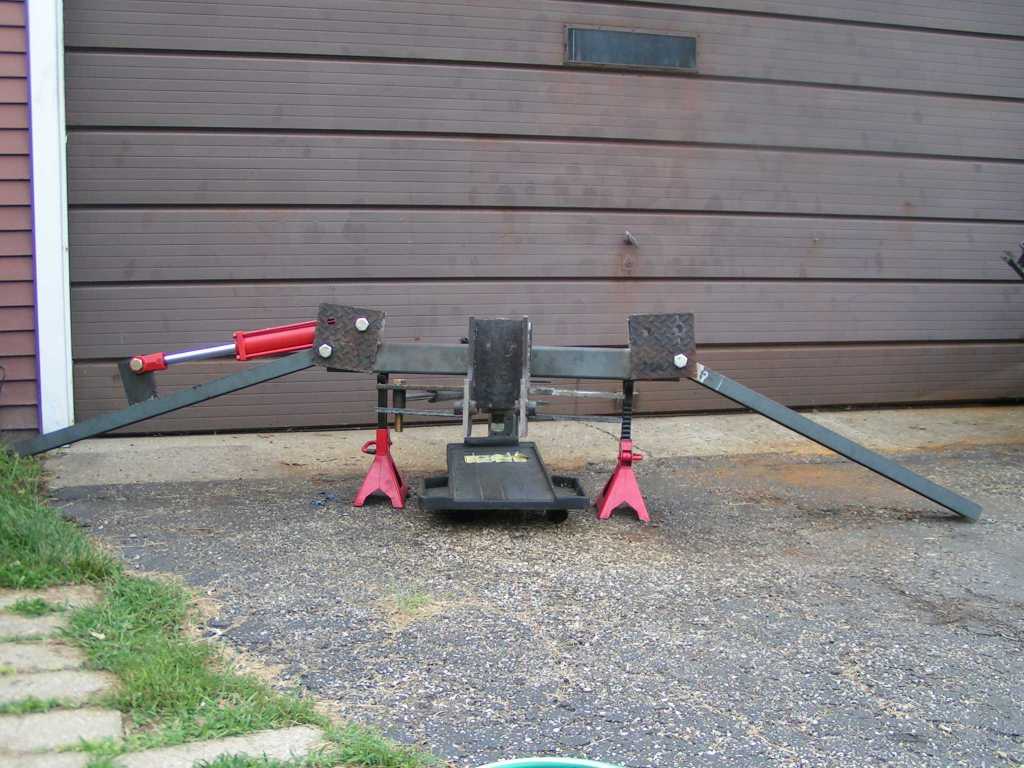

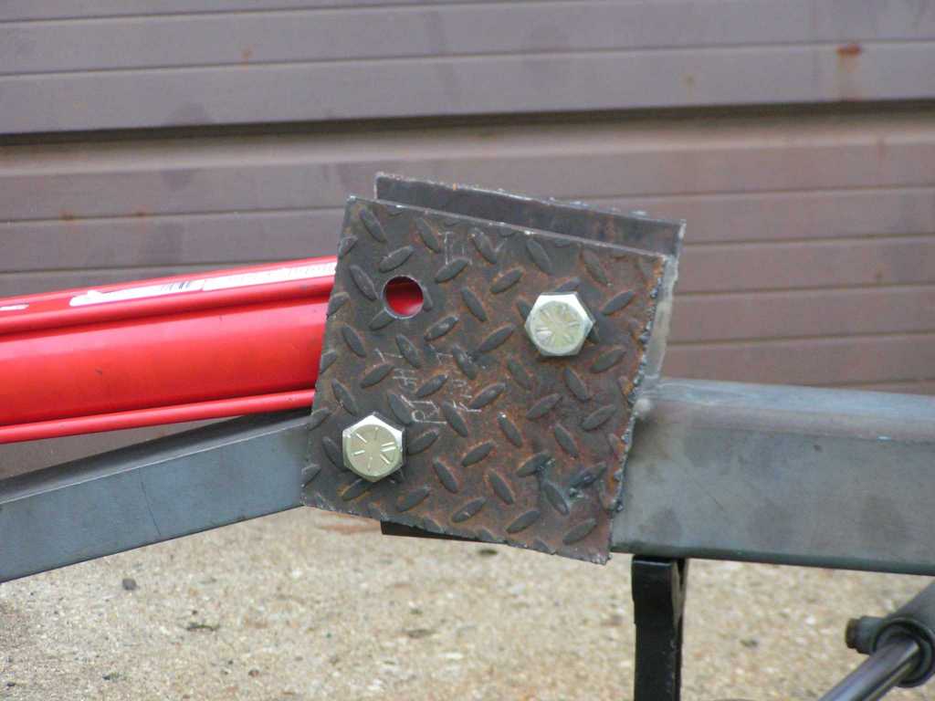

We have outriggers! :) Well, almost. I need to get some more steel stock but these pictures show the idea.
1st picture is of the outriggers in what will be the normal mode of operation. Nice spread, feels sturdy. Looks like it will lift the unit about 14-16" off the ground.
2nd picture shows the bolt/pin configuration. Note the position of the cylinder pin in the top, inboard holes in the brackets. In this position, I get normal swing down and the outriggers will stand up verticle for transportation(see next picture and make note of the empty pin hole on the top, outboard hole).
3rd picture shows the outrigger in the vertical position when the pin is in the inboard hole in the brackets.
4th picture shows the cylinder pin moved to the outboard hole in the brackets. In this position, I can get way below level with the outrigger. I couldn't lift the jackstands high enough to show the final depth that the outriggers can go. I think it will be able to lift the unit about 2' off the ground in this position.
5th picture shows the problem with the cylinder pin in this position... they cannot be lifted high enough to get through tight spaces. There really was no altenative with the way I made it. So, I will just slip the pin out and move it to the outboard holes in the brackets if I need to go way beyond normal horizontal depth. I just couldn't figure out how to make it go vertical for transport AND be able to swing way past horozontal without actually bending the outriggers like the boom is bent. I will try it this way and see how well it does. If it isn't sufficient, I will cut the lst 18" off the outriggers and angle them downward. That would solve it, for sure. :cool:
Running totals:
Time = 38 hrs.
Approximate Cost = $420

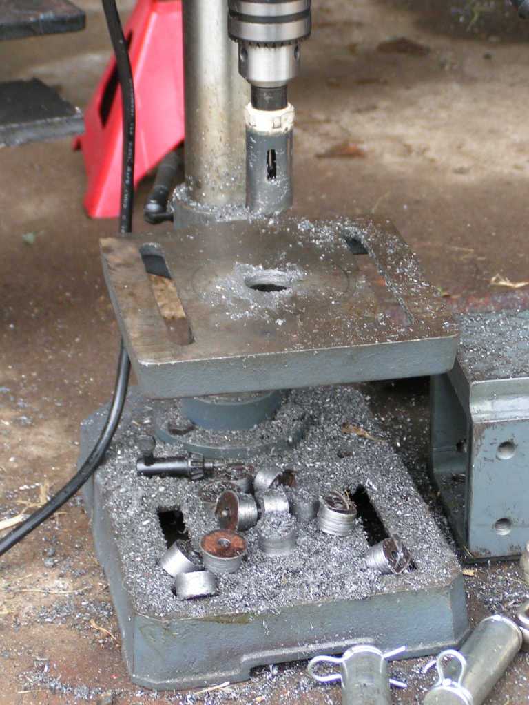

By the way... the 1" bi-metal holes saws work really well! :D
