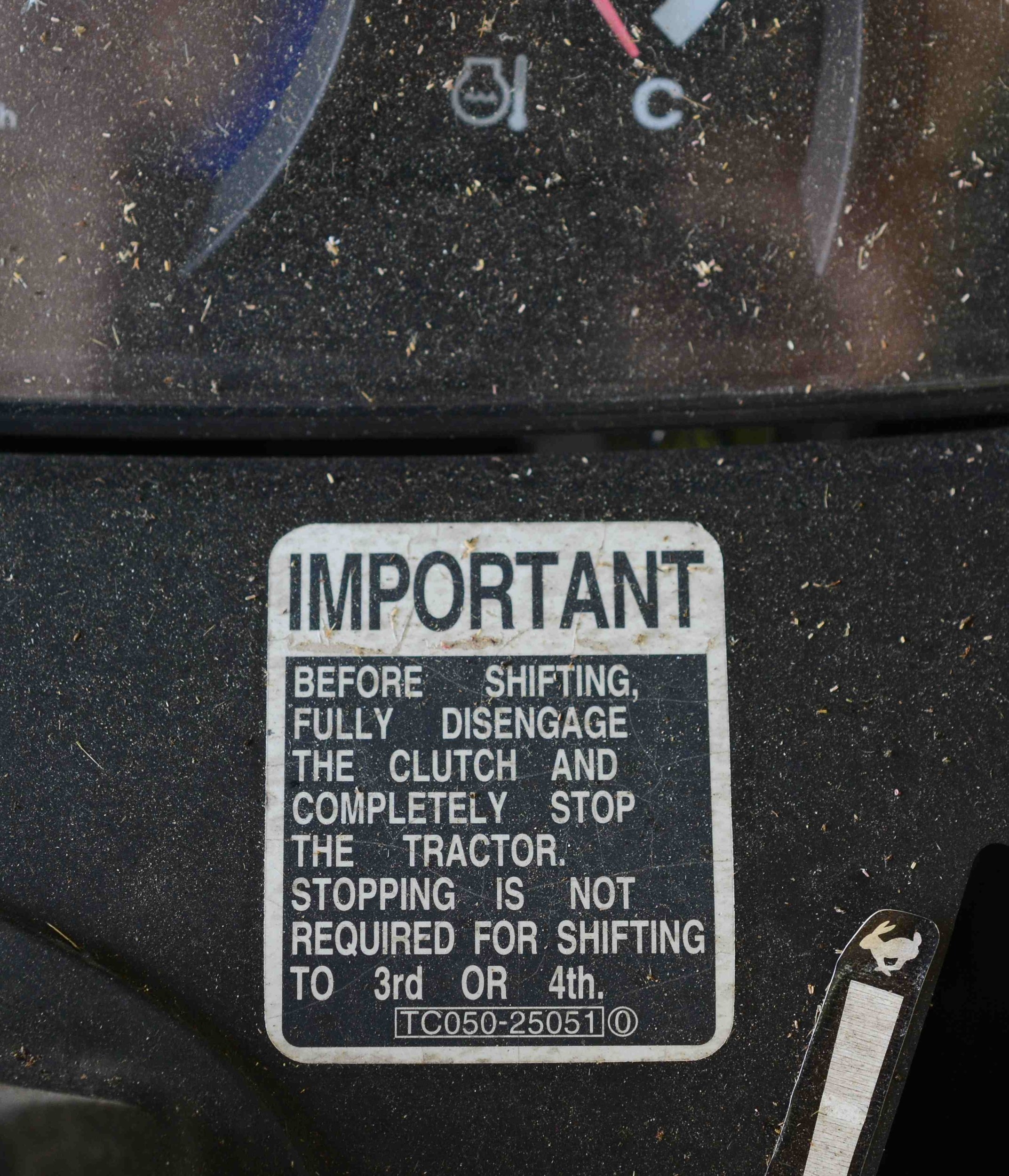

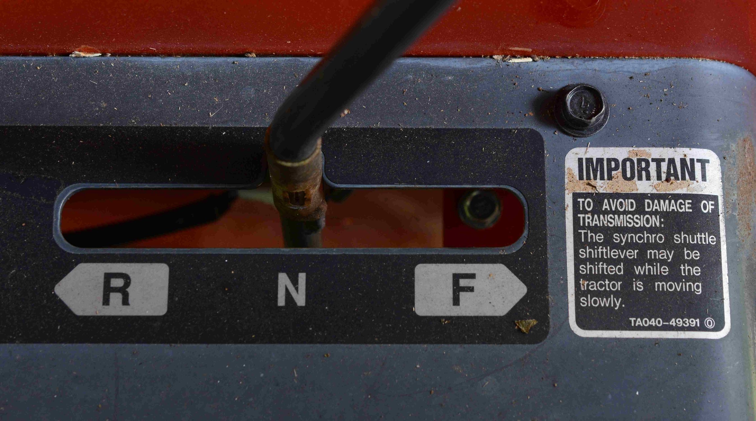

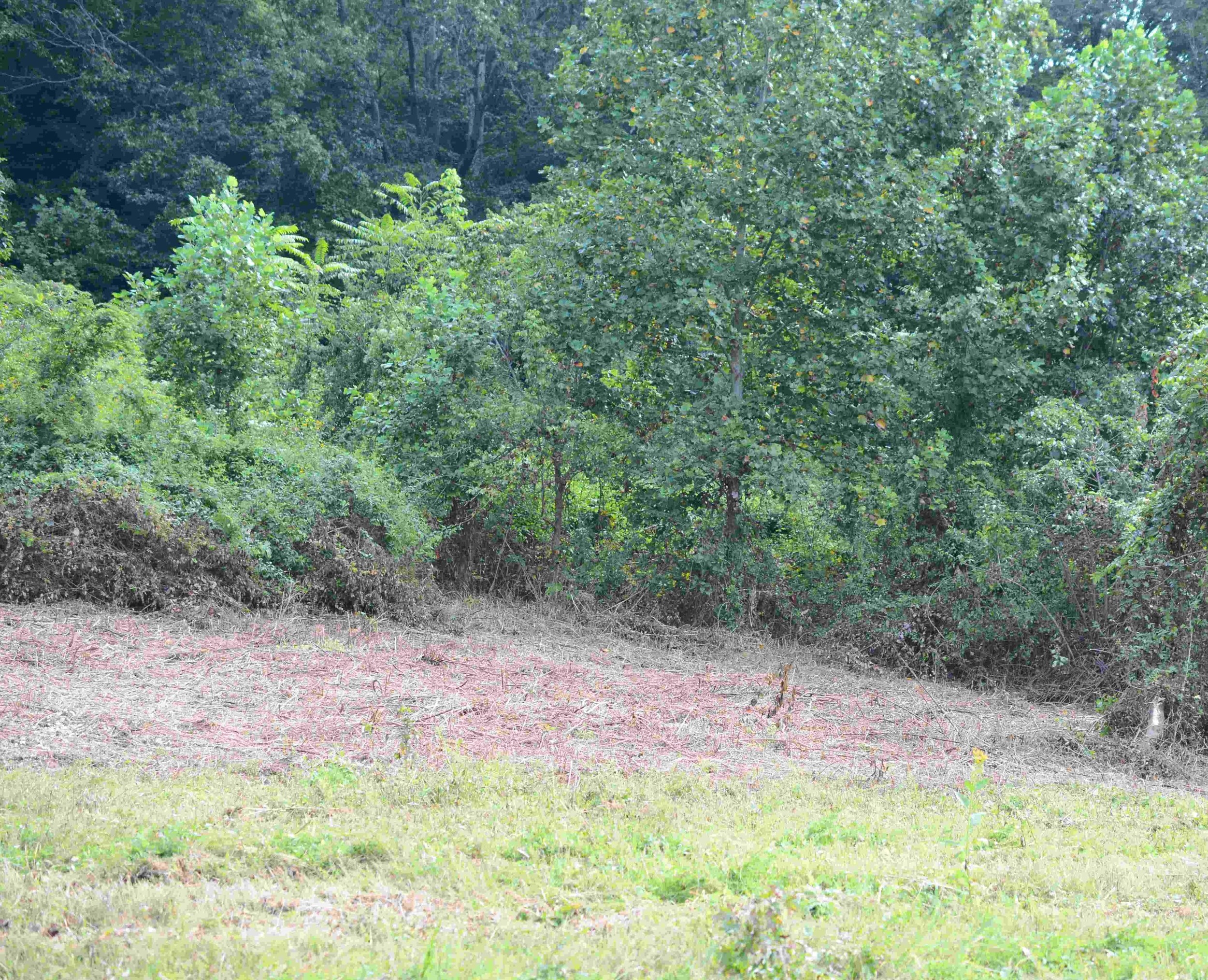

My Mx5200 has these two labels. I frequently need to shift between forward and reverse to cut ditch banks or overground hillsides like this one with 7-8' vegetation. I'd rather cut it backing up.
What's the proper procedure for me to follow assuming I'm going to stay in the same gear and same range? Stop, lower RPM, depress clutch, make the shift between F-R? Or does this transmission allow me to keep the RPM up while making the shift between F-R?

Forgot that Kubota cheaped out on some models and didn't put synchros on all gears, that's why they say you can only shift from 3rd to 4th on the move.
When I have to do the job you describe, I just use the foot throttle. I go backwards mowing, at the edge of the embankment, I take the foot of the throttle, press the clutch, move the shuttle lever forward, release the clutch, relocate the tractor for the next pass and then same process to reverse and go back mowing. I don't change gears, just change from backward to forward and vice versa.
This way, it should save your clutch a little bit more. Although, I've set the hand throttle before and leave it there all the time while changing directions. Since it's usually in low gears, there isn't much load that could hurt the clutch as long as you're not slipping it in high RPMs.
When I'm tilling the orchards, the trees are in a rectangular pattern and takes about 3 passes per row and I usually run 2nd or 3rd gear in Low range. I do one pass, at the end, lift the tiller, move the shuttle to reverse, range gear to Medium range and back for the next pass.
