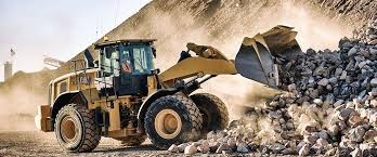

Real loaders are very seldom Hydrostatic they are often shuttle shifted and torque converter equipped pieces of equipment,
Many are articulated or rear steer so they turn sharply without tearing up the ground.
They don't get belly hung in just a few inchs of mud or swamp.

Comparing a full size wheel loader to a skid steer is about the equivalent of comparing a 1/2 ton pickup to a semi. The wheel loader price tag is several times what a skid steer cost, you can’t load the wheel loader behind a pickup and move it fairly easily, you can’t grade a yard with the wheel loader, you can’t drive the loader in the woods to haul out firewood, the attachments for a loader are pretty limited where the skid steer has hundreds. Overall they’re a completely different tool for different uses. One of my friends had a compact wheel loader. It was light enough to transport with a pickup and used skid steer implements which put them in more comparable classes but it still couldn’t do dirt work anything close to as good as the skid steer can. The leading reason why he sold it is the stability was terrible on uneven ground. A skid steer is hard to work on I’ll give you that but the durability is pretty good considering the poor treatment they typically receive. A tractor would be broke in half the first week if it received the same treatment.

Well, it's more like comparing a Ford Ranger to an F250. A JD544 is roughly 150 hp and around $225k; while a JD 333 is 100hp, and around $115k.
Edit: They both there use, and place. I would want a CTL loading trucks, or where you might need to move material more then a few 100 yards; at the same time, I would want the 544 doing a house pad or landscaping.

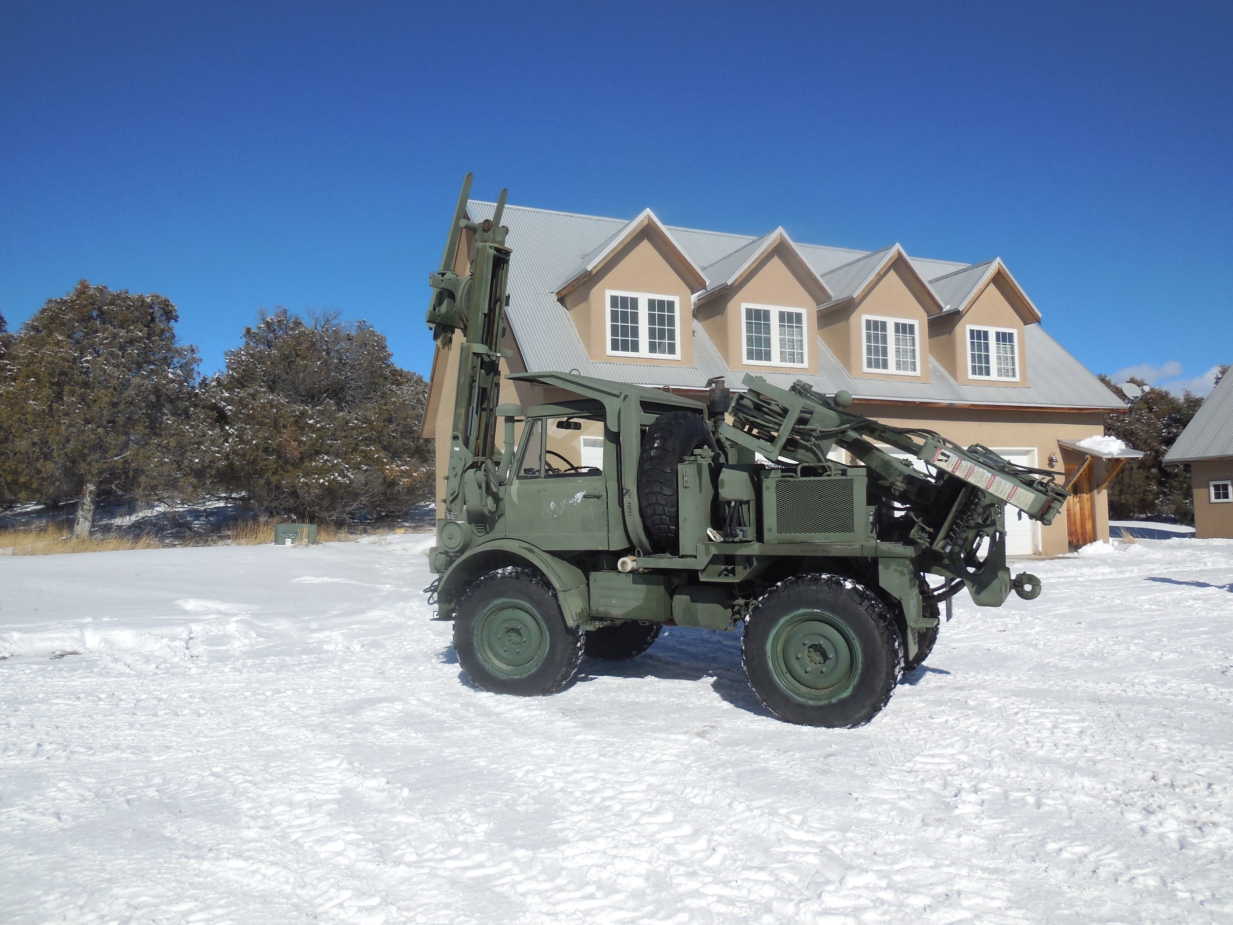

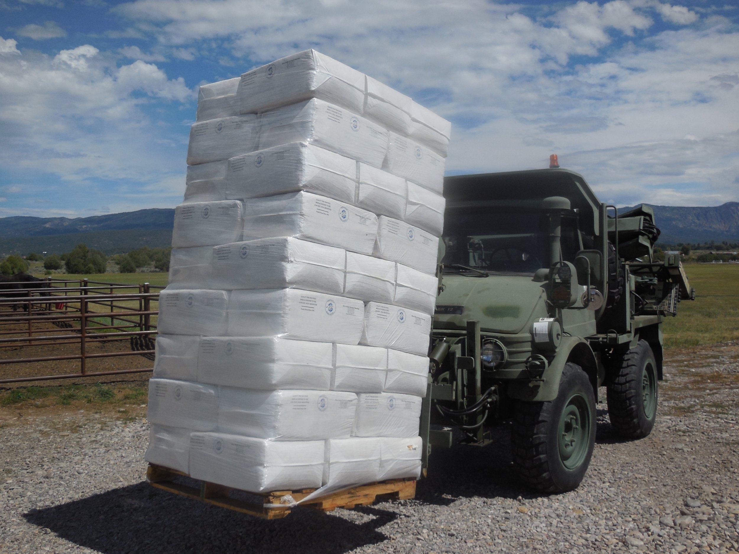

I should probably point out that my forklift isn't of the typical kind.
It doesn't have A/C, which doesn't matter to me as much as that the windshield is heated, visibility isn't great, but it does quite well on uneven terrain. As does most Unimogs.
Also, no side-shift, no power adjusting fork width, or laser. But it does have a side tilt function which the tractors with pallet forks are obviously lacking. And it's easier to transport some loads since they are supported by the forklift in the back.
Still haven't got around to check how high it lifts compared to the M6040, although this photo should give an idea.

A 544 is a pretty small loader. They come way bigger. I’d rather have even a small dozer over a loader for building a pad. Loading trucks is where a loader shines. The 544 bucket is 3 times bigger at least.
