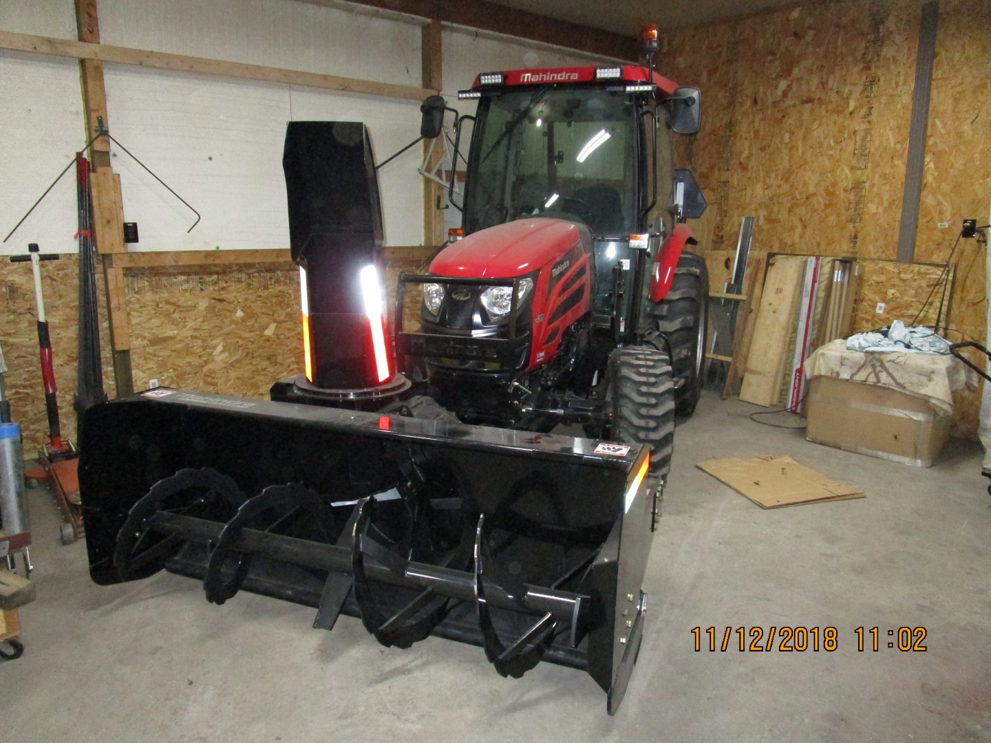

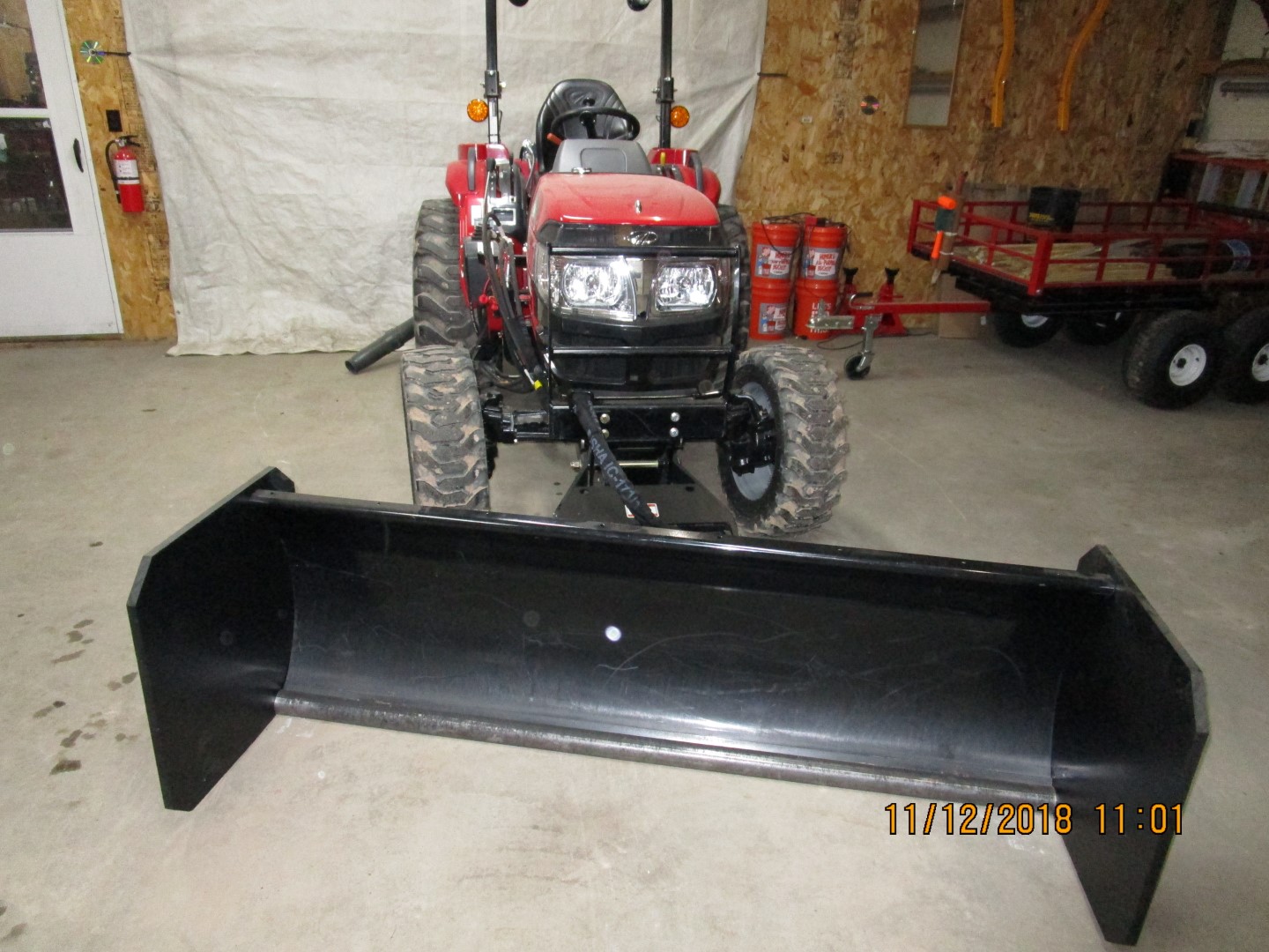

Front blade on small tractor with added 3/4" plastic wings for pushing snow. Works for prep'n drive for big snow blower. Build up a little cover for the Afton stone drive. Split 2" steel pipe on cutting edge of both. If you just go with plowing the snow with a blade, make sure you start the season by pushing the drive wide enough to store all the snow thru out the winter. It will quickly close in on you if you get a bad winter.
