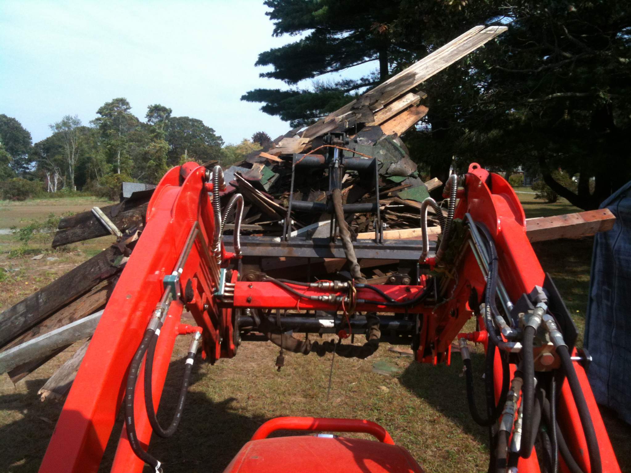

Do you have a picture of your hose setup? Are you using a fixed mount on your loader center post? I'm just trying to get some ideas on what might work best.
Here is a photo that shows the hoses connecting on the torque tube cover. There is a welded bulkhead that the tractor side hoses are mounted to. The grapple side hoses are usually loosely contained by a bungee but I don't see it in this photo. Also, this photo was apparently taken before I put a protective sleeve over the grapple lines.

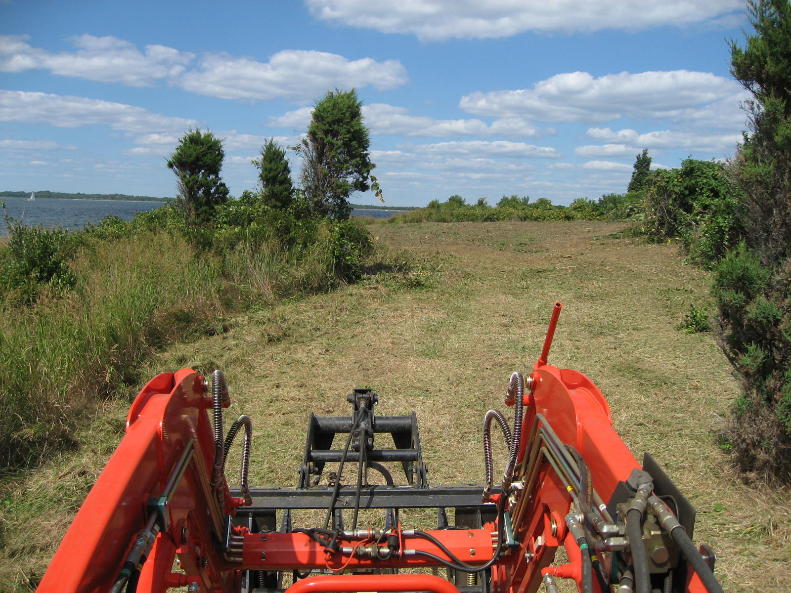

Sorry, having trouble posting photos today. The grapple side hoses are usually loosely contained by a bungee which can be seen if you look closely under the torque tube of the second photo(there is a zip tie on the protective sheath the bungee hooks into).

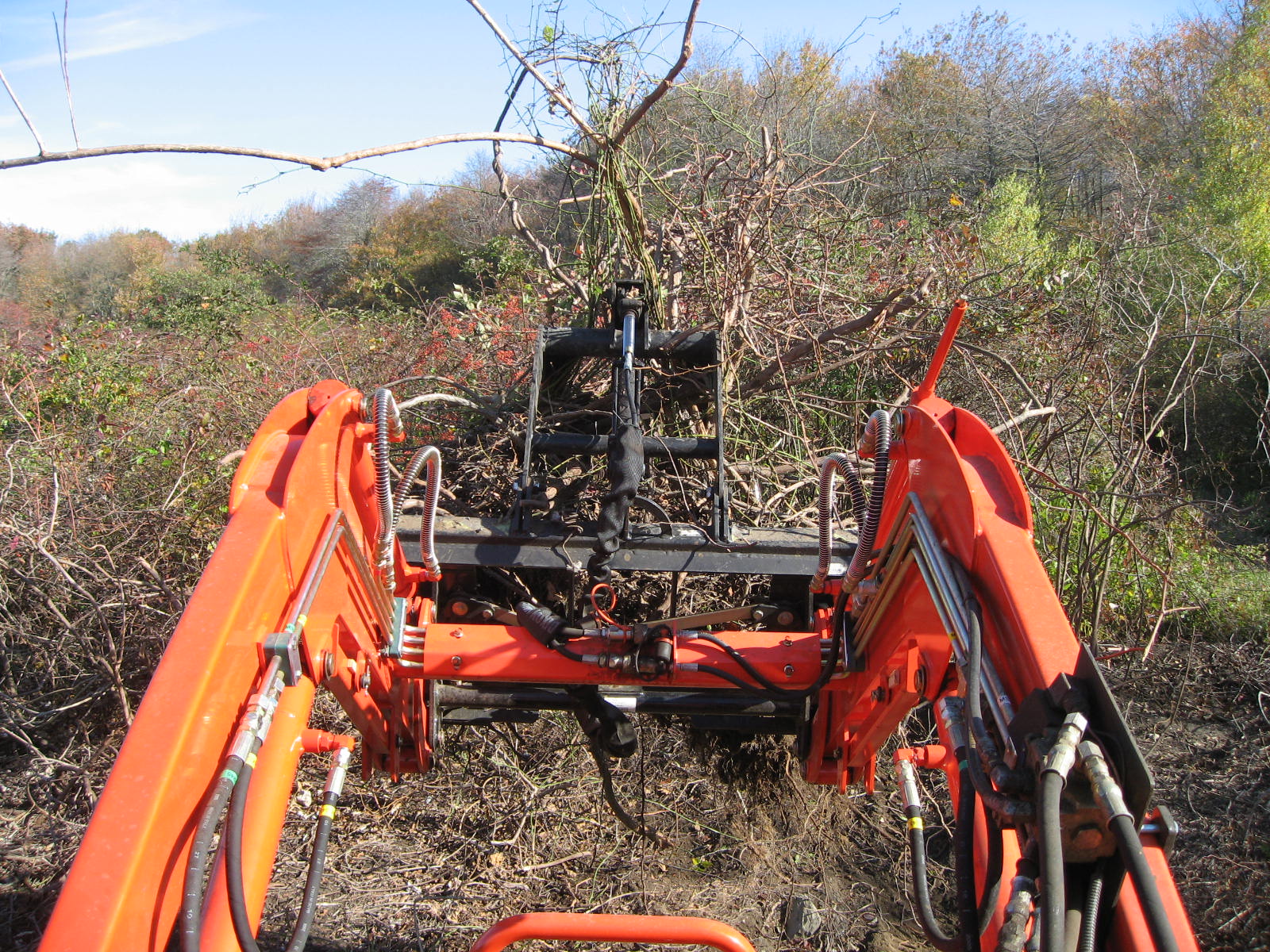

Well, to much my disappointment, the 4n1 didn't hook up as can be seen from the pictures. The good news is that the cylinders are working just fine and there are no apparent leaks. I hope to take Friday off and get the torch out to widen the slots for the pins to go into. I'm assuming this is fairly straightforward, just cut out the slots so the pins will fit... Anybody have any thoughts on things I need to take into consideration or any pointers that might make this adjustment go smoother. -------
Yep, just cut the slots wider.
