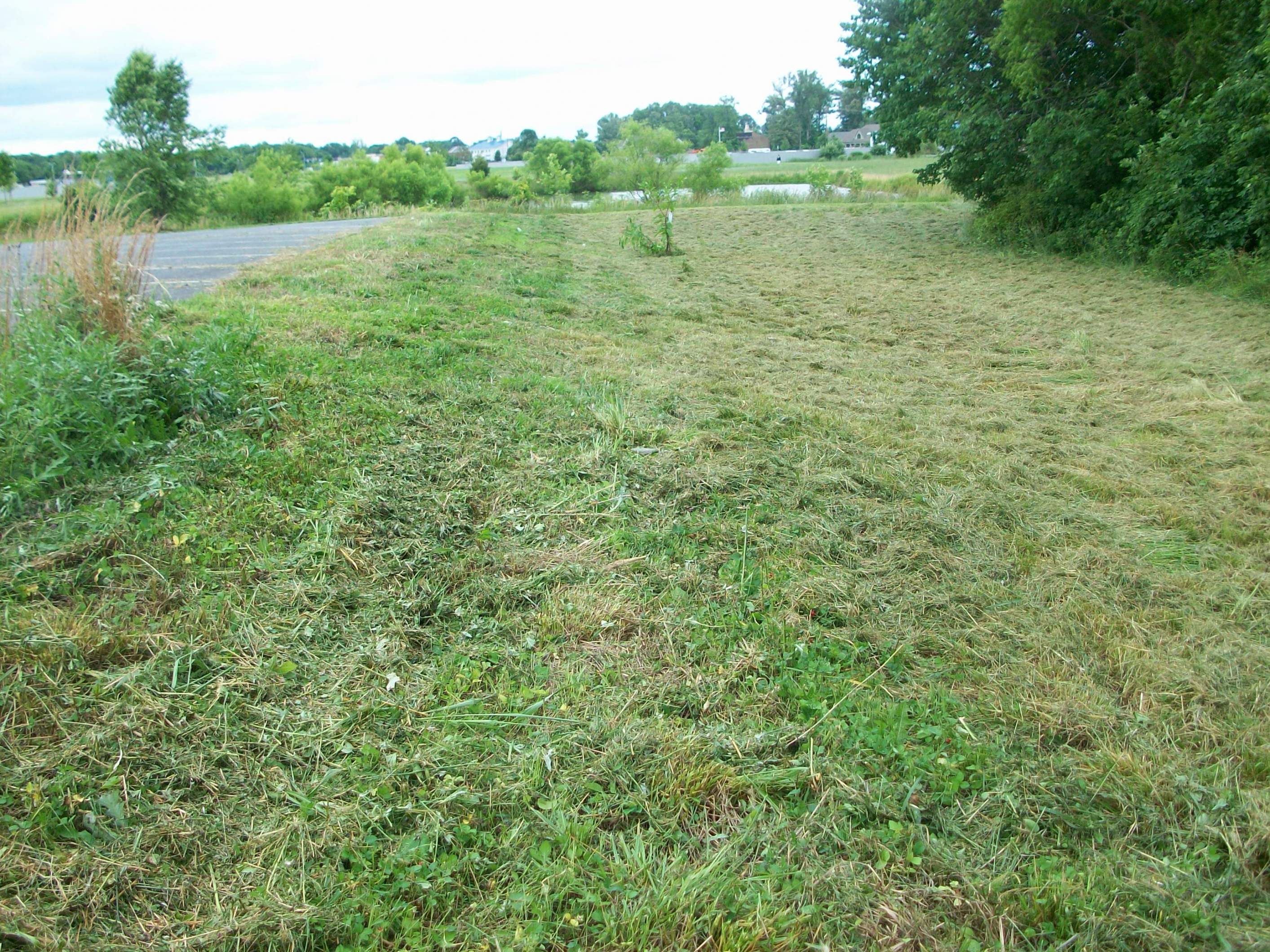

I agree its a great idea to run the bucket low to find any hidden obstacles/hazzards. It's a monthly job and I've already cut this one area twice with the bucket on so I feel comfortable with the condition of the field.
Its more of a trailer issue than anything else. I can fit it all on the trailer now as the pic below shows but I can't balance the laod. I thought about getting a longer trailer but to get one because of just one implement doesn't make much sense.
Roy's suggestion of suitcase weights have got me thinking and I'm leaning towards that. Gonna do some more research on it.
Also a pic of the slope I'm cutting on the two acre lot, the reason I still want weight on the front.

I think you are fine with just the tractor and the RC cutter. If it were an MX5
or an RC72 I would be more concerned. nice setup :)
/ Bucket off with bushhog attached #19
After seeing your photos I would not be concerned with cutting that with the bucket off and no weight. With the hog down in cutting position it should not be an issue at all. Nice looking setup!
Is the trailer currently nose heavy or tail heavy? Have you tried backing the tractor onto the trailer?
