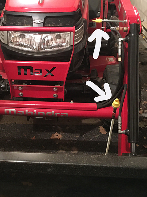

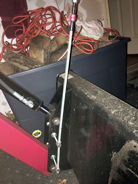

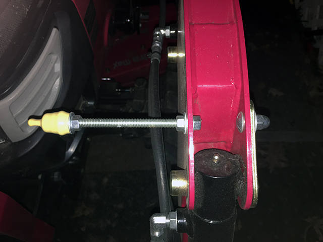

Do any of you guys use that thing?
I got one on my tractor but it seems to be kind of unhelpful. I think I do better just looking at the load.
I use it often, mostly to adjust the curl of the bucket/forks before (or while) lowering the boom to the ground so ready to do work.
I've been using it since new (21 years now) and am not a "newbie" by any stretch.
Approaching a pallet with the forks, they are ready to engage the pallet before lowering the boom. Wouldn't be without the leveling rod.
I filed a groove at the "level" spot on the rod and put some white paint in that groove so it is more visible and doesn't get worn off.
But don't use it if it is not helpful.
/ bucket level indicator #104
I find it useful for getting the bucket just so for scraping flat. The indicator on my tractor has a bit of a hoop at level; no paint to look for.
Useless as-is for forks of course because they're attached at a different angle. I need to put paint on it for that, but I usually just stand up and watch carefully while I maneuver with forks.
