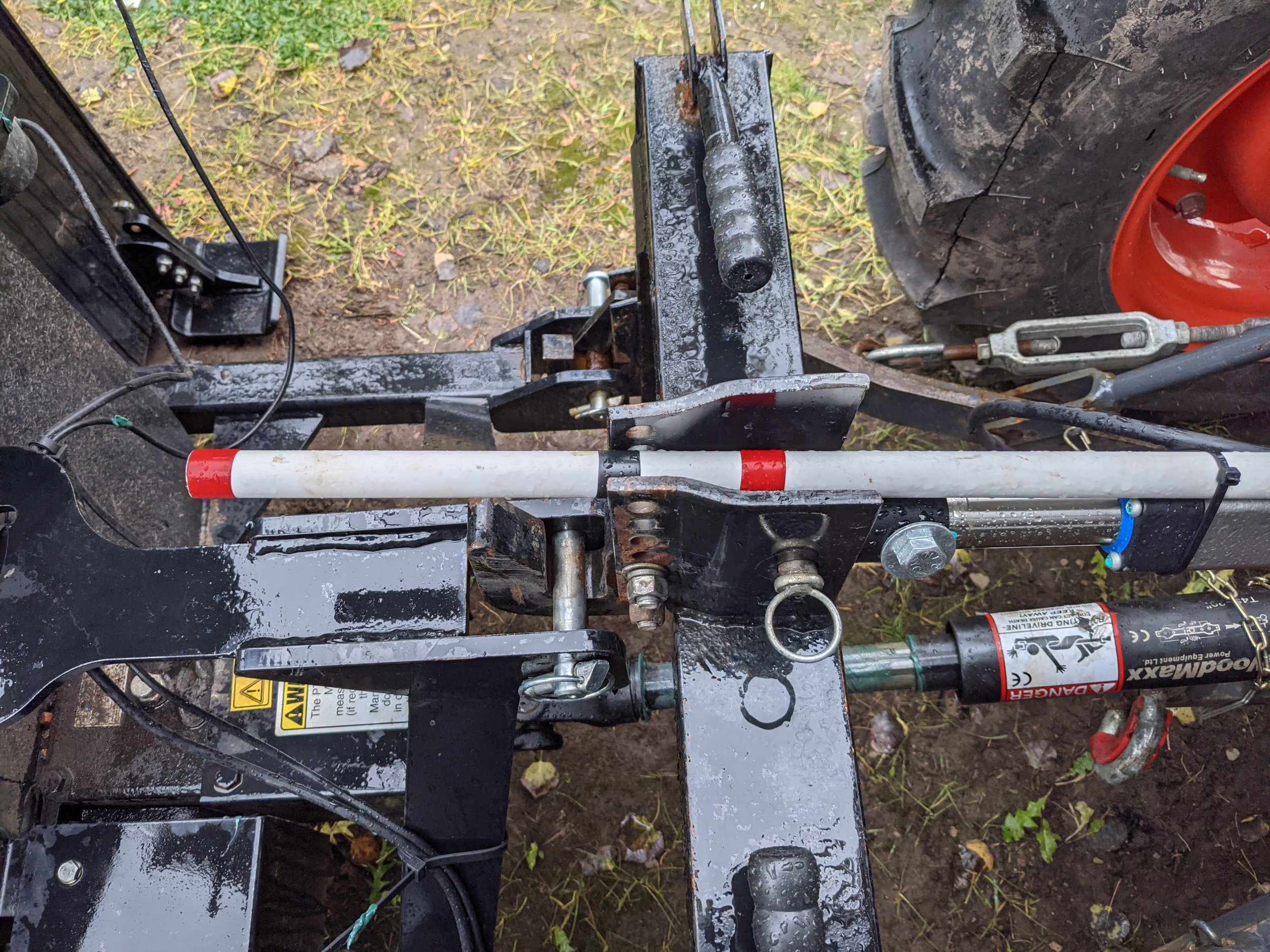

These are what I use
Hey, repete, can I beg you to explain what I'm looking at here? Is it just a label on a right angle bracket on the top of your bucket? How does that indicate bucket level? What happens differently between slight dump and slight curl positions?

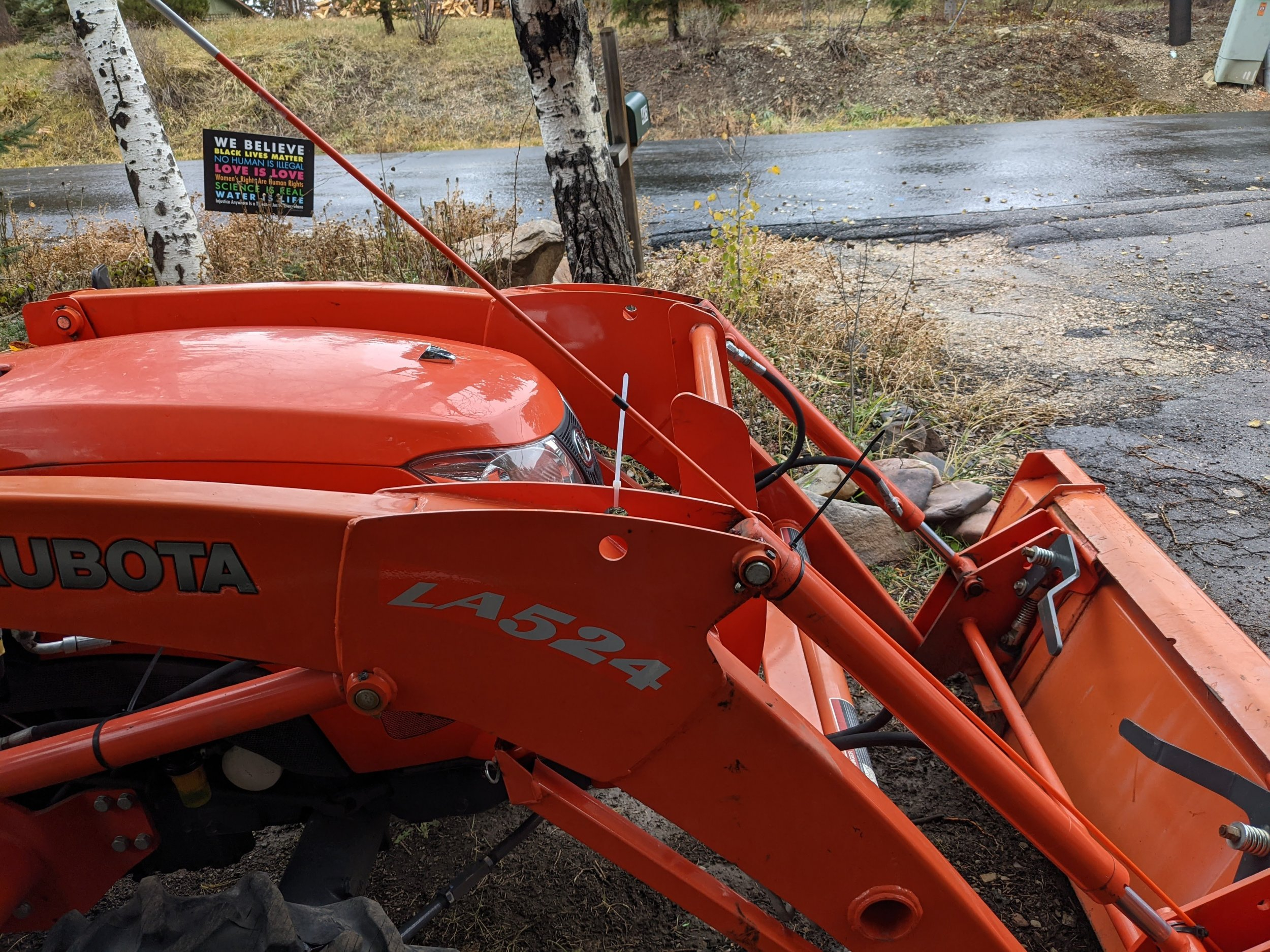

I was on my 3rd compact tractor before really ever using my bucket level indicator. I modified mine in my 4066R and put a bend in the rod so that when adjusted correctly falls into then guide rod bracket when the bucket is level. Easier to see than describe. (Pic attached). Kudos to those that can do a really good job of grading with a tractor, especially a newer one. It’s hard, especially when compared to doing the same with a compact track loader. You absolutely cannot see anything on my 4066R. You need some point of reference to know when the bucket is level.
The top of the angle bracket is parallel with the bottom of the bucket. No matter the height you raise the loader arms the bracket is still reflective of the levelness of the bucket. The rods to me only indicate level if the bucket is on the ground.
When I remove items off say a shelf located 4' off the ground then the rod becomes ineffective, yet the angle bracket is still in reference to the bottom of the bucket. If the angle bracket top is on the same plane as the ground your bucket is level. To test this, if you use the rod set the loader flat on the ground and see where the rod is indicated. Now raise the loader 4' and see where the rod is when your loader is again adjusted to be parallel to the ground.
This is sort of a "to each his own" thing but I just find the visual level bracket always accurate regardless of the loader arm position. My method simply works for me and there is no right or wrong thing.

After seeing some of the pictures of "factory" bucket level indicators its obvious some of the person engineering them has never been on a tractor or used one....
IF one has to know exactly the angle of bucket is in relation to plane of tractor, this one is interesting...
Might be my winter project when its to nasty to go outside of shop...
