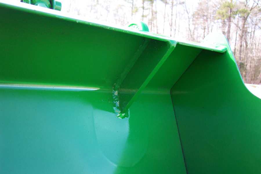

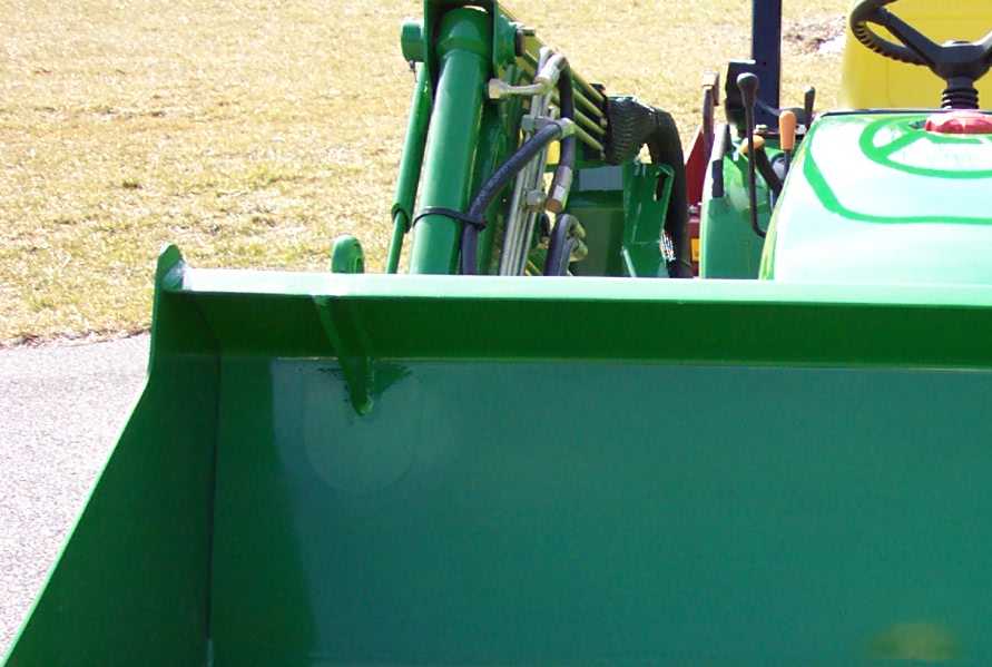

Someone here posted a picture a while back of how they welded a couple hooks on the back of his bucket, and that looked like it could be real useful. I may try that myself, as it would be easy to hook a chain to grab hooks back there when running the chain around something and under the bucket, which I am sure we all have reason to do on occasion.

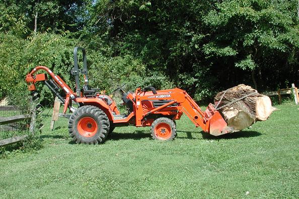

Hey, Henro...
Your 'Bota's got something stuck in its teeth... /forums/images/graemlins/shocked.gif
