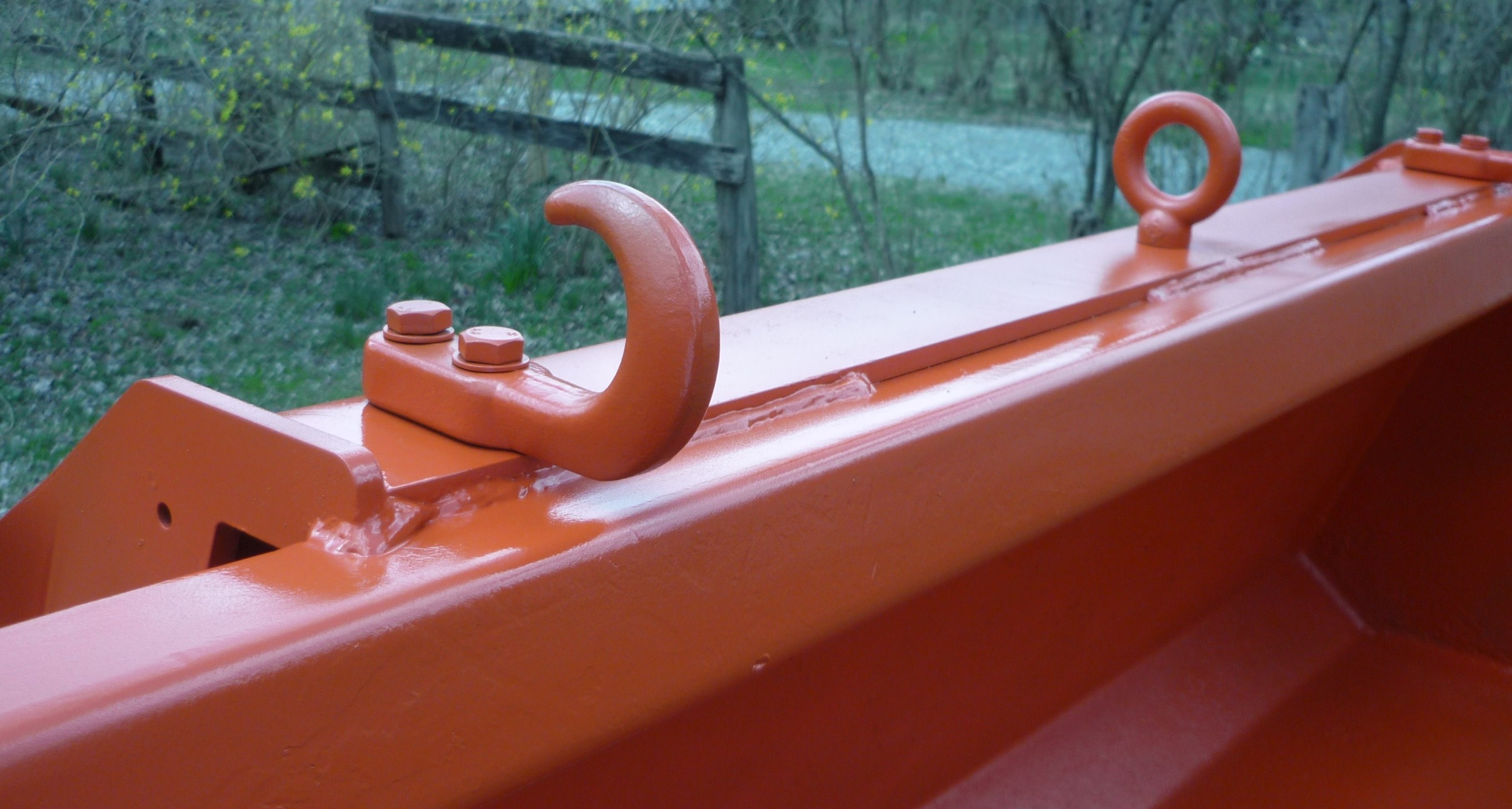

A piece of angle iron with a slot in it will allow the chain to go over the front or back. :thumbsup:
Ken needs to make "Bolt On Chain slots" :D
I have hooks, BOCS and a receiver tube. By far the most useful is the receiver tube.
If I had to do it all over again, I wouldn't mess with hooks or the BOCS, I would just weld 2-4 stake pockets to the top of my bucket. Can be hooked from either end and you can pull the chain through and tie it off at any length.

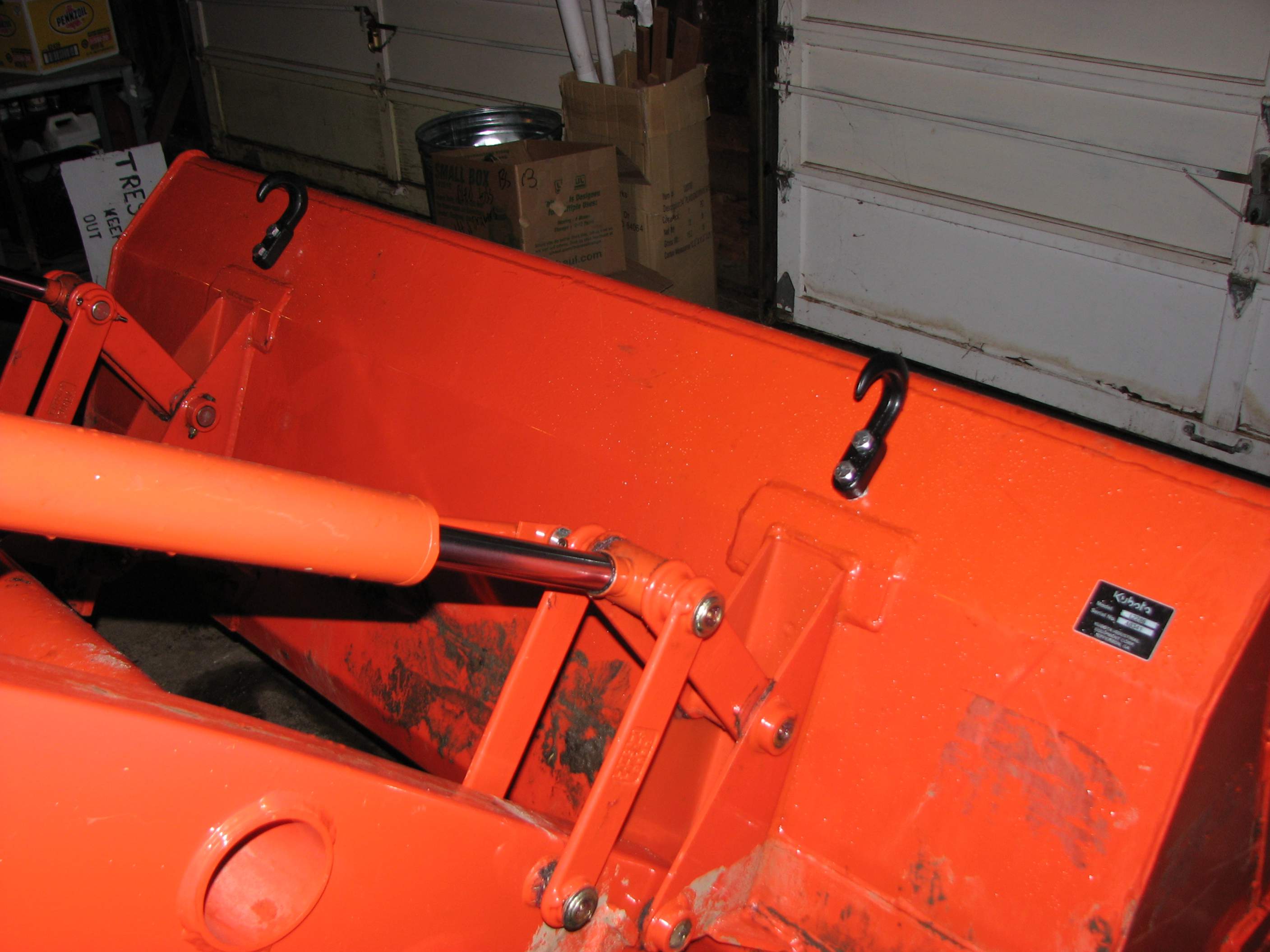

Been thinking about adding to my small B2320. Wanted to know if anyone ran into any problems with them..
Well I just packed an order of 2" Kubota hooks heading to OK, if that was from you I appreciate it! :thumbsup: They will ship out in the morning ;)

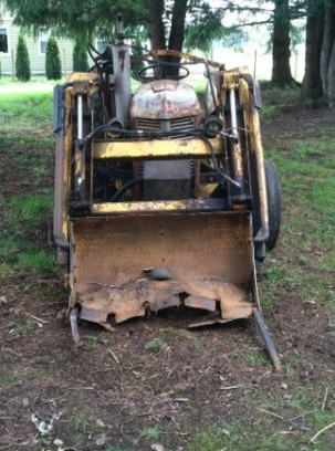

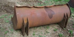

Here's another version of some serious bucket melt down due to a center hook.
/ Bucket Hooks negatives #31
I am not seeing hooks on the top. Also, looks to be a lightweight bucket, which if adding hooks onto would need to be reinforced.
Look again: the hooks are mounted inside the top of the bucket. I've never seen that before.
/ Bucket Hooks negatives #40
Oh, okay, I think I see it now. Thank you.
