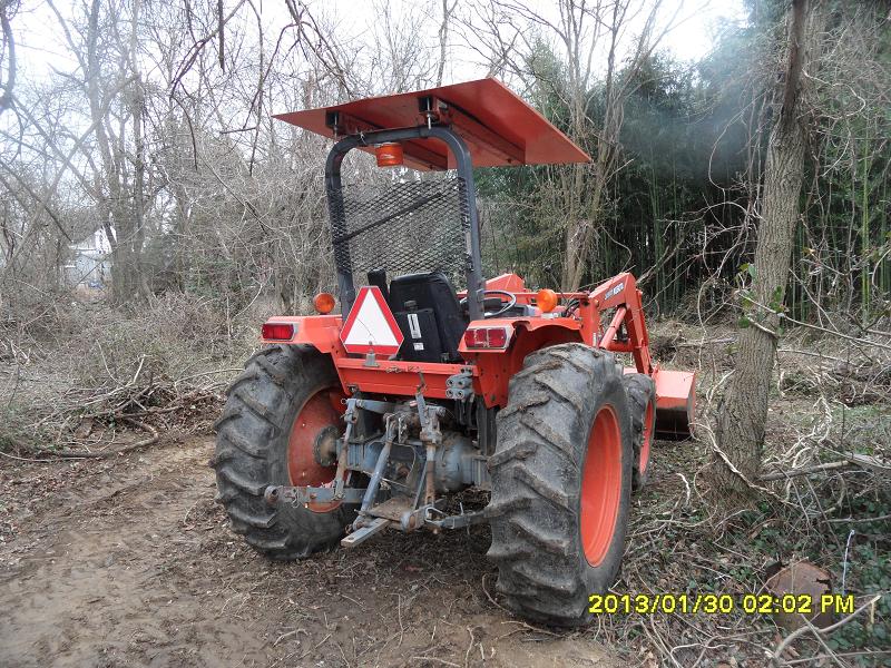

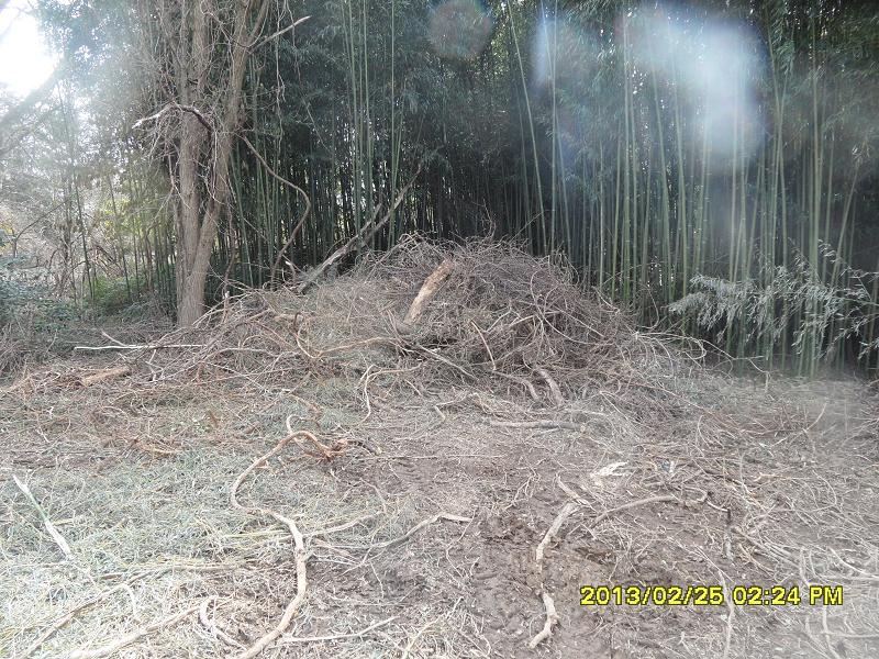

I spent yesterday afternoon clearing out pesky native vines on 1/3 acre in Florida with 52" Ratchet Rake on the bucket.
The Ratchet Rake is not a ROOT RAKE but it does pretty well pulling out dormant vines by the roots, especially after a rain.
The Ratchet Rake is not a LANDSCAPE RAKE but it does pretty well raking/piling vines after they are pulled.
At $299 the Ratchet Rake is hard to beat.
After I piled the vines, I picked up the three piles one-at-a-time with 2,000 pound capacity Payne's aluminum Debris Forks. To load debris forks I pushed each pile against a tree used as a backstop. Picked up 20% dirt along with 80% vegetation but I did not have to get off the tractor. (Remaining on tractor is a safety issue. Always a small chance a hydraulic line will let go under max load.)
Each pile was 800+ pounds as I could barely lift them
I had 600 pound Howse disc harrow as ballast in the 3-Pt. lift or the front end would have gone down instead of the load up. Ballast behind rear axle reduced stress on the front axle.
Because of "danglers" I transported loads in reverse to the burn pile.
One or two passes with 48" King Kutter Rotary Mower (bush hog) in a few weeks should complete demise of the vines and scrub oak volunteers.
An enjoyable, productive day.

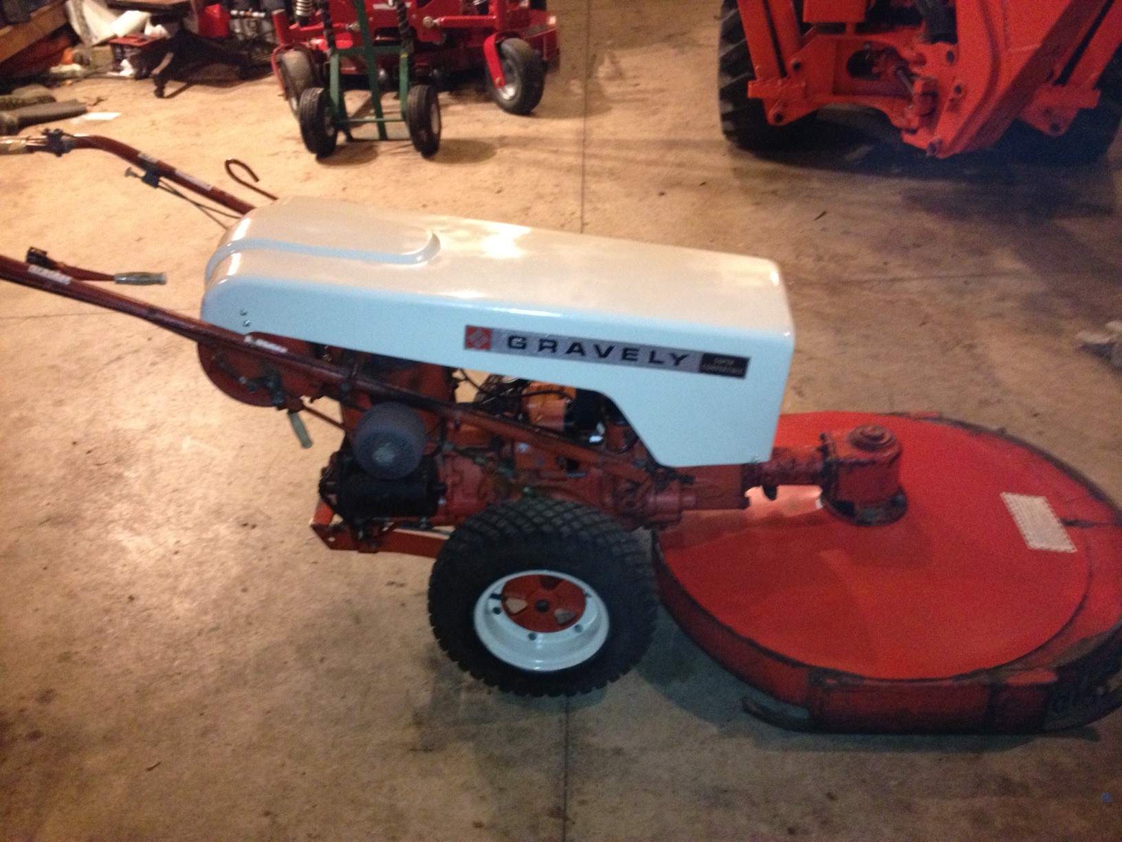

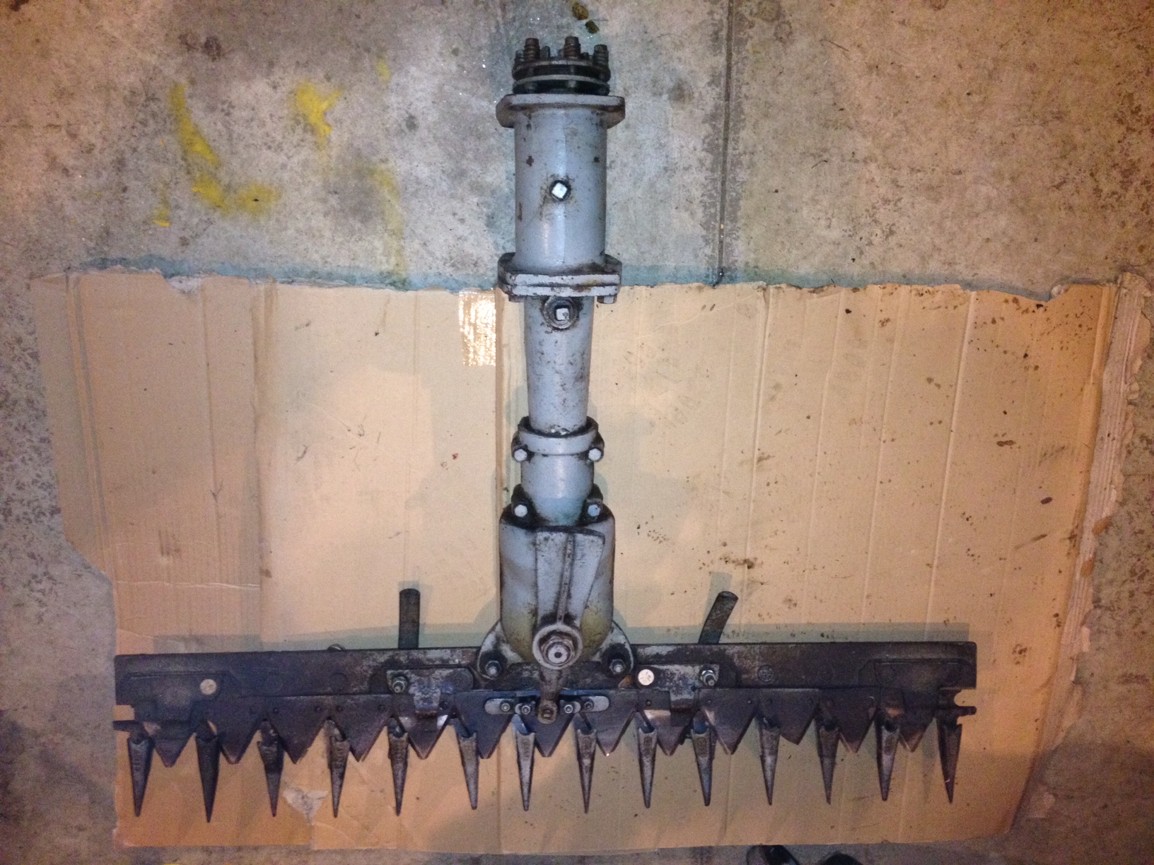

Here's one used John Deere 1050 4x4 tractor loader back hoe in NJ..
I have a Gravely Super 8 with 30" brush cutter that I might be will to part with but 300 miles may be a bit of a hike.. and a lot of work to run in your conditions - it wouldnt get the big stuff but would work on smaller vines and underbrush.
Carl
