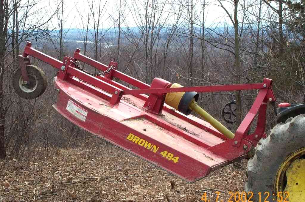

I would start out with a ~ 30 degree pivot point…
Each setup should be customized to your routine/terrain… after you setup the toplink… run the 3-point lift through its up/down range slowly… and watch for interference…
(this applies to any 3-point implement... not just rotary cutters)
1) especially the PTO shaft coming into contact with the rotary cutter deck (while lifting and not paying attention… you will bend/destroy the PTO drive shaft in a hurry…)
2) cutter deck/tire clearance (deck cutting into rear tires, both lugs and sidewalls)
3) check chains/stabilizer arms for restrictions/binding (you DON'T want the cutter to swing/sway from side to side, when in the UP position… but you need some slight movement to prevent binding/stopping throughout the lift range)
4) Check for hoses/wiring/obstructions to prevent crushing/shearing…
5) Finally, adjust your range stops on your position control for repeatable settings…
While cutting, periodically check again… while crossing creeks, ditches, going up/down steep inclines for the proper clearances/motion of the implement…

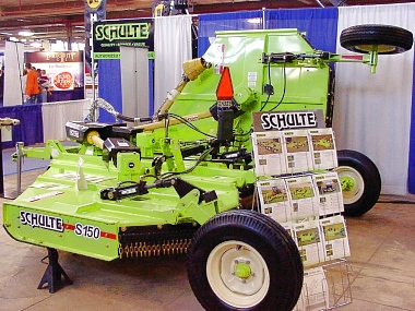

I'm assuming you mean my inline pictures I posted in this thread?... (illegal to do now.../forums/images/graemlins/wink.gif)
This was before some regulations were enacted and a number of my pictures caused the thread to "widen" too much and s...........lllllllllll............ooooooooooooooooo.....wwwwwwww things down a tad... but here's an answer to your question...
inline use: (use [] instead of {})
{image}picture file name{/image}
You can only insert much smaller pictures inline so as not to cause any viewing difficulties similar to this...
