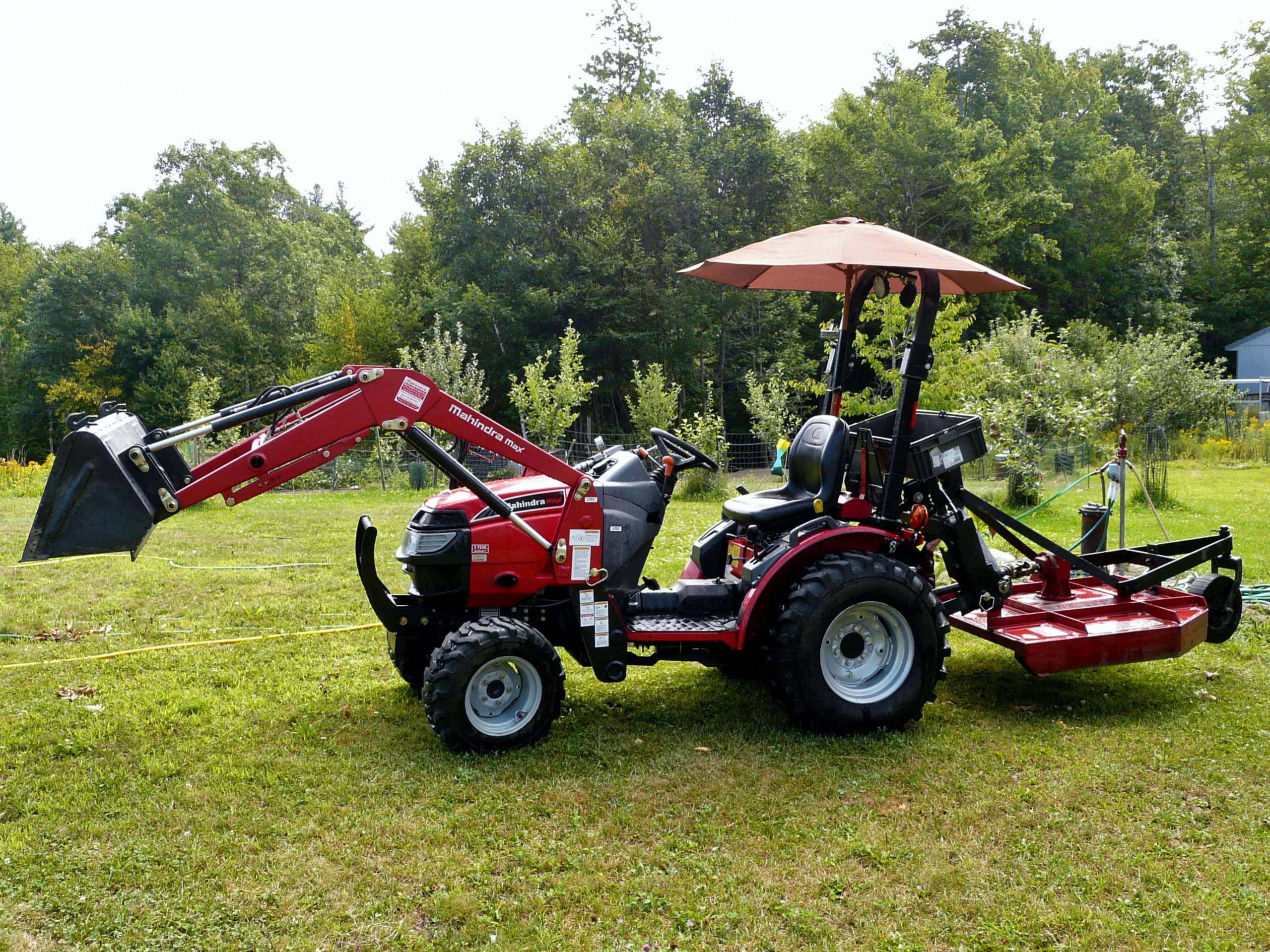

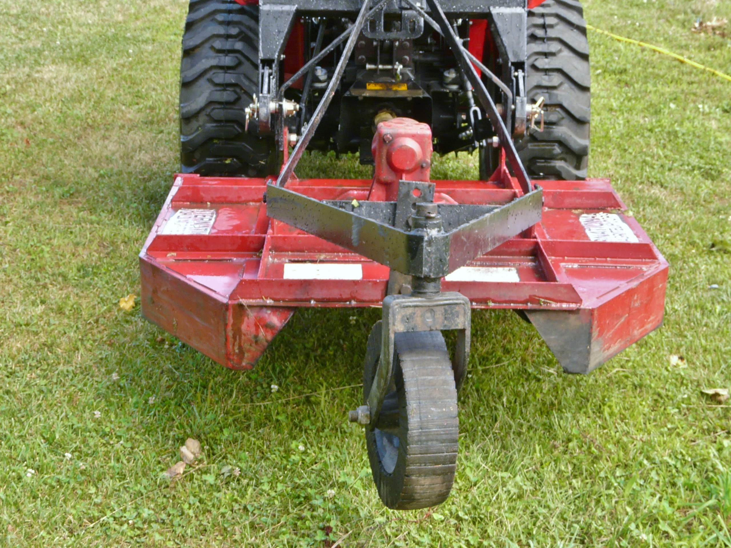

This 4' one works, I could use a 5' but this is very HD.
