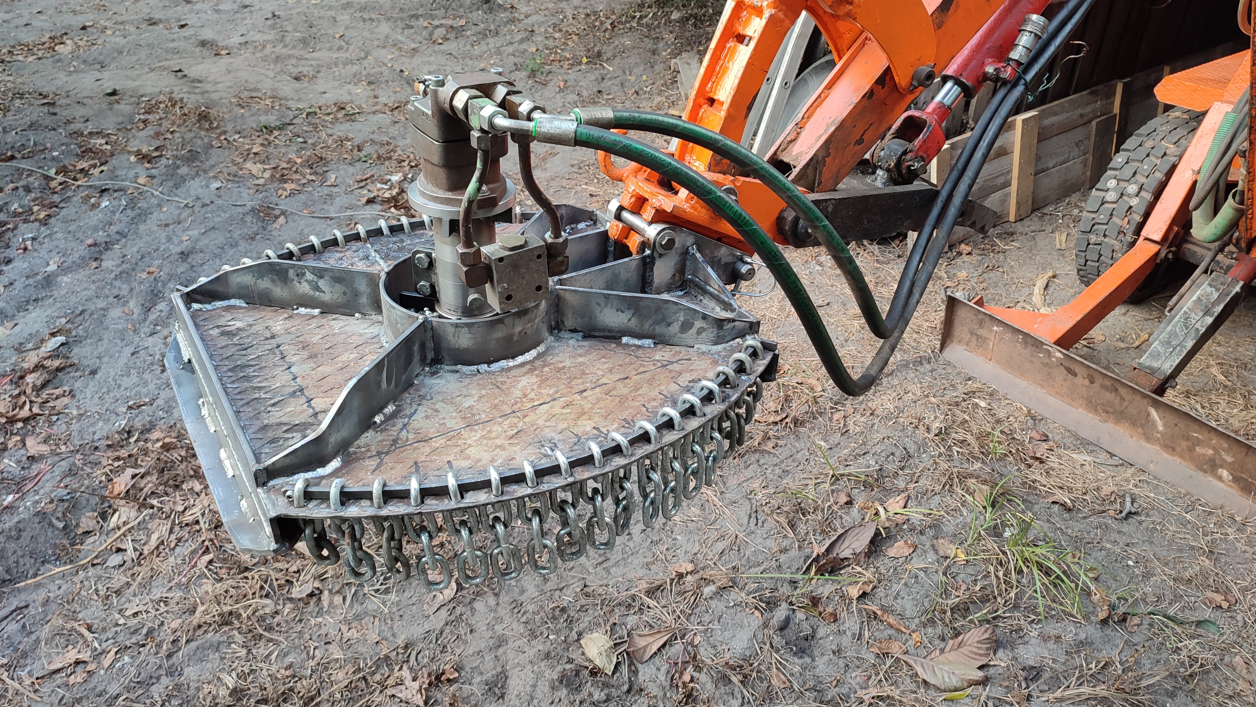

Here is an hydraulic brush cutter I built for my backhoe a month or so ago. I suppose it fits the thread, since mostly about using chains. I do have a flail mower for the backhoe, which worked fairly well, but it's just an heavy attachment and I wanted something lighter.
Cutting width is about 50 cm or nearly 20". Using 3/8" grade 80 chains. Rotor speed is about 2000 RPM.
It has been painted since, I just haven't taken any pictures of it yet. Still need to test it properly but for that I need to haul the machine over to the remote propriety, however I still have digging work for the backhoe here at home.

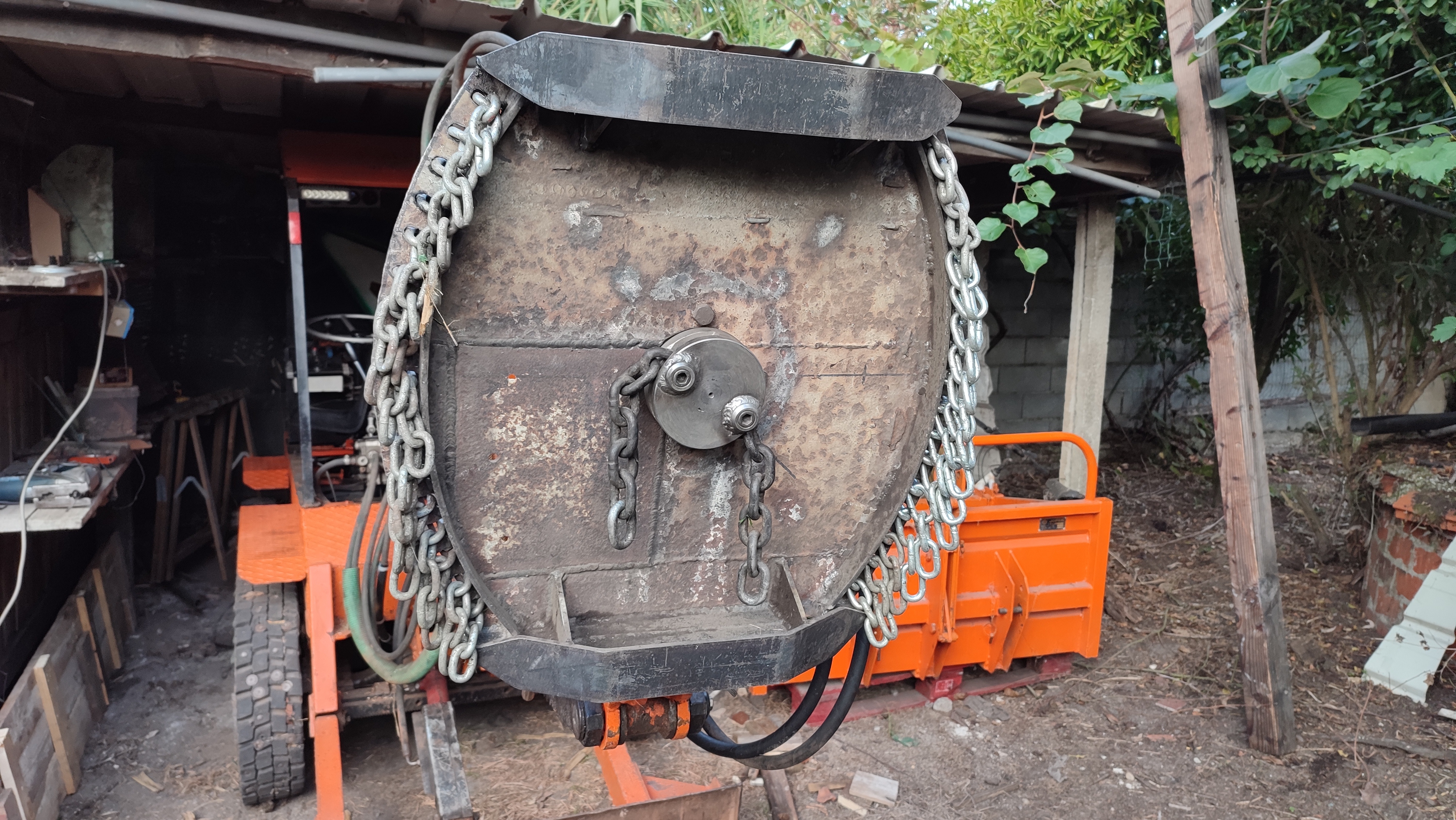

A stacked disc like pictured previously to capture the chains securely. The gear box is only rated for 40 hp. This seems rather light duty for constantly smashing brush. As for the description it was just stating to condition of it. Basically explaining it’s the perfect candidate to chop cut and rebuild into the styles posted from across the pond.
Thinking of removing the tail wheel and mounts. Opening up the rear of the cutter and making a chain guard for debris. Make new mounting points up front for the hitch and run chains so it can pivot. The stock mounting is just solid bent 3/8 x2” flat stock. No hinge point for flex currently. Which I assume is why the tail wheel got bent badly. They also hit something and bent the stump jumper on one of the blades. It does have nice thick flat sides I could easily build skids for it.
I have lots of fab skills , a decent welder , a mill , and a lathe to make what ever is needed.

Awesome fabrication! How many hours roughly into the build ?
/ Brush Hog mods #165
Honestly, I didn't really track my time on this build because I had other stuff come in between, so I put couple of hours here in there but maybe 4 or 5 full days? Around that. I "designed" this one entirely in my head and pretty much on the go, so that takes a little more time too.

This will be my winter project. We are into late fall and clearing jobs have slowed down. I’ve been very interested in the chain style cutters due to the conditions of the places I cut. Boulders , car parts , old fences, stumps , and almost always some demolished foundation. Replacing blades at $200 a set adds up at the end of the season. Most of the places are saplings up to 3” trees. The customers usually want the mulched material look. A forestry mulcher would require a lot of $$ in teeth by the end of the season.
/ Brush Hog mods #167
That's indeed a good application for one of these and that's what a deal as well with the cutter on my tractor. All kinds of hidden "treasures" but chains just skip over it and keep going.
Have you figured out the ratio on the gearbox you have? You really want as close to 1:2 ratio as possible. Chains need that speed to get the momentum going.

That is a really nice unit. Intriguing !! Could you describe the drive components you have there to get your 2000 RPM and a 20" width. I recognize the hydraulic motor is all. Is there also a gear box? And what flow and pressure do you need to drive it. Thanks.
gg
/ Brush Hog mods #176
gg
So my backhoe has a 17hp Kubota engine and for the hydraulic circuit, I'm running a Parker F11 5cc piston motor/pump, in this case being used as pump. Put out about 3.3 GPM at 2600 PSI for the auxiliary circuit.
The brush cutter, is running another Parker F11 5CC motor, in this case, used as a motor. With all the normal losses in the hydraulic system, this motor, even though is the same as the pump, loses about 500 RPM, so it spins at 2000 RPM.
The motor is mounted to a hub that I machined. This hub uses one top bearing, and two bottom bearings. Then, the rotor, which is all one piece, is connected to the motor using a Love Joy coupler.
I didn't want to put all those forces cutting thick brush directly on the motor.
This is the rotor where the chains attach to. Machined between centers to make sure there was no run-out anywhere to induce vibrations, which worked perfectly as it runs smooth as silk.
This is the hub where the bearings go to. I was test fitting the rotor. You can also see half the coupler. I'm only using grease in this, so I didn't have to add any seals.
This is the motor connected to the rotor and hub but without the motor mount yet. And the motor mount after welding but before any final machining:
I wouldn't want to run much higher than 2000 RPMs. Most of the comercial units, still run a gearbox, just like a tractor cutter, but with an hydraulic motor attached to it. I didn't see the need for one on this small cutter and I want it to be light.
