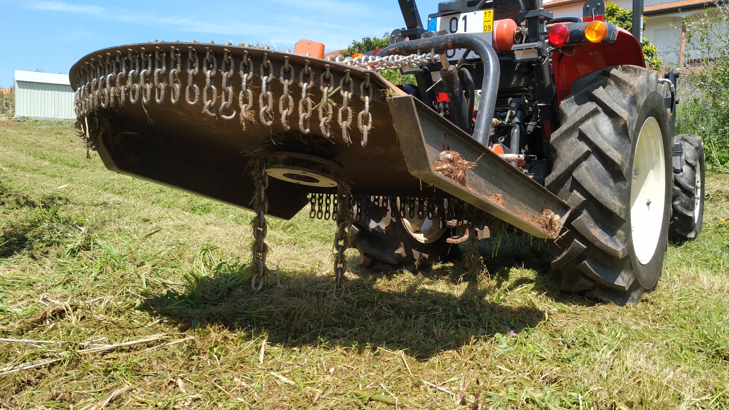

The commercially built chain mowers seem to follow a similar design of holding the chain captive between two round center plates.
1. How would you DIY something similar?
2. Is the gearbox on these chain mowers beefed up in some way compared to the normal rotary cutter gearbox?
/ Brush Hog mods #86
The hub to hold the chains is very straight forward. Two discs and a couple of plates to space them apart. Then, a pin holds each chain in plate. A little bit of fabrication and machining would do it. The machining is mostly required to weld the splined sleeve to the hub it self as centered as possible with as little run out as possible.
The gearboxes, for the most part, are just standard brush cutter gearboxes from Comer. They're available in 30/60/90/125 HP. A 30HP gearbox will handle easily a up to 50 HP. Mine uses a Comer LF 205J gearbox.
The forestry versions tend to use bigger/stronger gearboxes and possibly higher output RPM.
I believe I'm going mowing today, if anyone wants some close up picture of any details, let me know.

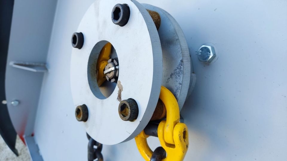

I should've clarified the splined sleeve is supplied with the gearbox in most cases. It would've to be welded on the hub that holds the chains.
Here is a picture for clarification:
Some places sell it like that, others sell it complete with the hub already made and ready to go. Pretty much a bolt on deal.

/ Brush Hog mods #95
I would imagine there is nothing like this in the US, unless it's homemade, but I'm an entire continent away with a big pond in between so I have no idea what's available there. 😅
I've seen at least a video or two, of people using it in Canada though.
Anyway, got some closer pictures of the hub. Picture #1 is one of the pins. Picture #2 is a terrible picture of the pin in place, kinda hard to see. The rest is different views on the hub. Last picture shows how high this cutters can go, which is really helpful on tall brush and mowing against embankments.

In the 4th picture, it looks like the pin on the right is not engaging the bottom hole very well if at all? Do you need to replace the pins from time to time?
Good catch. I'll need to check that out ASAP. There is something funny going on there, even though I used it after taking the pictures without any issues.
The pins do need to be replaced eventually. Mine wore out about 1/3 of the diameter of the pin in about 300 to 320 hours of use. Knowing myself, I'll probably fill it with weld and run it some more.
It really shows that with any type of implement, it's important to do a walk around and taking a closer look at stuff like this every once in a while.
I checked a older picture from when the cutter was newer and you can see both pins.
/ Brush Hog mods #99
The pins wear out in a rotary cutter too.
In one of mine, I've had to fill weld the groves in the pins where the blades wear into them. The holes in the blades will elongate too.
SR
