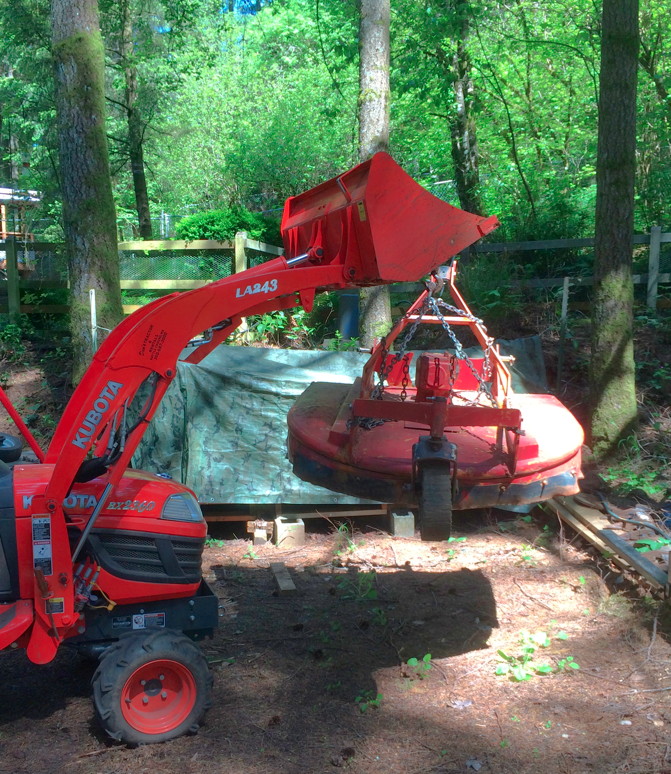

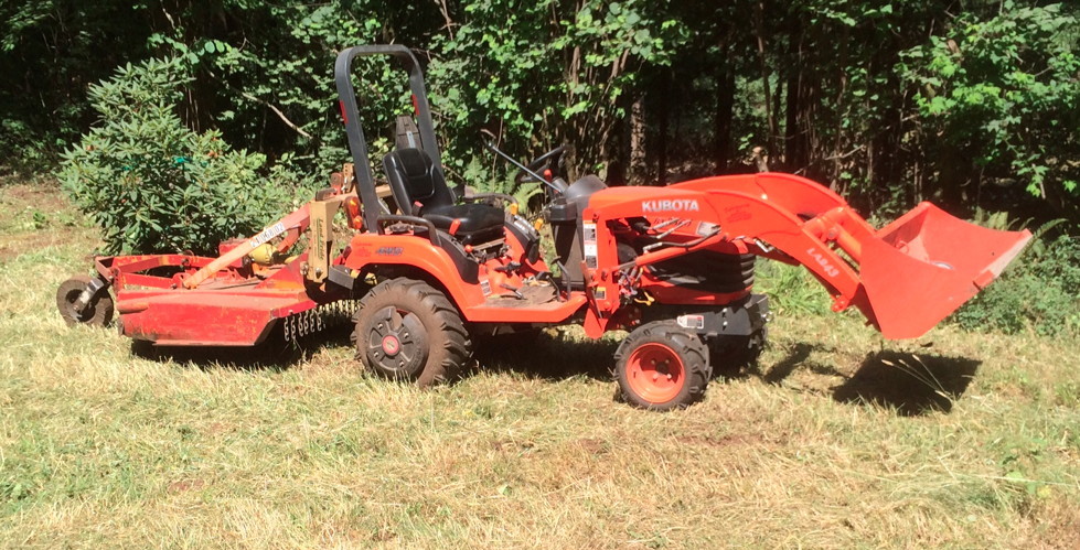

BB48-no complaints.
Arrival, just pulled out the trailer:
In use:
Bruce
