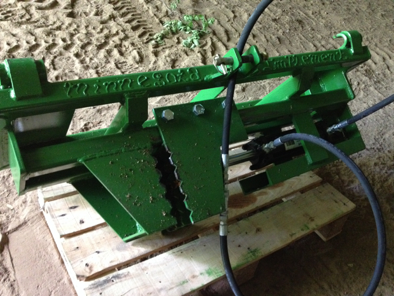

I learned the hard way. I started off with the heavy duty spring loaded grubber, which worked fine, but required too much getting on and off the tractor and was terribly slow. Then bought the BG-10 which is the design that goes on the pallet forks. That didn't work well -- trees would slip out of its grasp easily. I modified it which seemed to help some, but it failed more often than it worked.
Finally, I purchased a hydraulically operated tree puller for my end loader. It costs something like $1400 but it works every time and I never have to get off the tractor. I can pull a tree out every 30 seconds. After all the trees are pulled, I chainsaw off the root balls and chip the entire trees.
It took a while, but I now have an effective way off clearing my dense willow growth.

Now that is a NICE setup -- that is the Cadillac of solutions right there. And $1400 isn't bad if you have a lot of use for it.
Yes, definitely a nice setup but the hoses look rather exposed. I'd put some 45s or 90s on the cyl port to get that loop of hose down away from the trees
/ Brush Grubber or ???? #12
Great video demo. The hydraulic hoses are definitely not well routed!! A small sappling may not damage exposed components, but suffice to have one heavyer tree to bump on them tu create a real fluid mess... I would also like to see a brush guard added!:rolleyes:

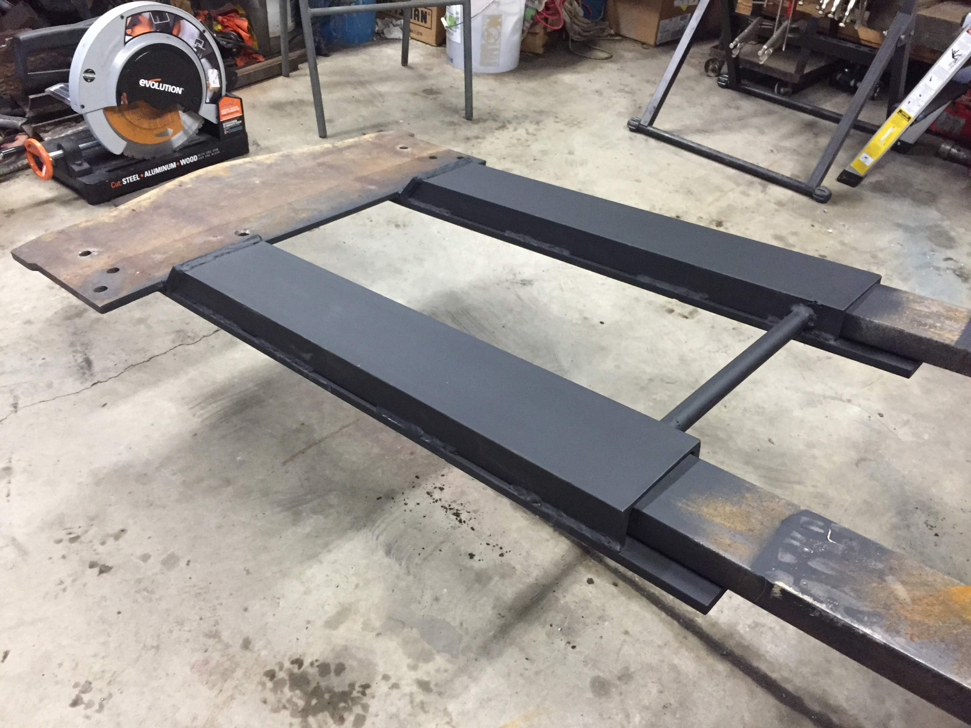

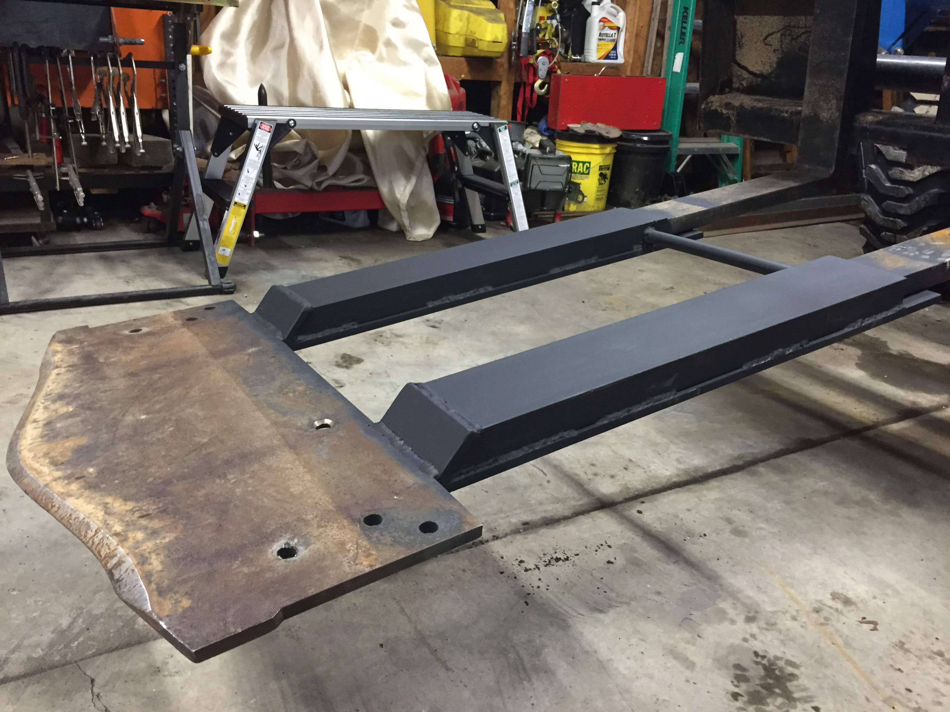

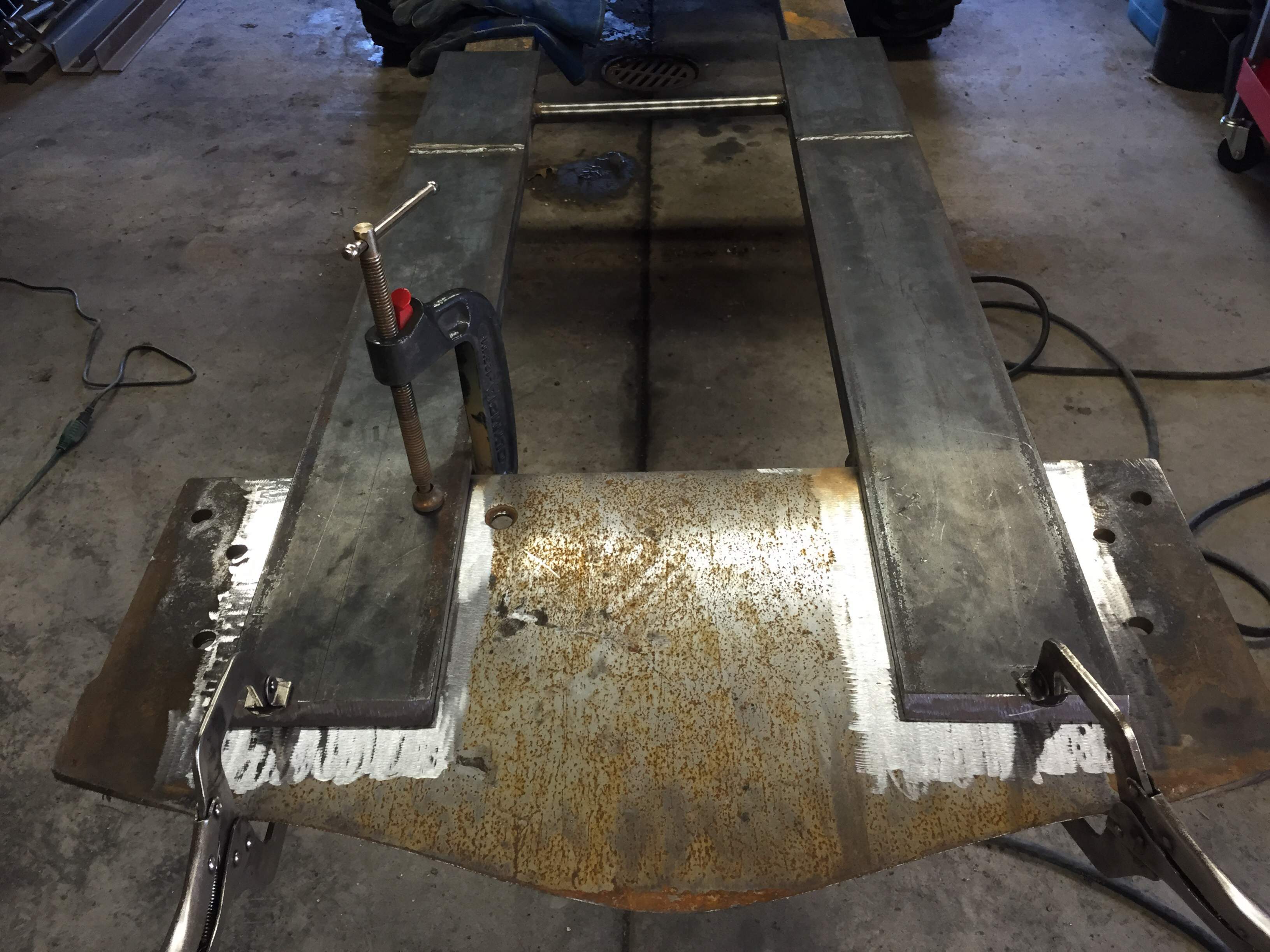

I'm in the process of building something to go on my FEL. Material is bought and cut. Just needing to start on the welding.
Check out this thread and look at the picture in post 2 and the video that C4Ranch linked to in post 8. That's basically the way I'm going. Hopefully it will be as efficient as what LouieJunior bought for $1400.
Speaking of LouieJunior - I will THANK HIM publicly for saving me $700 by posting up about the first BrushGrubber Tree/Post Puller thing he bought. When I bought my tractor, that was what I was originally going to buy. LouieJunior posted up about the limitations that thing had and answered a PM or two that I sent him. Nothing like the voice of experience to help out!! :thumbsup:
