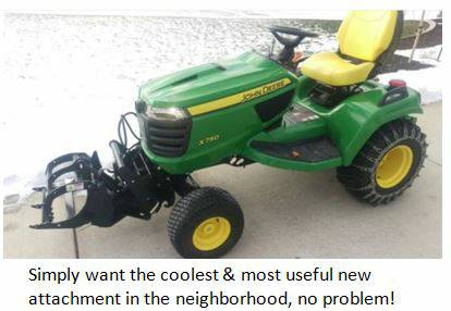

Congrats on moving down the path. See - I told you it was a beehive. :laughing: The veteran grapple users here on TBN have tons of experience and knowledge, and some have a little passion too. They all helped me in my decision process and I am grateful for that. $20 bucks says you will be happy with your new grapple if you know, and have considered your needs while also weighing the great input in this thread. Checking out the other grapple discussions on TBN might help solidify your decision even further.
The people that own these two units below from either end of the spectrum are happy with their decisions, and I'm sure you'll be happy with yours as well!

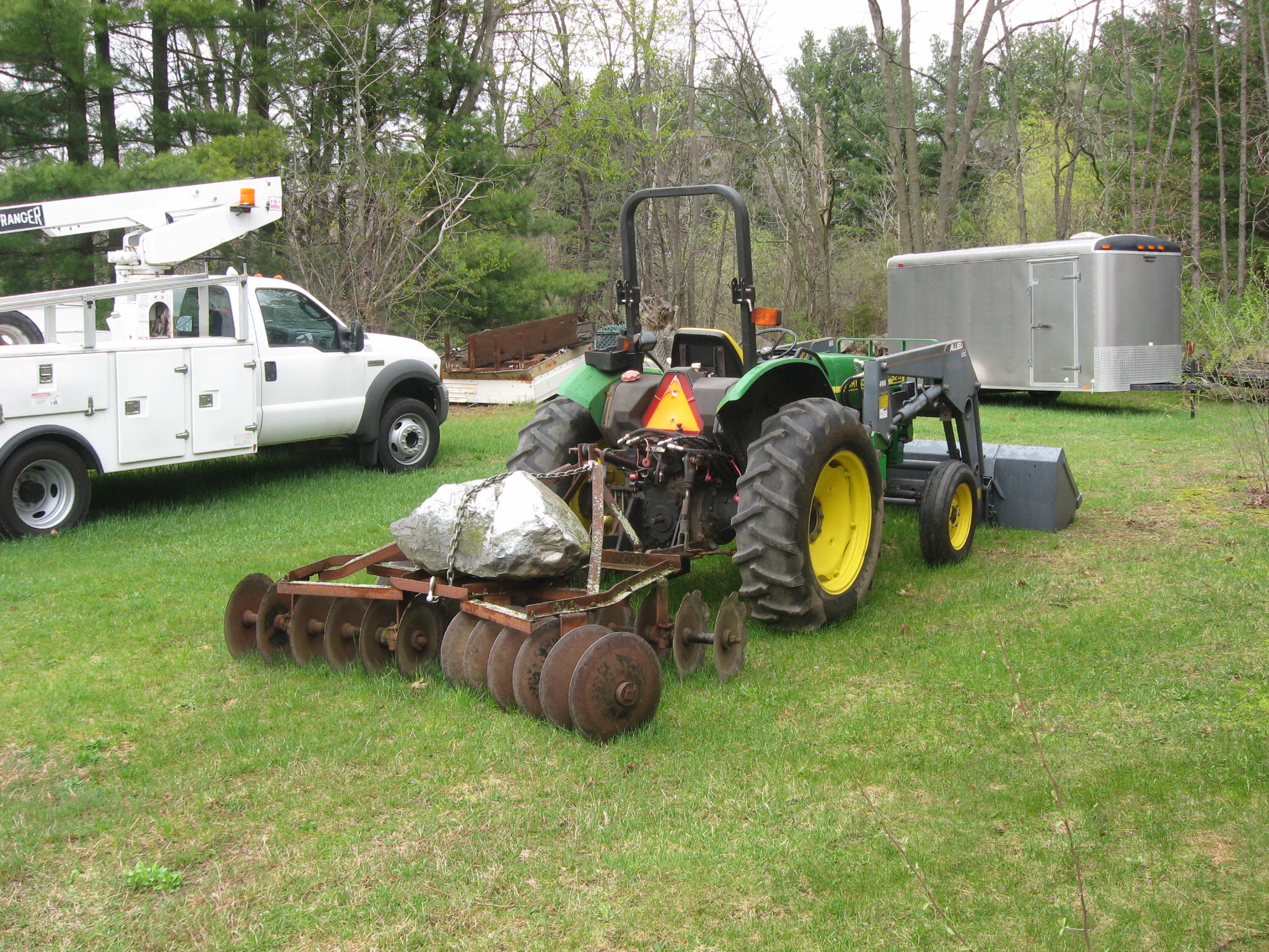

Two years in with a MIE 48" single lid grapple (vs 60" bucket) on the very light & limited (lift) NH. (two yrs late to review same, but wanted to back up my points with pics, etc)
I never feel like the 'narrow' tool is lacking in any way, more often wishing I had more tractor to work it with. Sure was handy for adding ballast to the Deere for the o/sized FEL.

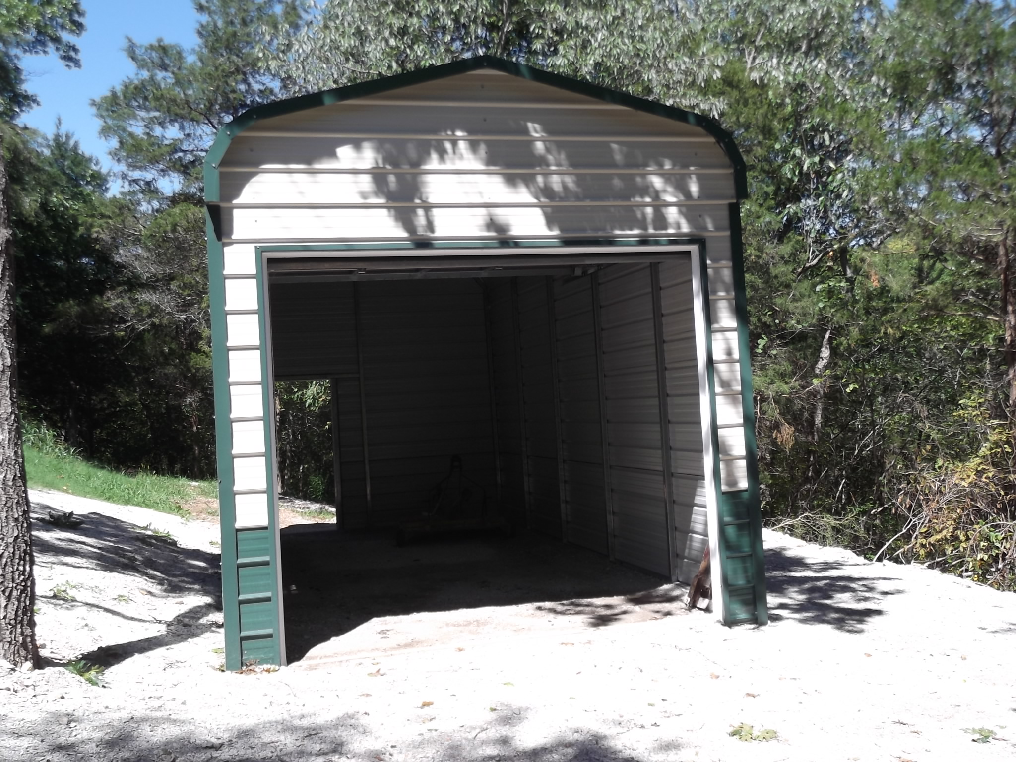

Yeah, my Kioti den is too big... yeah right. I wish it was twice as wide.
My garage is 32x60 with 5 doors and an auto lift. All doors have a vehicle in them (2 trucks, 2 cars, tractor) and the atvs, lawn mower, implements, etc. have to find somewhere that access isn't *impossible*. I also *always* have to move something OUT of the autolift bay to work on whatever is going in.
I know, I know, first world problems..............but I *thought* i had planned ahead and built it big enough.
   / Brush Grapple Preferred Width? #47
I am not sure there is big enough.
