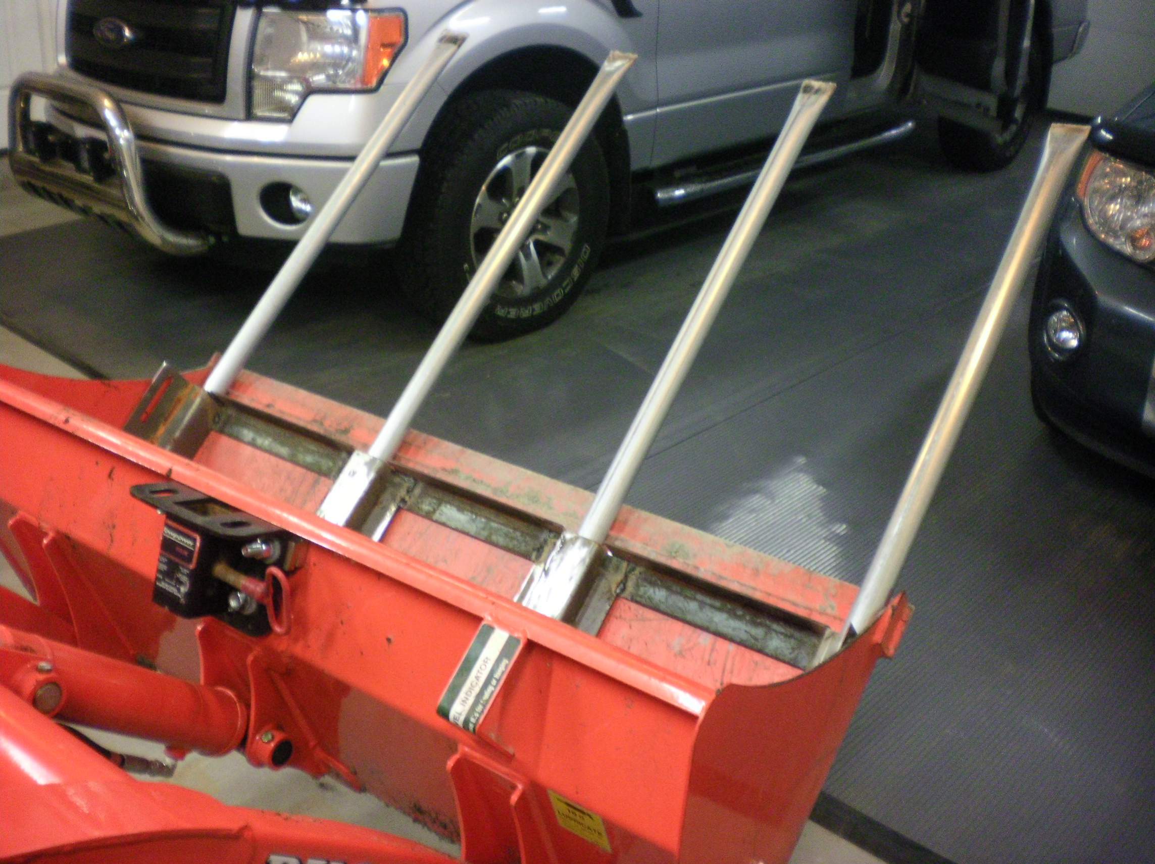

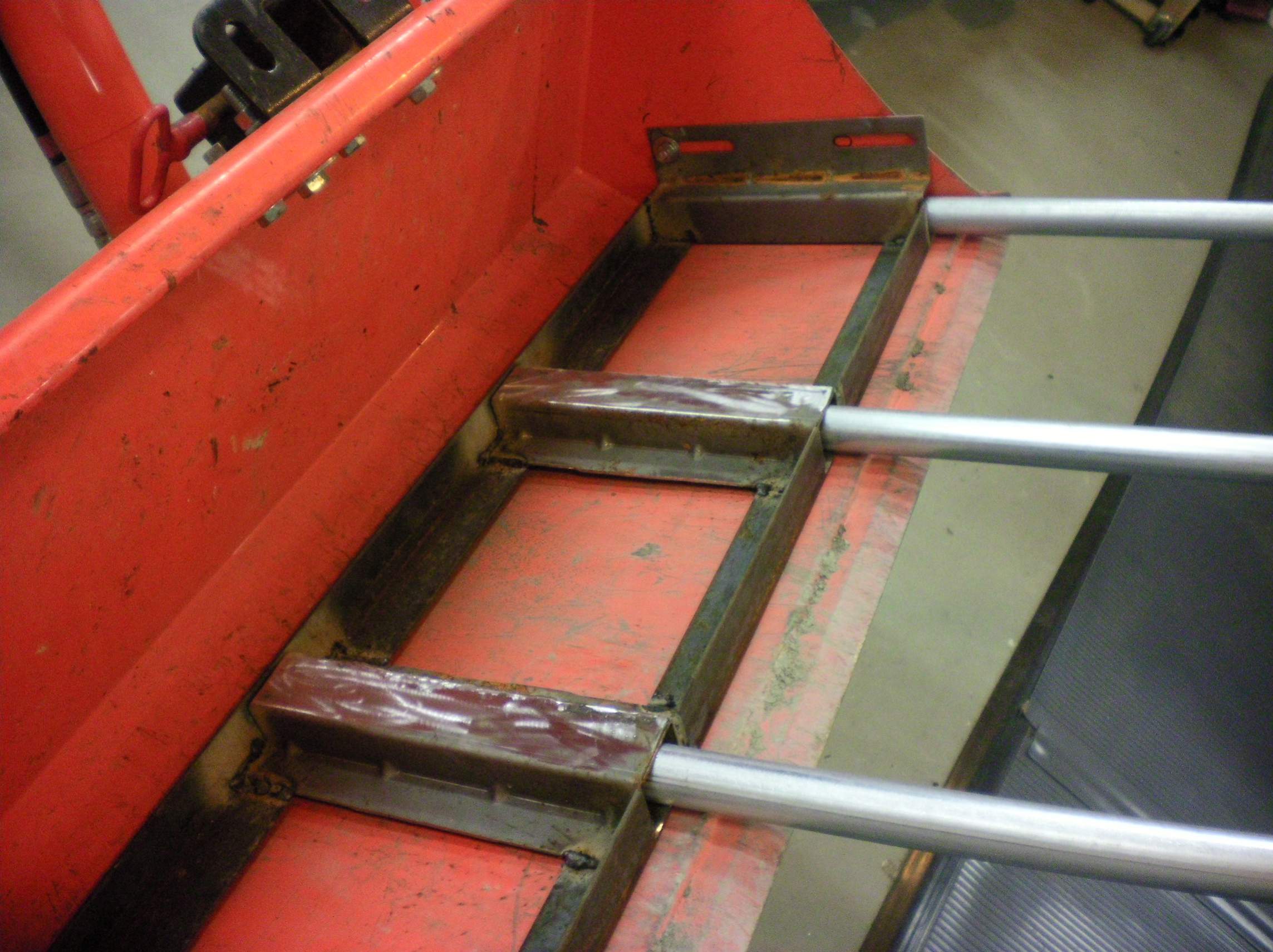

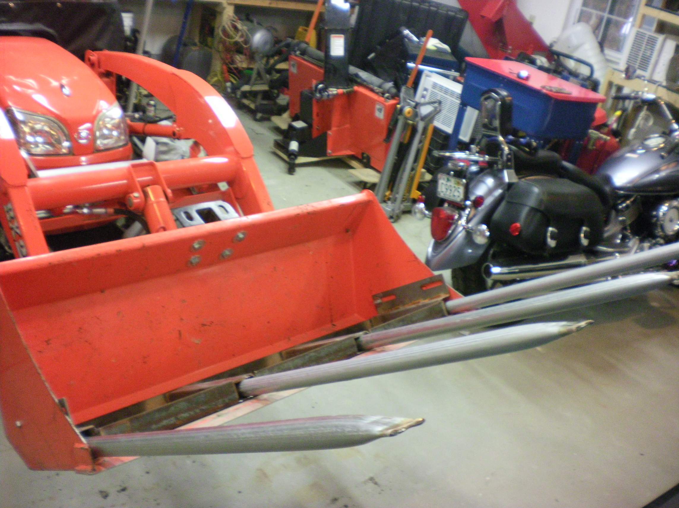

had an idea and created them today. held in by 2 bolts and 2 pins they are easily removed. Also all the forks are pinned in so that if I need a longer fork , I just need to pull them out and put longer ones in . Or take out the end 2 and move a pallet.
/ brush forks for bx25 #2
Looks like it will work good and be real handy :thumbsup:
