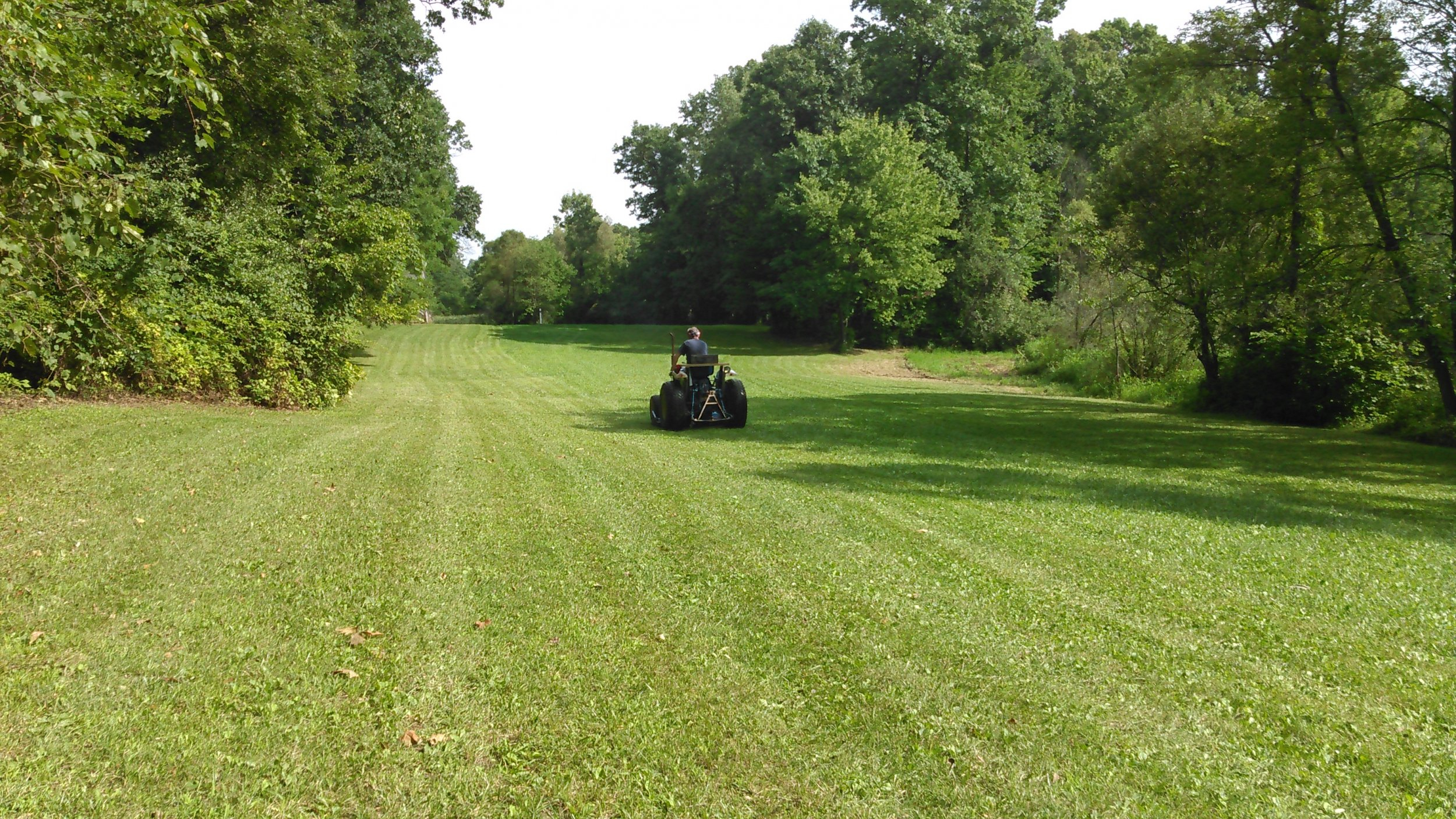

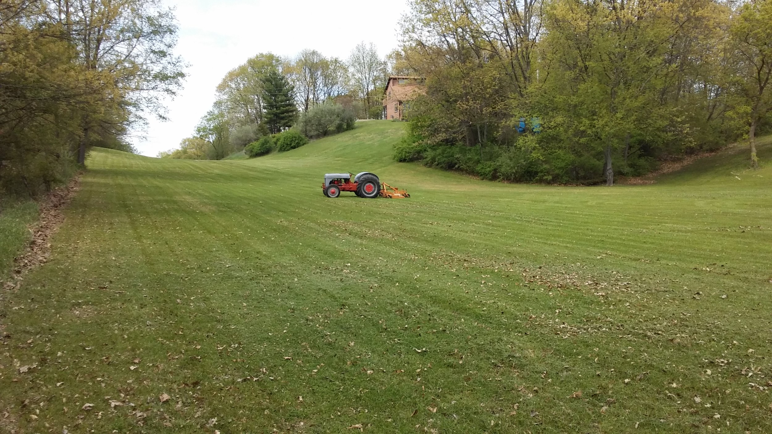

/ Brush cutting for beginners... #28

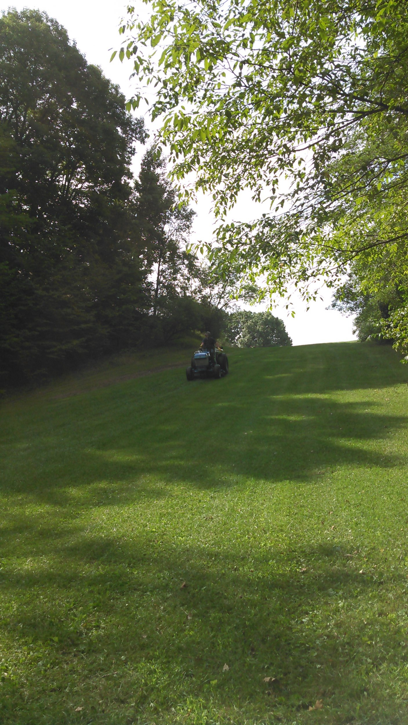

You are correct, you have no obligation to maintain the easements.
I chose to for my own use (& to please the wife.)
Front....View attachment 706846
Over the hillView attachment 706853 View attachment 706854
I use a finish mower.
Have a bush hog to do "extra" clearing in the woods & swamp.
If I only had one, it would be a flail mower.
They can cut almost as nice as a finish mower or do almost as much as a bush hog depending on how you adjust it.
That land is begging for bulls and hogs alternating every three years. They would add a finishing touch to make me feel more at home walking through there.
