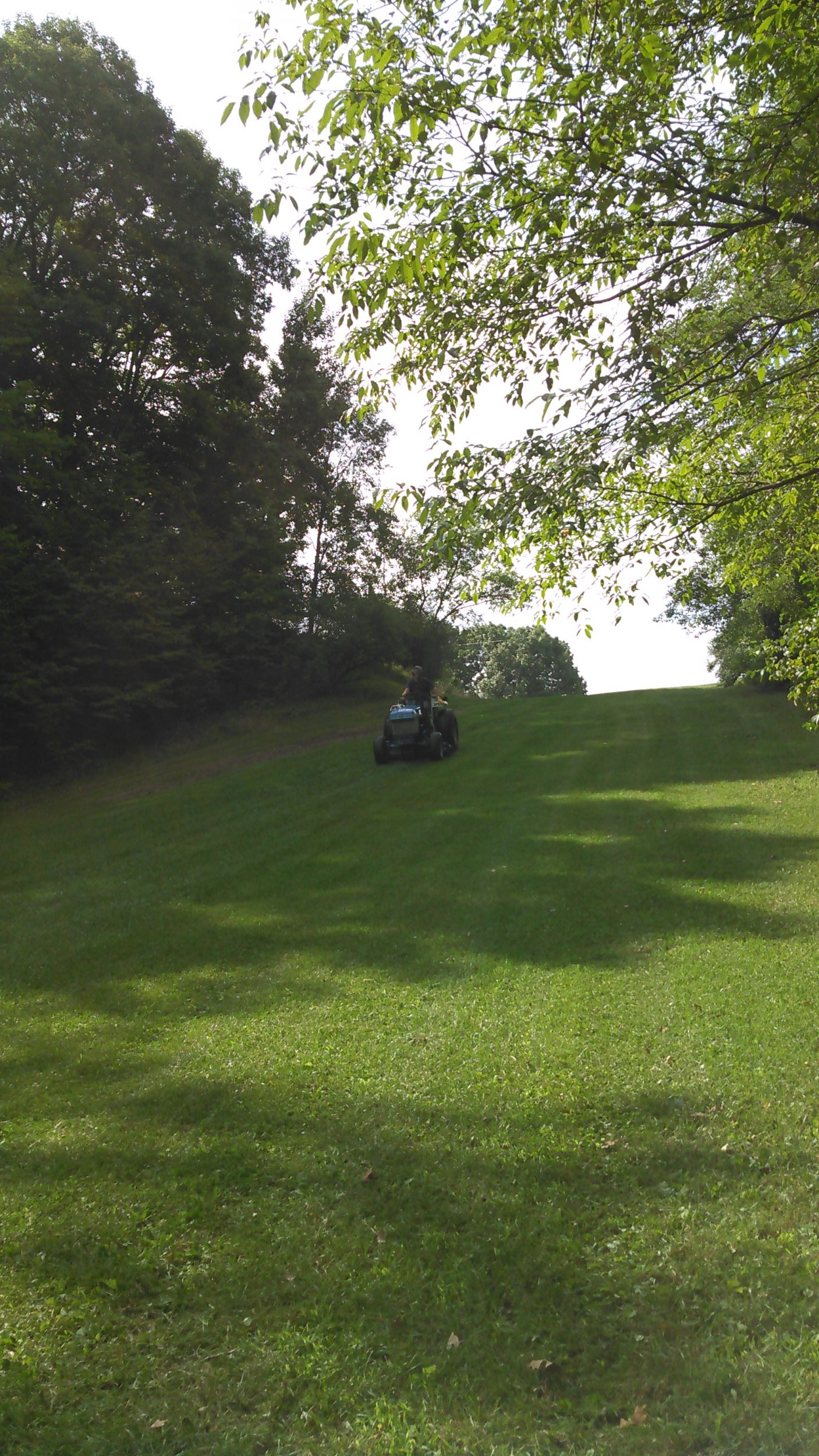

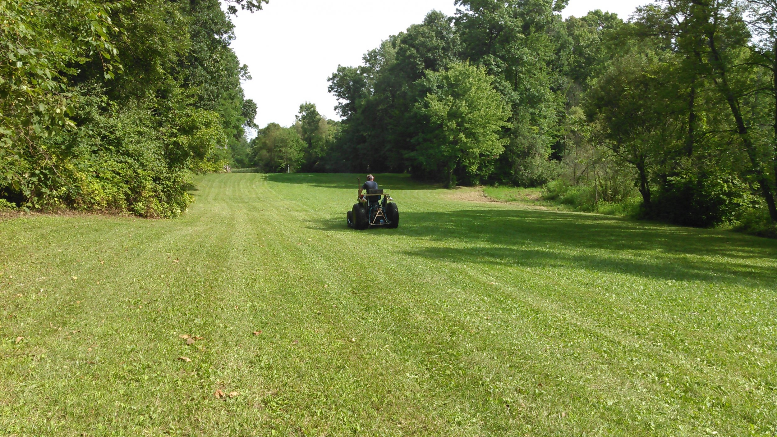

You are correct, you have no obligation to maintain the easements.
I chose to for my own use (& to please the wife.)
I use a finish mower.
Have a bush hog to do "extra" clearing in the woods & swamp.
If I only had one, it would be a flail mower.
They can cut almost as nice as a finish mower or do almost as much as a bush hog depending on how you adjust it.
Front....View attachment 706846
Over the hillView attachment 706853 View attachment 706854
Wow! That looks like a fairway! I am highly unlikely to ever try to make it look pretty. Knock down the noxious weeds and insect habitat. Make it more easily travelled. It is clear on part of the easement that the utility companies have not been doing their job. In some spots there were saplings/young pines that are at least a few years old.
