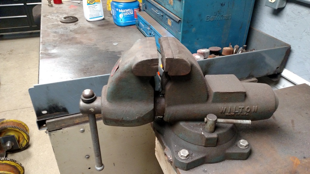

I broke my 6" vise in the channel part 10 years ago, I went to the welding supply store, bought some 1/8", 11018 stick rod, I v it all out, shined it up, looked like cast iron. Then started welding, had to pause here and there because it got hot, tried to keep it under 300 degrees, lost count of the rods but probably used 2 lbs. or so, still using the vise today but I no longer put a pipe on the handle, hand tighten only.
   / broken vice qustion
#34
I'll have my new wilton vice 6" by end of the week!. I should of known better then to buy a vice at H.F. most of there stuff is MADE IN CHINA JUNK!.
