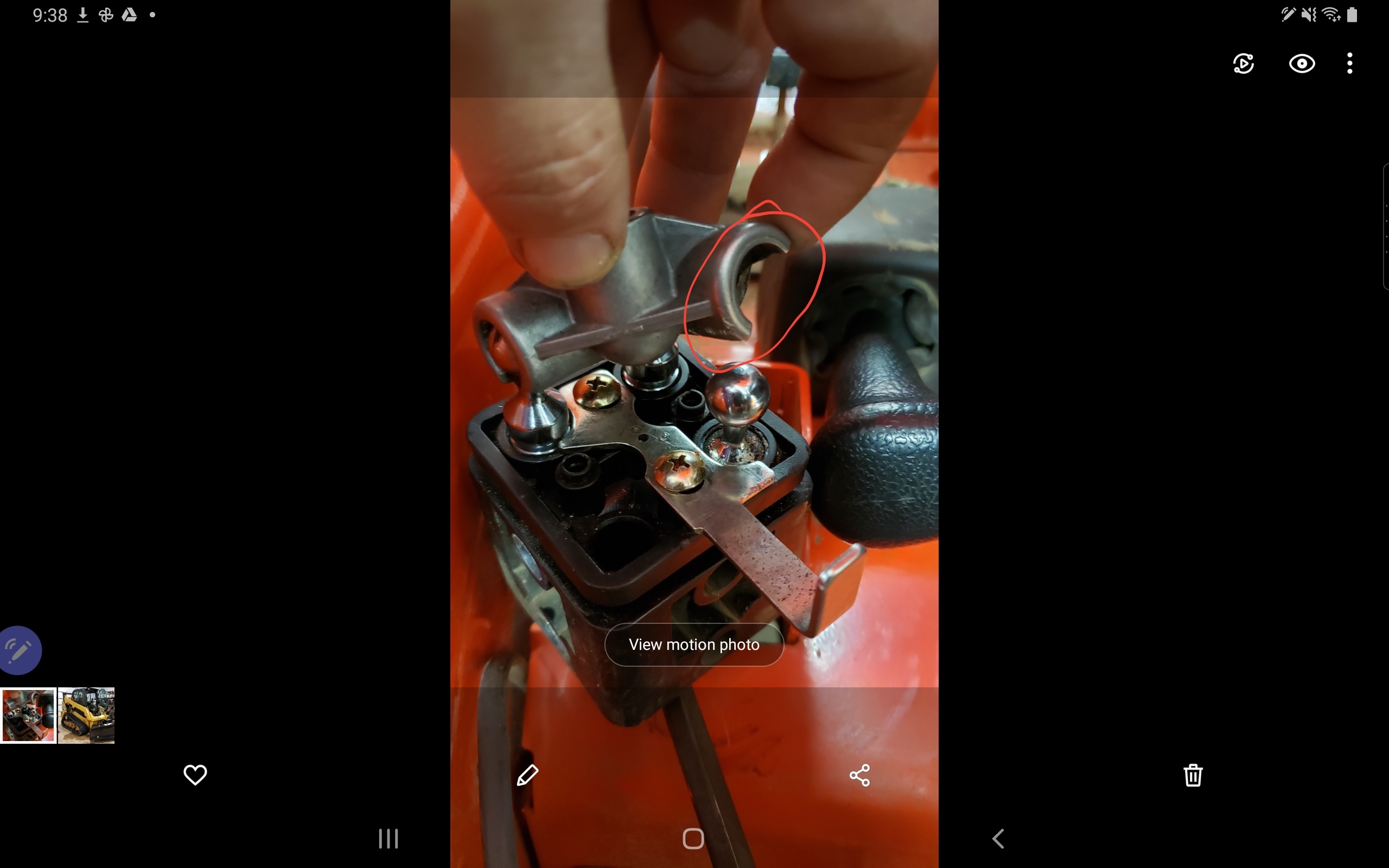

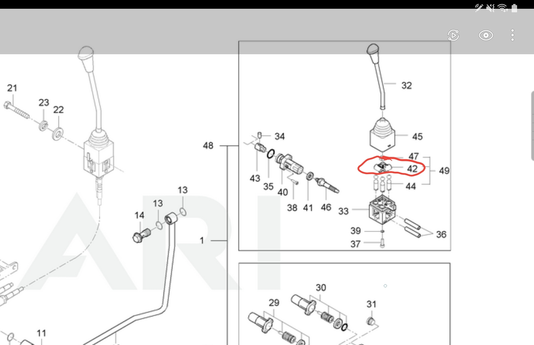

I broke the Joystick selector part(36001-0140) on my DK40HSE. Trying to figure out how to get the part out so I can repair it with the replacement part I have coming.
Do I need to disconnect the cable links inder the body of the assembly, or is there an easier way to get the selector part off of the 3 ball joints.

How did you disconnect it at the valve? I tried pulling the 2 Allen head bolts but that didn't help then I loosened the adjuster nut and it's still connected.
   / Broken Loader Joystick Valve Selector on 2014 DK40 HSE
I finally figured it out. I needed to remove an allen head bolt on the back of the assembly that release the one ball that is not connected to a cable spool.

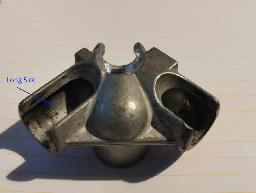

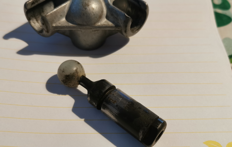

Even knowing how to do it, I still got caught. I struggled for about 30 minutes trying to get the balls in and then realized that the new part was badly molded and wasn't letting the ball go all the way in the long slot, thus preventing me from getting the others in.
I had to drill out the slot so the ball would go freely all the way to the end. Cranky that I got a faulty part. So make sure the balls slide in the slots before trying to assemble it. Pics showing the long slot and the old type Nylon coated ball.
If you don't see it has a long slot before you try to fit it, Then once it is upside down you can't see the slots are different so you might struggle for a long time.
Put a ball in the long slot first or you will never get the others in. LOL
First time I replaced mine was because they were badly designed balls. Second time I jumped off my tractor and the joystick went up my shorts as I jumped and split one of those molded nylon balls off. Parts cost just on $300 here in Oz now. First time it was $200.

Two of the slots on the selector were not cast correctly and I had to grind them out. In order to get it back together I had to put the handle back on the selector so I could push the balls down while getting the 3rd stationary ball in. Thanks for the help!
