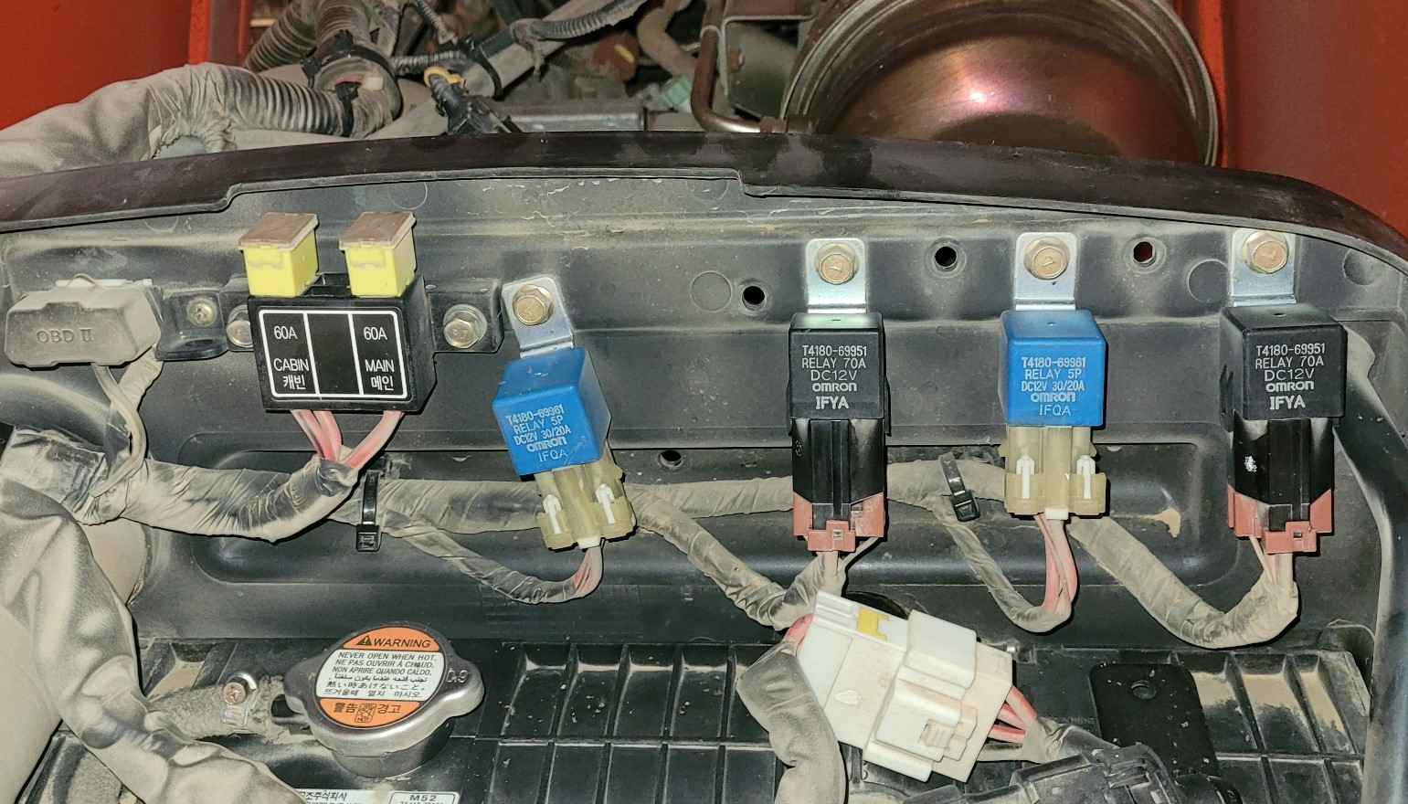

Eric, attached is a pic of the relays on my radiator support (which I incorrectly referred to yesterday as a firewall before I actually popped the hood to look again today!)
The start relay is the blue one, second from the right. It is 30/20A, not 70A (as I also incorrectly said yesterday without actually looking again). Back when I had the mystery starting problem that I posted about in the linked thread, I tested all of the relays shown.
I've also attached pdfs of pages 730 and 731 of the shop manual I have. They describe the relays and give the testing procedure.

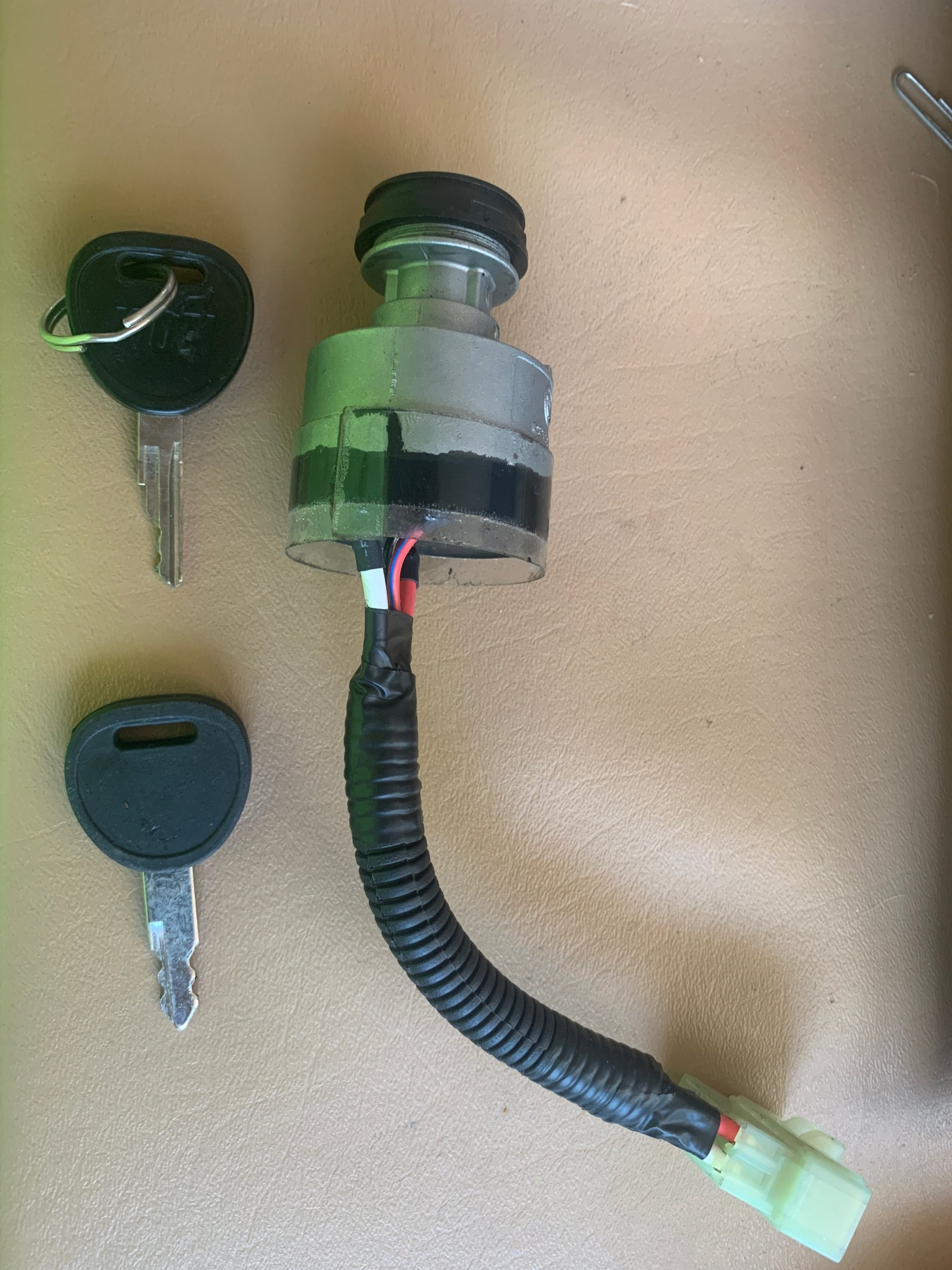

Update: Today the correct part number key switch showed up. I was expecting that it takes a single-sided key like my NX6010 doors and OEM switch takes, but it takes the double-sided key. My parts book doesn't even list a part number for a key, let alone the double-sided key. I'm hoping This double-sided key on eBay is the right double-sided key so that I can exercise the new switch, as well as use that double-sided key to remove the lock cylinder in the new switch.
In the meantime, I popped out the lock cylinder in my OEM key switch so I can swap lock cylinders between the switches so that my original key works in the new switch as well as both doors on my cab.
All to say I still have not been able to do jack because now I'm missing the right key to exercise the new switch. More snow is on the way. Sigh.
   / Anybody dig into the cable-actuated joystick/loader valve on a NX series tractor?
#18
A little sidebar for those of us with single-sided Kioti keyed tractors and double-sided keyed Kioti tractors in the hopes of saving somebody else uncertainty and anguish:
So I received what looks like the universal double-sided Kioti key which fit into the new lock cylinder but couldn't turn the lock cylinder (facepalm)!
After fiddling with the ill-fitting, fitting key I was able to use a 1/16" roll pin drift and pull the double-sided lock cylinder out even though my new double-sided key couldn't turn the lock. Sweet.
I tried popping into the new switch my old single-sided key cylinder so one key would start the machine as well as work the locks on my doors except the single-sided key cylinder would not fit. Understand that the OEM single-sided lock housing looks just like the double-sided lock housing and so I compared the lock cylinders themselves together.
As it turns out, the new, double-siding lock tapers just a bit at the end that goes in first in comparison with the original single-siding lock cylinder. Looking down the new switch's empty lock-cylinder hole, I could see what looked like a plastic-rubberish bushing. Twenty minutes of picking at that rubber/plastic shim thingy and I'd gotten enough of it ripped out so that the original single-sided lock cylinder fit properly, locked in, and easily exercised the new switch.
