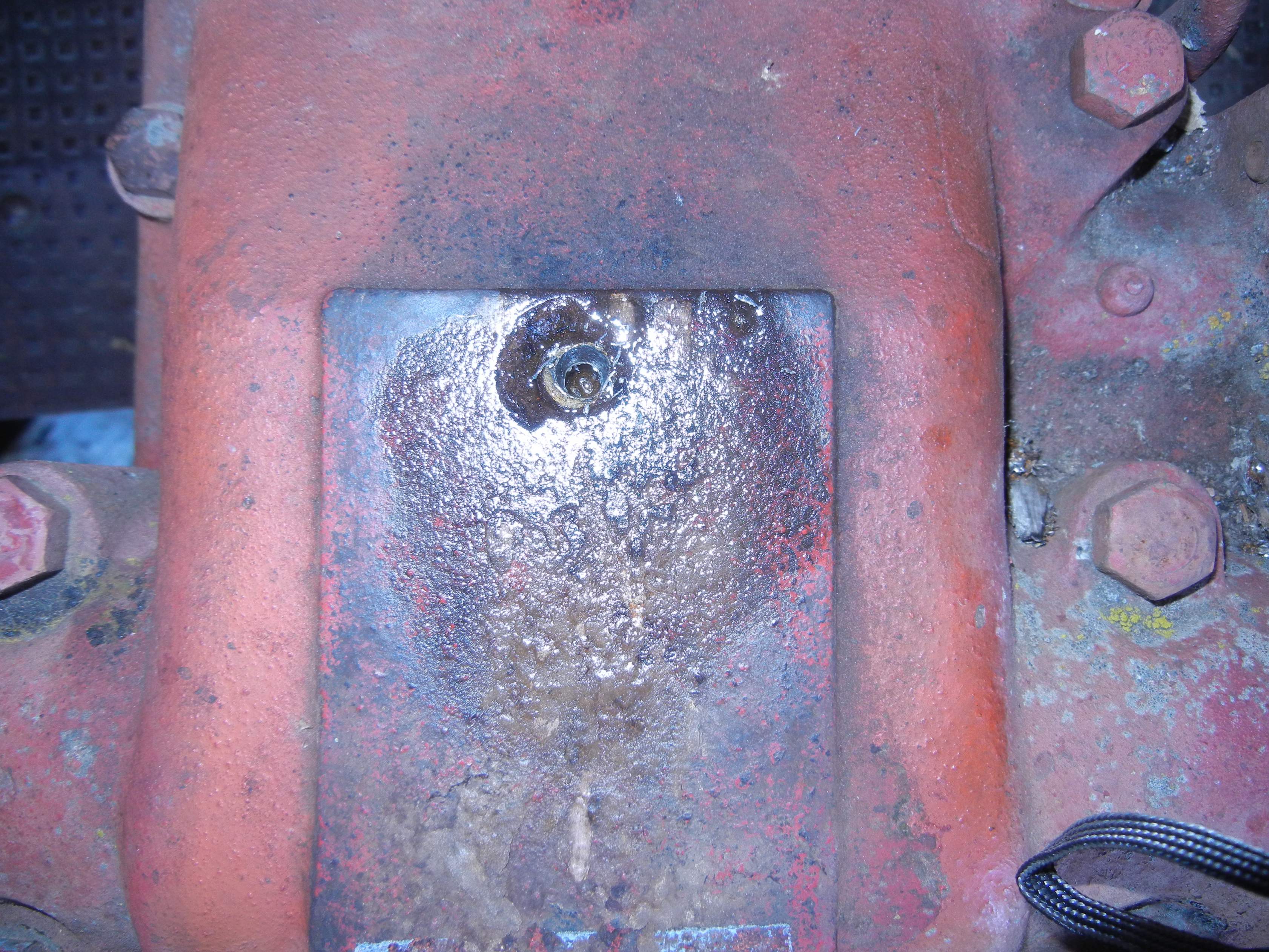

Hi this is my first post so I am not sure this is where it belongs. On my ford 8n I recently broke the seat bolt while trying to remove it (It is sheared off nearly flush). I attempted using an extractor but I did not drill my hole on center, so I was thinking of pulling the rear cover that has the 3pt on it to access the back side of the bolt.

I don't think that bolt goes all the way through.
Do you have a picture of the broken bolt?

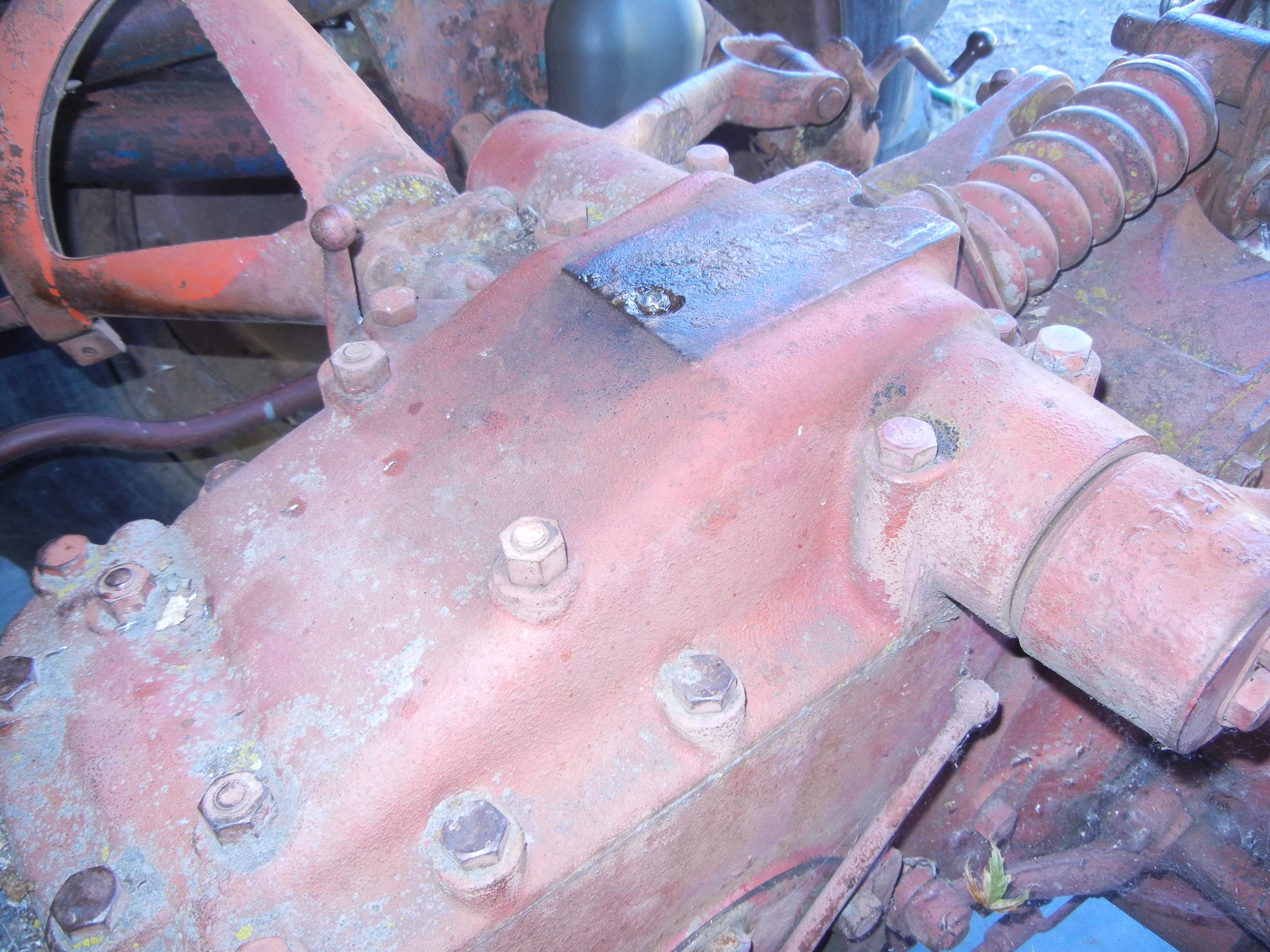

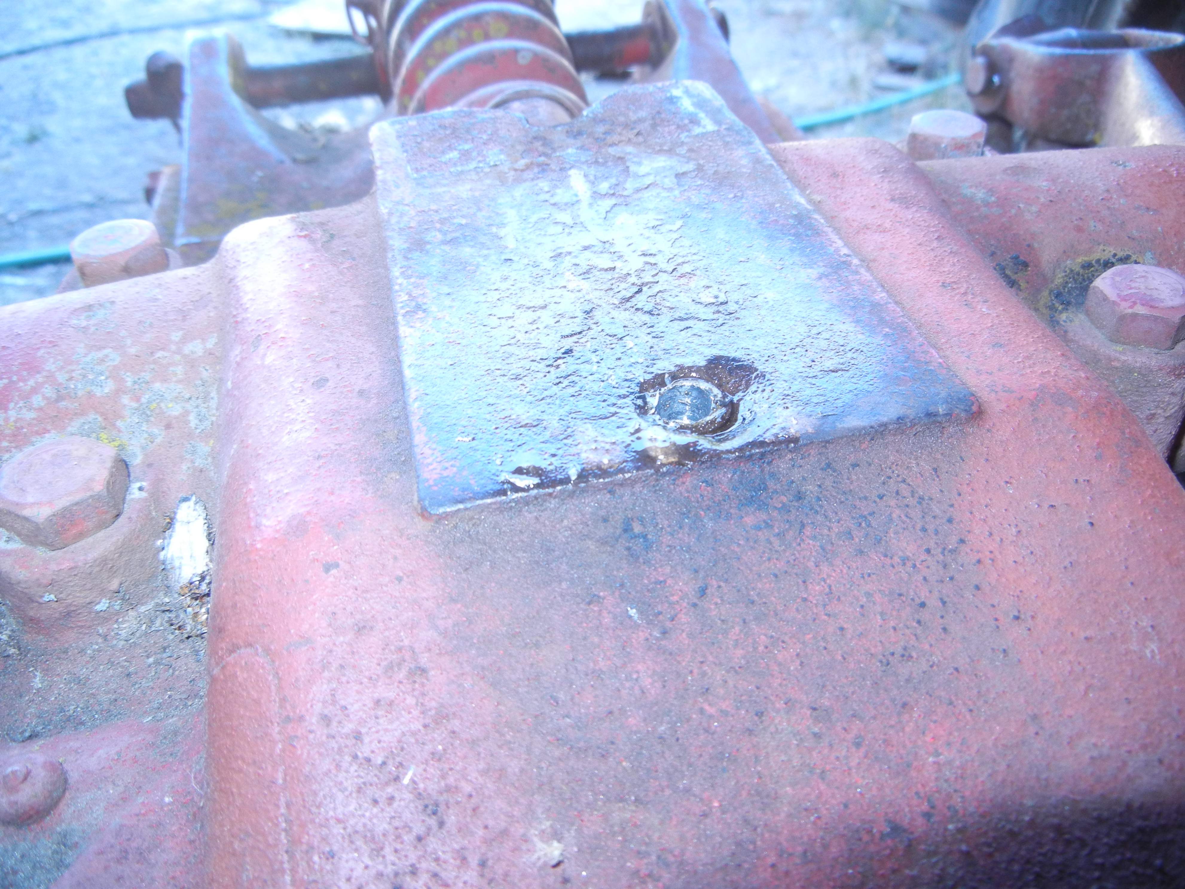

The rear one looks to be a through hole.
I am wondering would it be easier to remove that top section from the transmission?
/ broken Ford 8n seat bolt #5
lay a washer around the hole and weld the shank to the washer, now law a big nut on the washer flange and weld the inside center ( stud shank ) and edge of washer tot he large hex nut.
after the red goes away, but still hot.. try to turn it out with a impact wrench set to LOW , lowest power... the heat helps.. and the hammering helps.
I use an impact on things that i think may shear on a straight pull..
/ broken Ford 8n seat bolt #6
ps.. you could also die grinder around the shank a bit and just go right to the nut and skip the washer..
/ broken Ford 8n seat bolt #7
I am with SG on the washer and the nut. My welding is not the greatest and I usually have better luck that way than welding inside the nut
/ broken Ford 8n seat bolt #8
Take a punch and split it at thinnest point then chip it out in pieces.
Sent from my Samsung SPH-L710 using TractorByNet
/ broken Ford 8n seat bolt #9
i doubt it will chip out. at best, if oem, it was a gr5 equiv bolt. i'd almost say turn it out with a chissle.. but i bet if it stuck enough to shear.. it's in ther eand the chissle will just make it shorter and harder to weld too ..
/ broken Ford 8n seat bolt #10
It would come out, split it, then take the chisel and work on it where it is split. It will curl up and come out.
#11
Thanks for all the replies. I will probably have to try that welding technique, one question do you think it would be doable for a novice like myself with a stick welder? It was a grade 5 bolt as you said.
/ broken Ford 8n seat bolt #12
stick is the only welder i own.. it's what i use..
just turn the penetration down a bit.. maybee use a 6013 rod..
