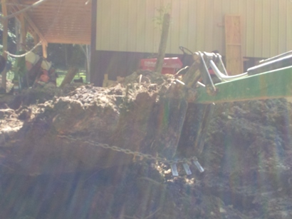

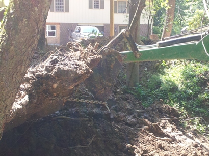

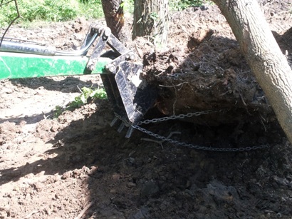

I bend the bucket cylinder rod on my John Deere 48 backhoe. I was pulling a stump out and and was driving the tractor & dragging it. The cheapest rod I could find is on 'Green Farm Part" for $224. How difficult is it to rebuild the bucket cylinder? Are there any special tools needed. I'm hoping that the only broken part is the rod, but I guess I won't know until I take it apart. If someone can get me some repair instructions, I would very much appreciate it. Also, the part numbers found are M138577 for the rod only & MP19268 for the cylinder - can some one verify these.
OK, so I was an idiot & do know better. I guess I was lazy & did not want to do it the hard way (knock clay off of stump, cut apart in pieces w/ chainsaw (and burning up a couple of chains in the process). Now that I got that out of the way, I know that you are not supposed to tow w/ the backhoe. However, towing w/ the FEL is not any better. So, how do you tow with the backhoe & FEL attached? Would it be OK to weld some chain grab hooks or D-rings to the base of the boom arm (down low close to where it attaches to the subframe)?
Man, I am pissed at myself for being so stupid. Anyway time to get fixin'. At least I don't have to worry about getting a ticket from the safety police.

Take the cylinder to a local hydraulic shop, they can probably rebuild it for cheaper than you can buy the direct replacement dear parts.
You can look through the forum and find pictures of rods bent just like yours, and they were just digging with the hoe. I think the old Backhoes cylinders were sized a little small.

I think that any time you leave a cylinder extended
like that and put it under forces you take a risk of
damaging it.
I wonder if you had retracted the cylinder, and got your
chain so it was pulling from the boom instead of
the bucket if you would have had better luck
either way, expensive lesson learned.

Your pretty close. After calling around all hydraulic shops, the best deal was from John Deere. The rod is $244, seal kit is $50 & he's estimating 1 hr. of labor. Surprised that what he is charging me for the rod is about as cheap as anything I could find on the internet.

Got it fixed at JD. $244 for rod, $51 for seal kit, $18 for freight (overnight part delivery) & $46 for labor. Grand total $367. The cylinder was a little beat up from the rebuild, but as bent as the rod was, I have to believe that the cylinder was a bear to get apart. The rod has two bends - one hard (30 degree) bend outside the cylinder where it was extended, and another smaller bend (10 degree) inside the cylinder (or probably where the rod entered the cylinder). Either way, I'm sure the rod did not just slide out.
