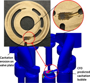

And here is our problem.
Looking at the pump's valve plate, you can see erosion of the metal next to one of
the ports. This is the area where oil is pumped by the pistons at maximum pressure
into the forward port. The reverse port would have sustained the same pressures,
but it got used far less than the forward port, so it was not damaged.
My conclusion is that the oil overheated and boiled at the place where you see the
metal erosion. This was likely caused by the AUX detent valve being ON for an
extended period (perhaps minutes), which forced the full output of the implement
pump through the system relief valve.
DFkrug,
The oil going over the relief would also tend to aerate the oil which leads to cavitation which will erode metal just like in the picture. This would also explain the score marks on the motor since trash from the pump goes into the motor.

Yessir, that's a good point. Indeed, if you look closely, the surface of the wear area looks like inverted craters.

So what about the broken spline, what does that indicate? Any part of cause and effect on this particular HST, or is the manufacturer rebuilding used/broken/returned under warranty, HSTs and selling them as replacement units, possibly?
Are you saying the reverse gearing did not get scalded by the excessively hot fluid from the AUX valve being on accidentally, without the OP's knowledge, and thus did not sustain the level of damage the forward gearing did?
It may be me, but I don't see the wear you refer to on the port(s) etc. I do see subtle scratches on some metals you showed and some darkening of the metal discs in others. Can you possibly circle the exact areas you're referring to, if not too much trouble, for us feeble minded older guys?:confused3:
   / Broke Hydrostat twice? Why? #136
I would guess that foward got used more than reverse while the aux valve was on and that caused the wear (think of it as holding the plate in front of a sandblaster when this was happening, foward got held in front of it longer than reverse, so it wore worse).
This is the reason I really don't like idea of a detented aux valve...
Look at: http://www.tractorbynet.com/forums/...434394364-broke-hydrostat-twice-why-hst_6-jpg
Follow the right hand groove toward the left hand groove and there is an indentation/depression that is not there on the other side.

To me that cavitation erosion looks like the result of low charge pressure or air entrapped in the oil. The port plate wear shown in an earlier picture does look like lack of lubrication probably caused by oil getting too hot; however, my book on "Applied Failure Analysis" says overheated oil causes ash residue on the surfaces and I don't see that in the pic. I tried linking to an illustration of cavitation erosion but it linked to a purchase document rather than to the picture.

Sure was cavitation, I was going ask how it was getting air but Roy posted the reason. Thanks for taking the time to do this for us. It's very interesting and helpful. I almost forgot to thank Bob for getting the unit to you, Thanks Bob!!
