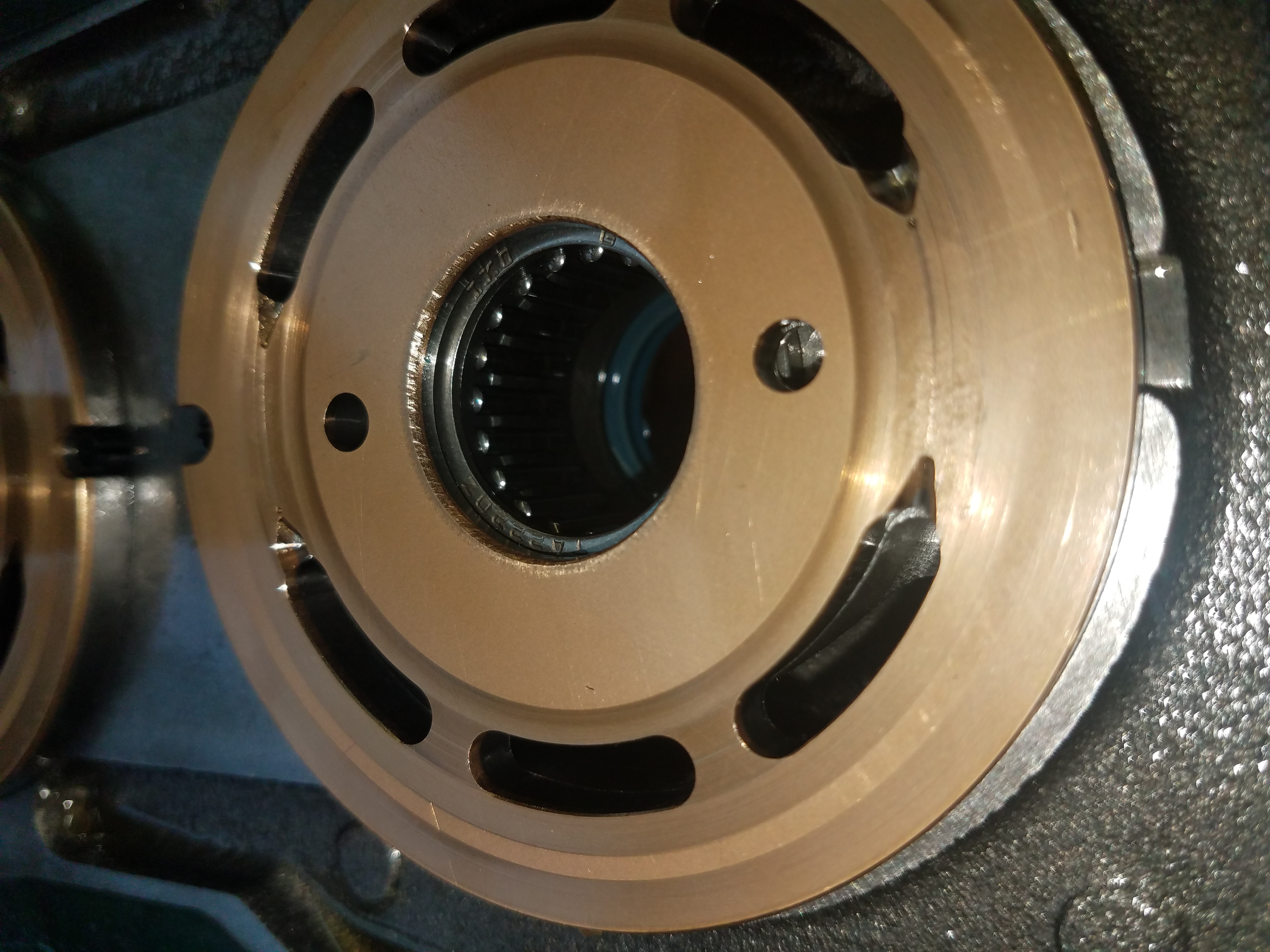

IMO It doesn't look too bad from the pics. If you can't find replacements I'd take a few thickness measurements of the plate with a mic to keep as reference then start lapping. Keep going until the whole face is a nice copper color with no grooves. Use progressively finer grit up to 2000 or so.
For reference, here is a valve plate out of a hustler zero turn that was too far gone.

It looks fixable to me as well. Hard to tell from the pix how deep the wear is, however. The
cause has to be found and corrected first, of course.

Good point. Were you able to measure pressures before tearing into the hydro? Again, it's hard to tell depth from pics but it is somewhat surprising that the valve plate grooves alone were enough for you to suspect a drive shaft failure. Did the transmission chatter when pushing the fwd or rev pedal? Would it move at all?
If the trans has a built in charge pump I would inspect it closely while you have the trans apart.
If it's charged from the power steering pump like my 4400 then you'll have to put everything back together to measure the charge pressure.

The pistons are never supposed to have any surface movement. There's supposed to be a bottom ring + bearing ring + top ring and the top ring is what is supposed to hit the pistons. The top ring should freely slide on the bearing ring so that there's no friction between the top ring and the pistons.
The swash plate should have that sandwich of rings sitting on it. I recently did this and all the parts were available from messicks, it honestly wasn't hard. I will say, your pictures are infinitely better.
   / Broke Hydrostat twice? Why? #188
The pump slippers actually have radial surface movement against the top ring due to the changing geometry as you stroke​ the pump. When the swash plate is flat the slippers travel in a circle, but as the pump is stroked the circle turns into an ellipse with respect to the top ring.
