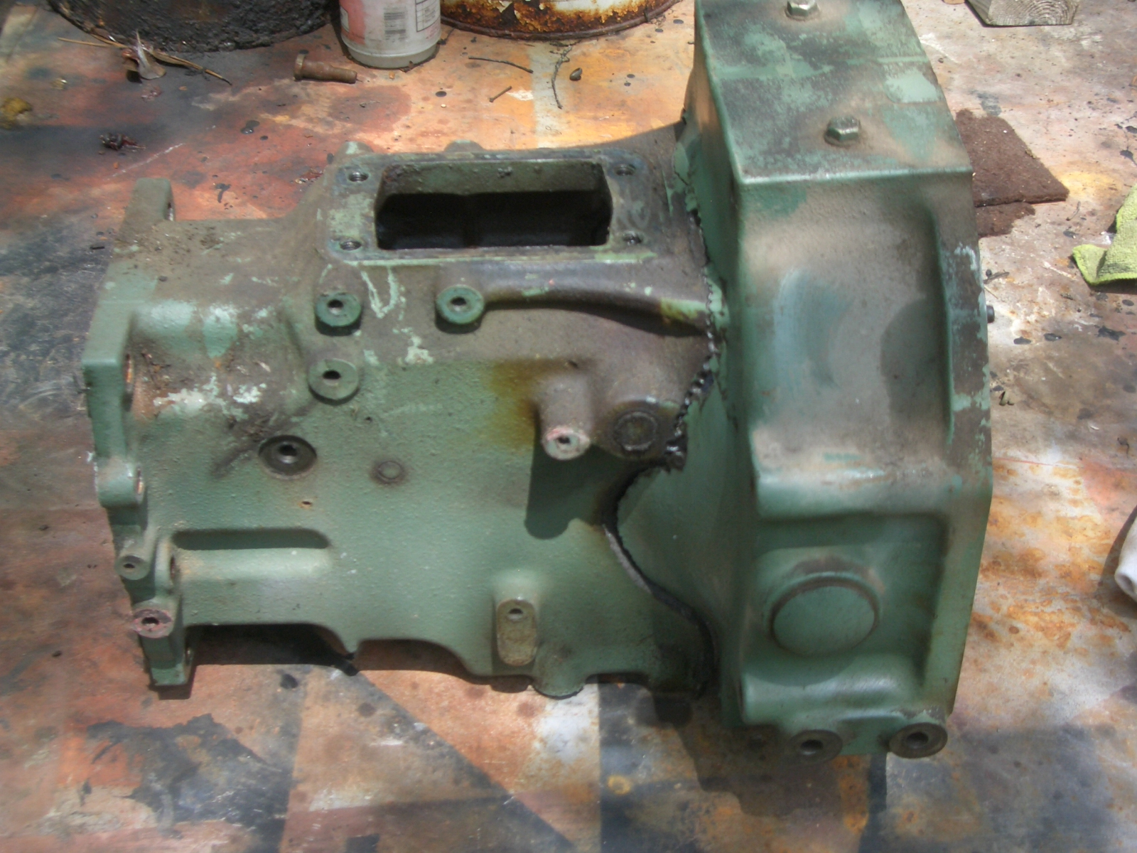

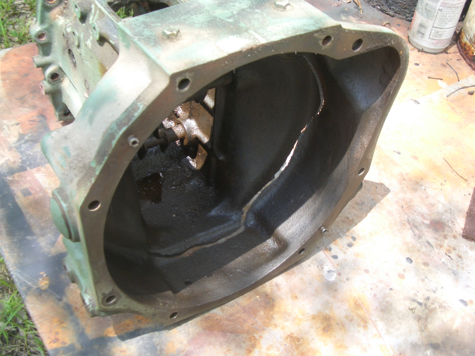

Getting this fixed is proving to be difficult and finding a replacement has been even more difficult. The tractor is a YM1810D . If anyone can help me locate one id be thrilled, figured it be worth a shot asking here. Thanks

Mmm not good. i suspect you will have to get it welded up as a replacement maybe extremely difficult to find. do you have a FEL on your 1810?
/ Broke Clutch Bellhousing #4
Ha! Neat 1500. this was the first thing went through my mind as well,;) isn't the 1810 US version? if there is a crossover for the gray, might be a better chance finding one, ( Parts tractors ) over sea,
Oh yeah! I would welcome you there dsgbraves but it looks like you already been a member for a few years, :cool: with nothing to say:)
/ Broke Clutch Bellhousing #7
There is one out there sitting in some yard somewhere just finding it is the challenge.
A good welder could do it justice but if its being used with a loader he will have to add some decent load bearing braces to prevent a recurrence. That may well be what caused the failure anyway if none are on there now.
It apparently had been cracked before and stitched back together, and with a FEL installed it was a disaster waiting to happen.

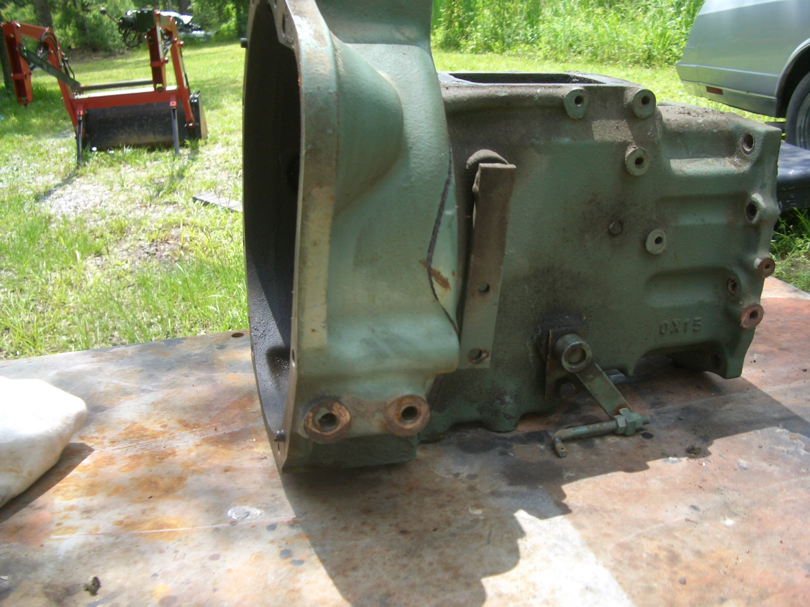

I wonder if the same housing is use for any other YM CUT models in similar size? Is there any No# to be found on it?

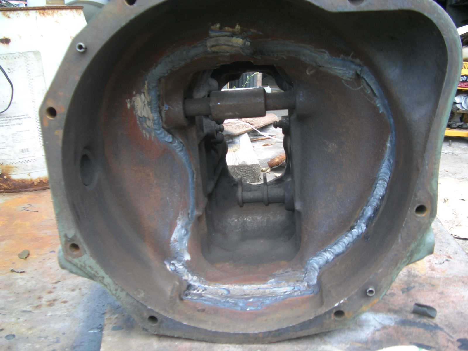

Koyker 80, and no it didnt. My buddy who is welding it for me says he has it all back together. He said it was a real pain. so ill show an update later. Id still like to find a replacement though, since id be leery of re-installing the loader with it welded.
OX15 is the only thing on it.

Did you have him to weld some gussets in on the top corners, and possibly patch weld anywhere else he can find that won't interfere with anything,

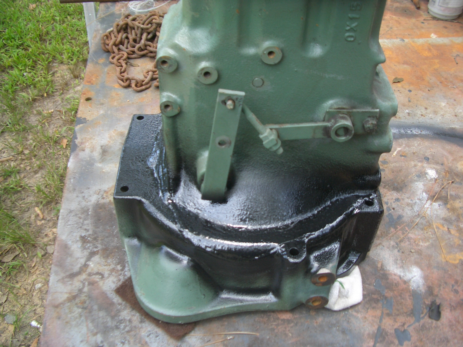

Its not pretty, but its back together. Still haven't had any luck in finding a replacement so this will have to do. wish me luck.
/ Broke Clutch Bellhousing #18
That looks great he did a real nice job! I wouldn't be afraid of it at all but remember what caused it though and Id get him over to help you fab some good braces and you will get another lifetime out of it. good luck :thumbsup:
/ Broke Clutch Bellhousing #19
WOW!! That looks Great! I agree Brace it up looks can be deceiving Esp. on just Pics. Should be fine IMO. Esp. now you know "What Not To Do" :D
/ Broke Clutch Bellhousing #20
Thanks for all the recent info on the importance of rear bracing when adding a FEL, I plan on getting one eventually so that's good knowledge to have. Best of luck with the weld job, it looks well done.
