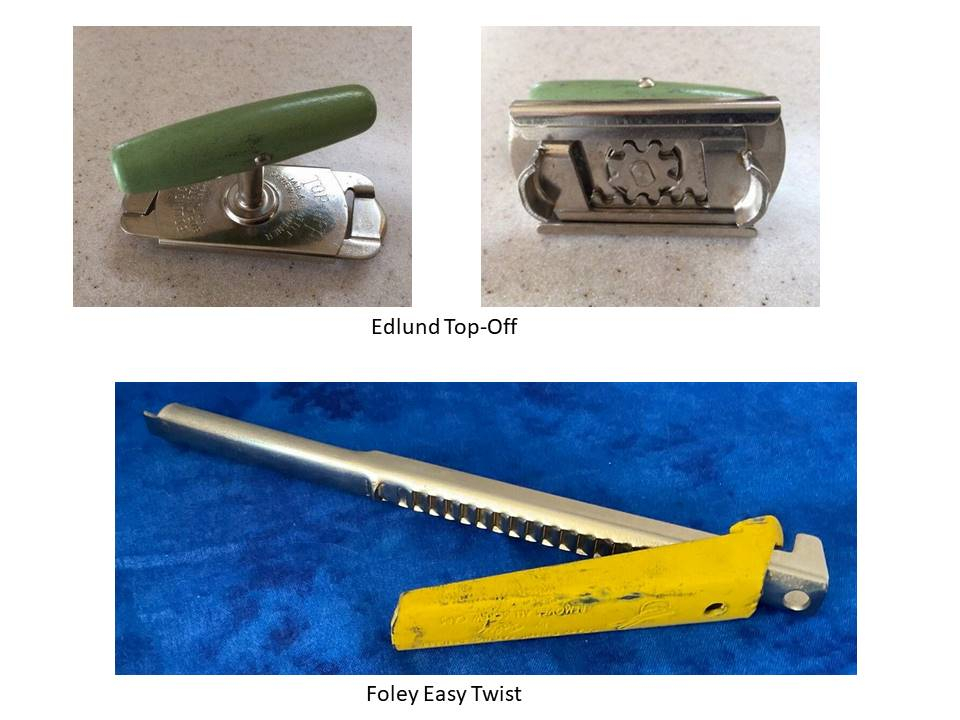

Never seen one of those Lisles, but the design looks great - thanks for posting that. It brought back memories of our kitchen in the sixties. Mom had arthritis in her fingers, so jar lids could be a challenge for her. But in the top drawer, just under the counter, she kept her nuclear options:
The Edlund is what I first thought of when I saw the Lisle. Dual racks & single pinion running gear - for a six year old with an abnormal interest in gears it was hypnotic.
If the Edlund couldn't free up a lid, then out came the Foley, all chrome and killer hornet yellow. The Foley yielded to no jar. The leverage and resulting grip on a lid was deathly. In Mom's achy hands it shattered a full jar of spaghetti sauce. Like a firearm, it demanded respect. Playing around with it one day, its pinchy parts gave me a blood-blister the size of a penny. If you extended the jaws a bit, it just might make a decent end grabbing filter wrench.
