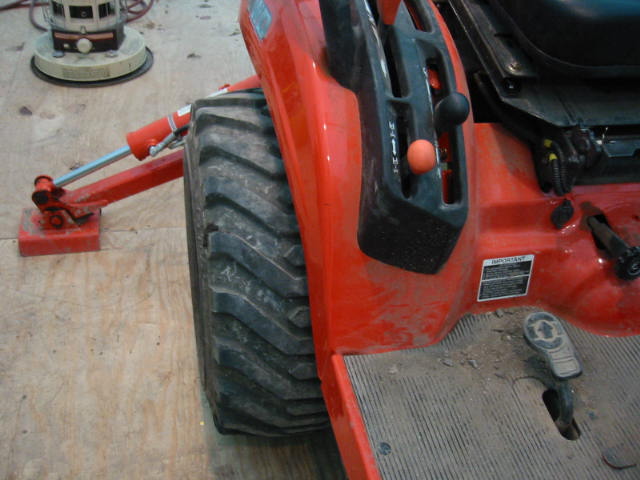

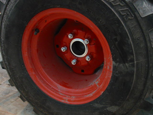

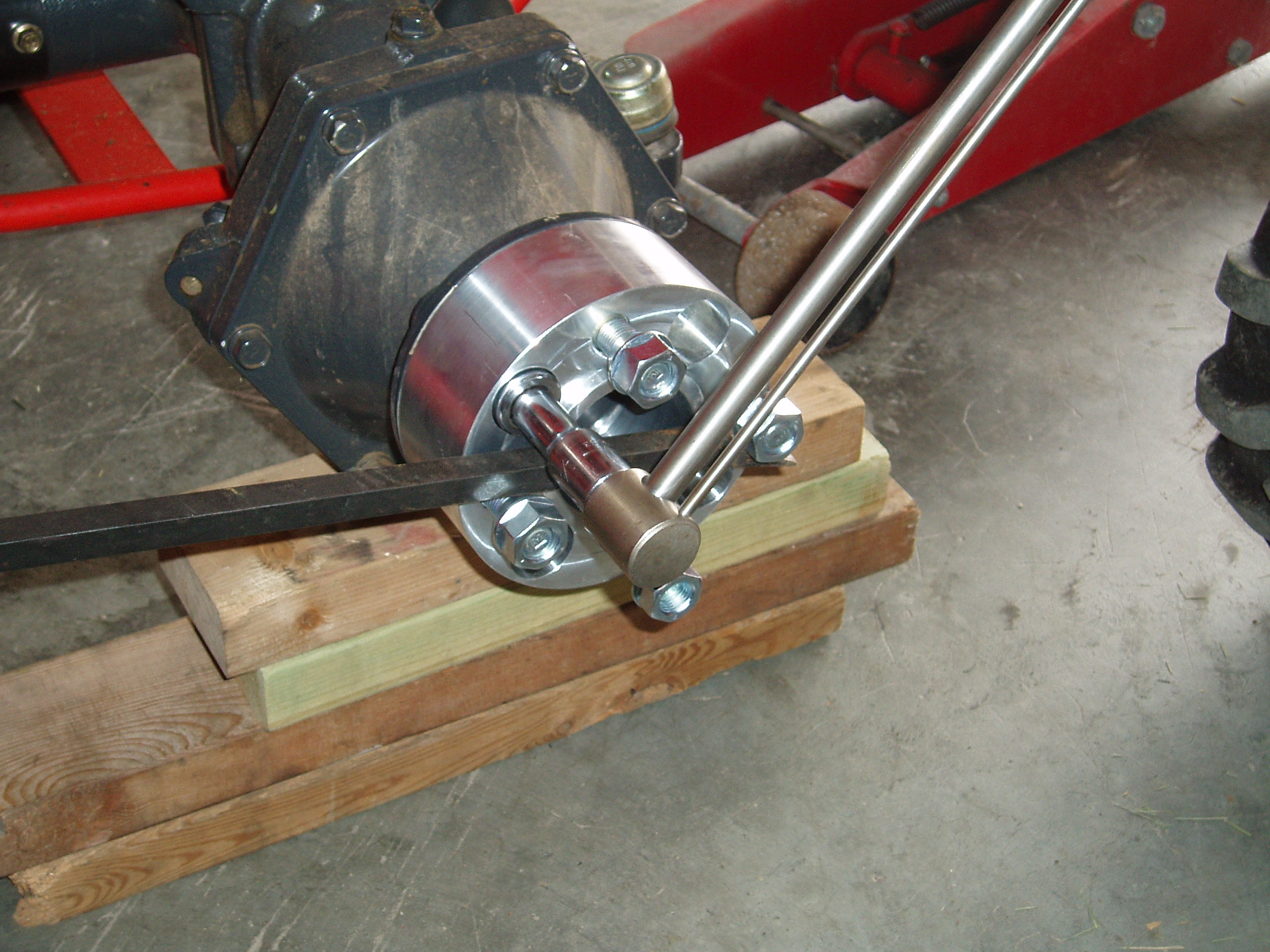

Rainout yesterday so I installed the Bro-Tek 2" wheel spacers on the BX25. If I win the lottery someday I will buy a pair just to use for paperweights because they are just plain beautiful to look at. What precision machining, what a gorgeous hunk of metal! Also started installing the Bro-Tek skid plates, and I'm going back out now to finish putting them on. Hope to get out later today and see how the wider stance feels...it definitely looks cool. I didn't think that an extra two inches a side would really look much different, but it does.
Been thinking about those skid plates for a year now, but imajeepnut's recent thread on replacing the HST fan got me really motivated! :D BTW, the first pic's not mine, I forgot to get the camera out before I put the wheel back on.
View attachment 163473View attachment 163474View attachment 163475
My eyesight is not perfect anymore but,in the picture on the right(I blowed it up to 400%) where the wheel is mounted it looks like the hub centric protrusion on the adapter is way too small.When designed properly,it should match the center hole of the wheel so the load won't be carried soley by the stud bolts.Anyone else notice this?
Was the inside of the adapter machined to fit properly to mate with the factory hub centric?

Depends if it is a hub centric or stud centric designed wheel. Are there conical nuts/bolts?
The reason I drug this thread up,Im installing spacers on my GR2000 to improve stability.
No,the wheels are just flat steel with a 2-1/2" hole center and four oversized holes for the studs,which make for a sloppy mount without the proper 2-1/2" hub centric for the wheel to mount on and center up properly.

The same as in your link-23/10.50/12 rears,yes.Price of the spacers ended up being the smallest portion of this project.Machine work came to $150 for all four of the hub centric adapters :(
Here's what I started with,factory hub w/2-1/2" hub centric protruding out 3/16";
Adapter ring made for the inside;
A sleeve/flange type adapter on the outside for the wheel to mount on.This one was pressed in for a tight fit.
Assembly tightened down to factory hub;
Wheel mounted to new hub centric spacer;
BTW,see those carriage bolts protruding? I used a high strength silicone adhesive on the heads and let sit overnite.Big headache with mounting if not glued in.
