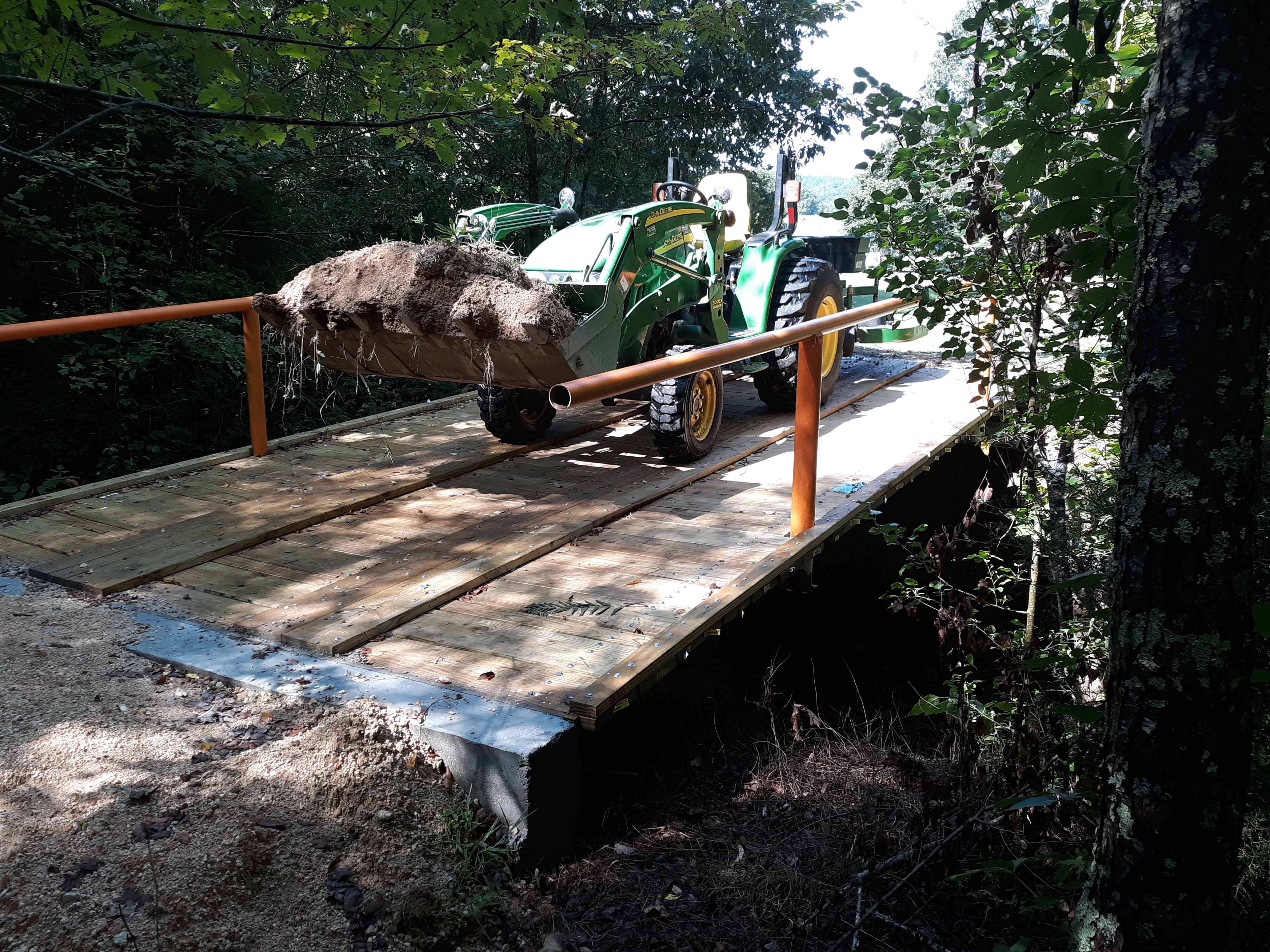

Okay, so I had time today so I gave my new bridge a somewhat real test. I hung a plumb-bob from a center beam to a a little above a rock in the dry creek bed and and took a measurement. Then I drove my JD 3730 with 7' finish mower on it along with a full bucket of fill type dirt and parked in the bridge center. Maybe 5-6000#. Went down below and the height difference was less than an eighth of an inch. I could have read it wrong, but either way it didn't have any discernible sag. I don't plan on driving a 20k unit over it at any time so I am happy with it.

Looks good!
Will.... BE GOOD.....until you buy that full size TLB that many of us would like to have.

Your bridge turned out awesome! Nice work.
You would cringe if you saw the pseudo “bridges” we drove 10 ton trucks over on our various farms in the old days.
   / Bridge I-Beam cutting. #77
Good way to test the bridge. Congrats on a well thought out project!!!
