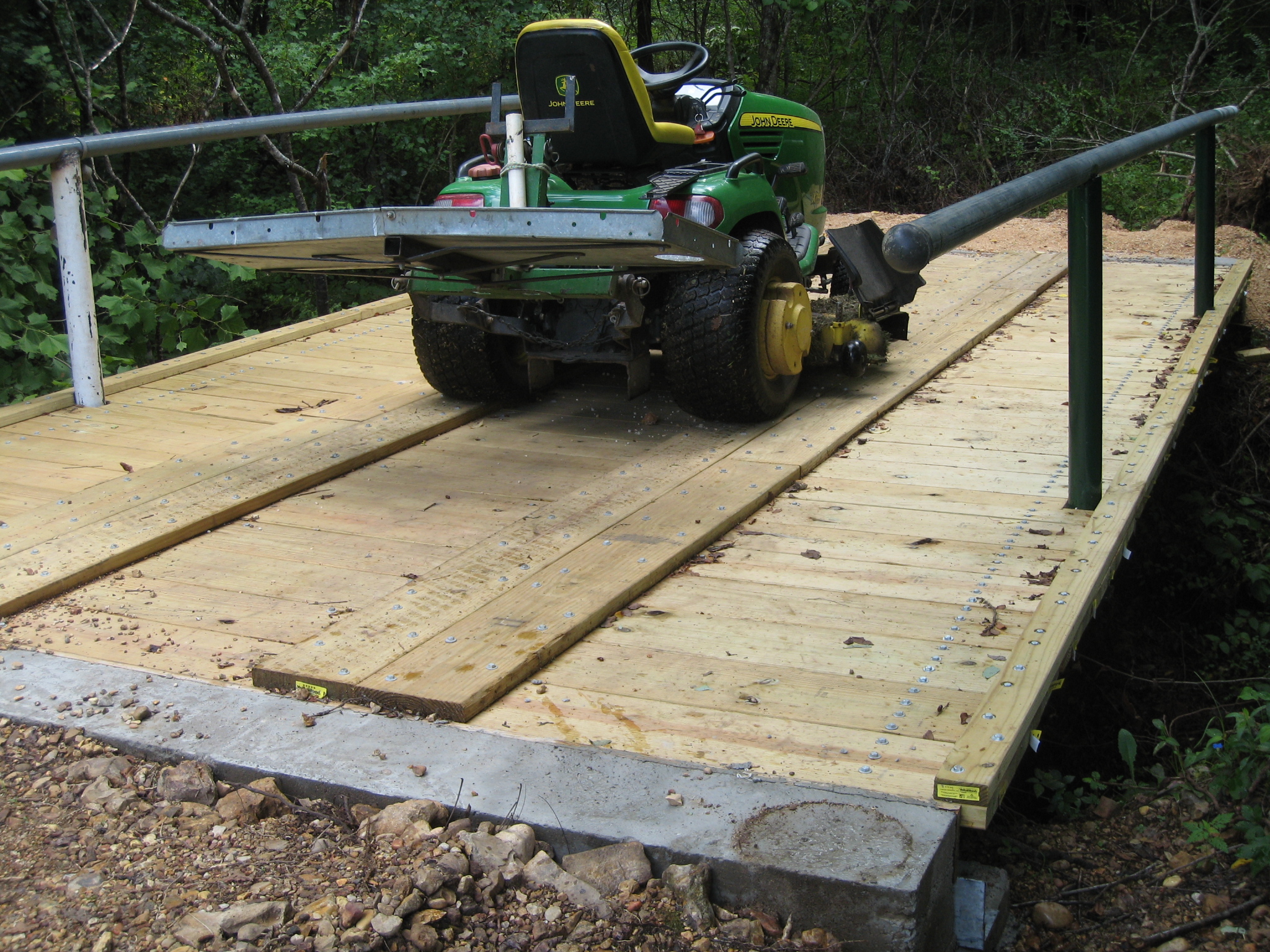

Nice work, Deere Dude. That’s way better than the one’s we built years ago for heavier loads and longer spans.

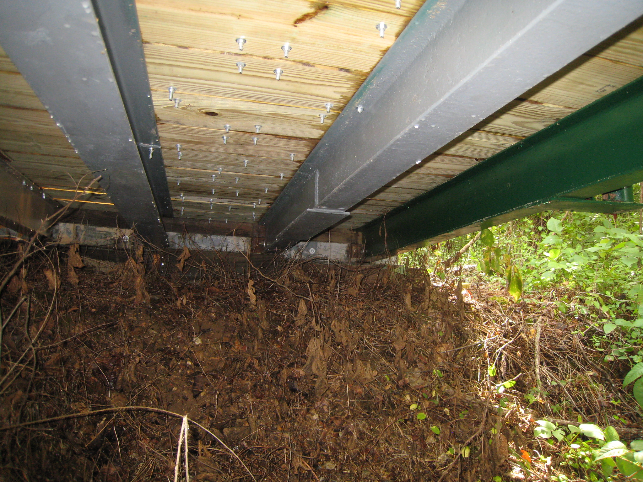

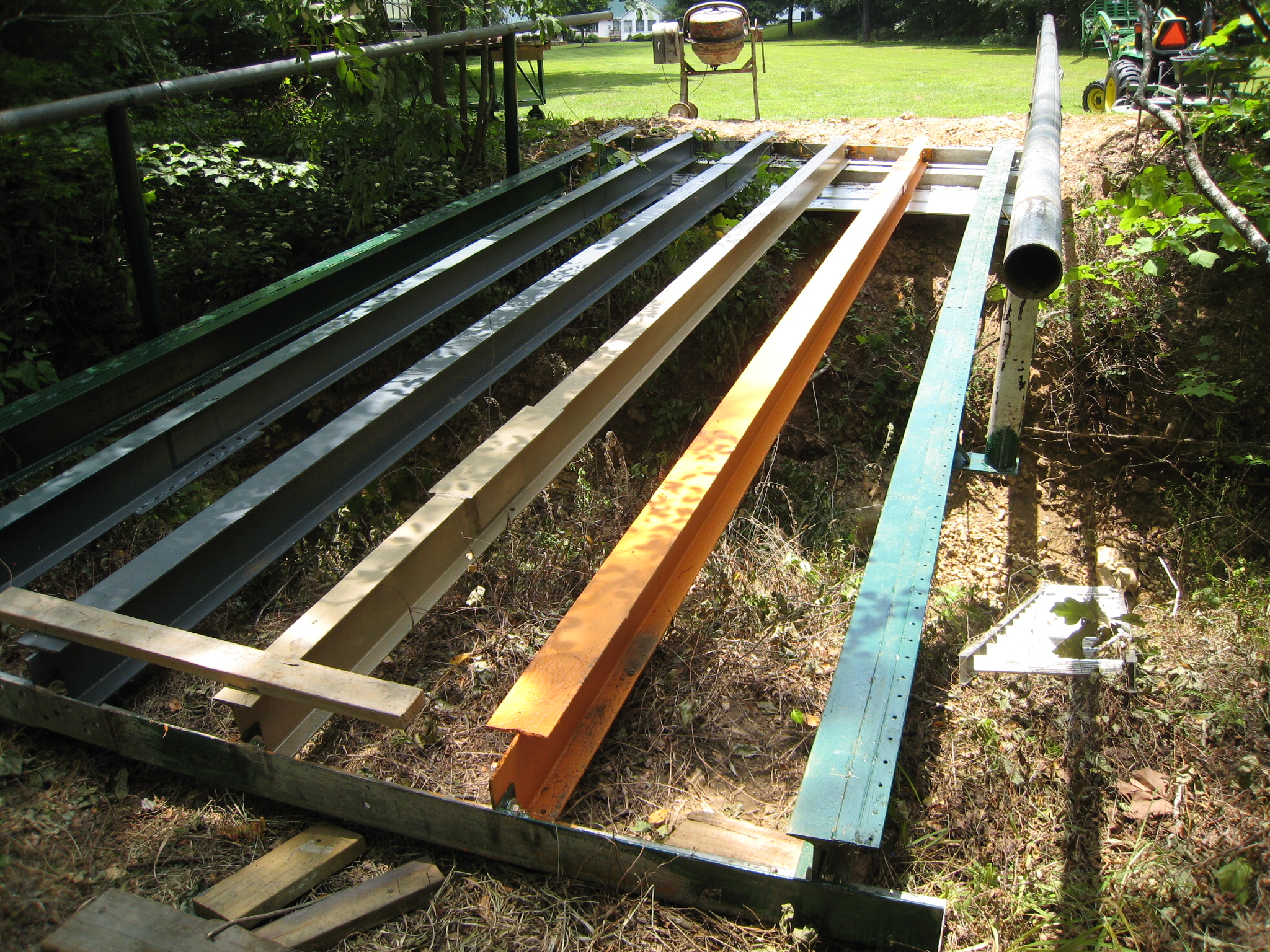

Looks to be 16'-ish long, the I-beams with red arrows look spliced and the green one looks like C-channel with added flat bar............ If it was 25' I would have a 3" pitch in middle. So far looks good, dont forget to post the bridge when it's planked over.

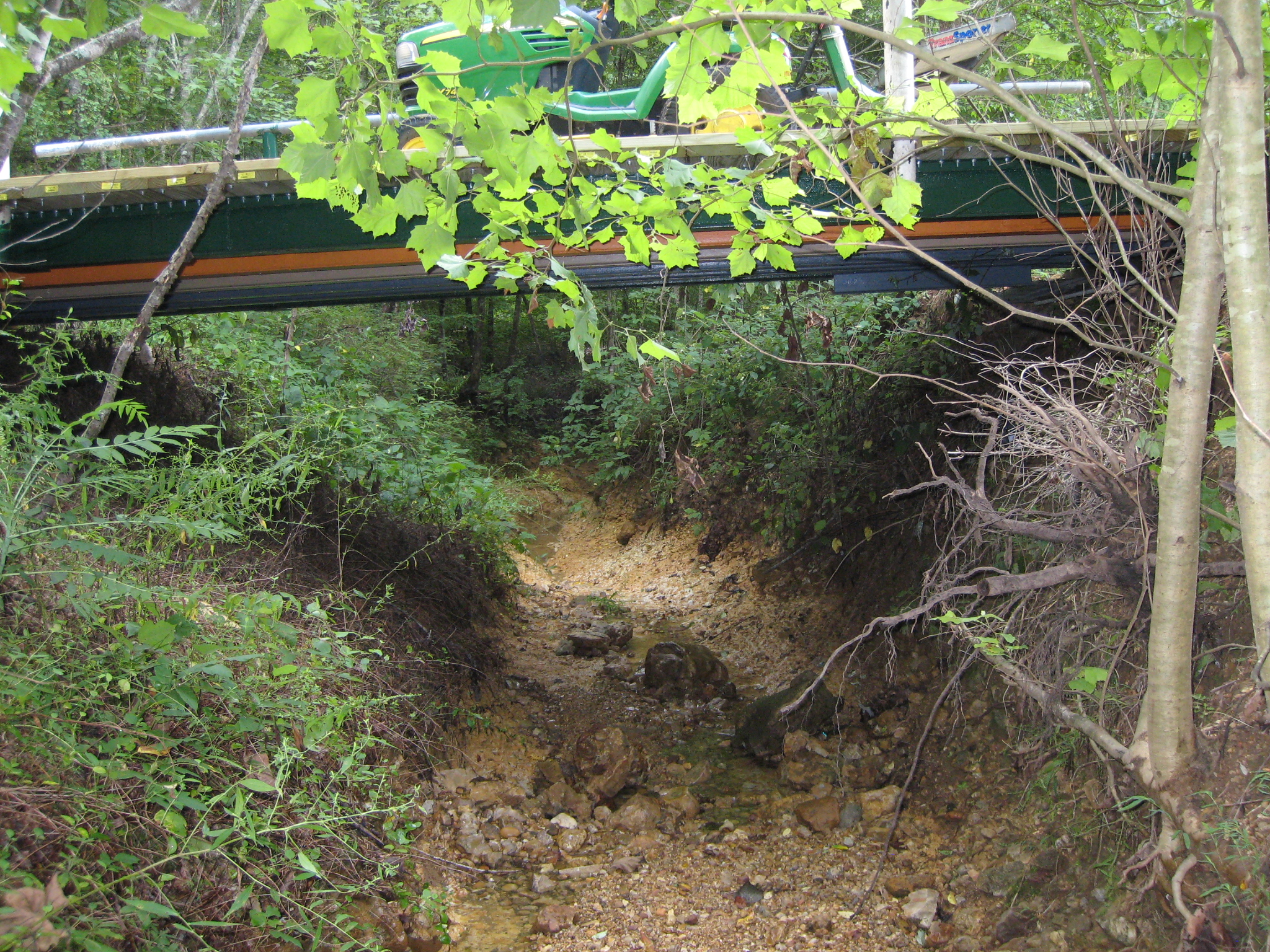

That turned out great. How deep is that canyon?

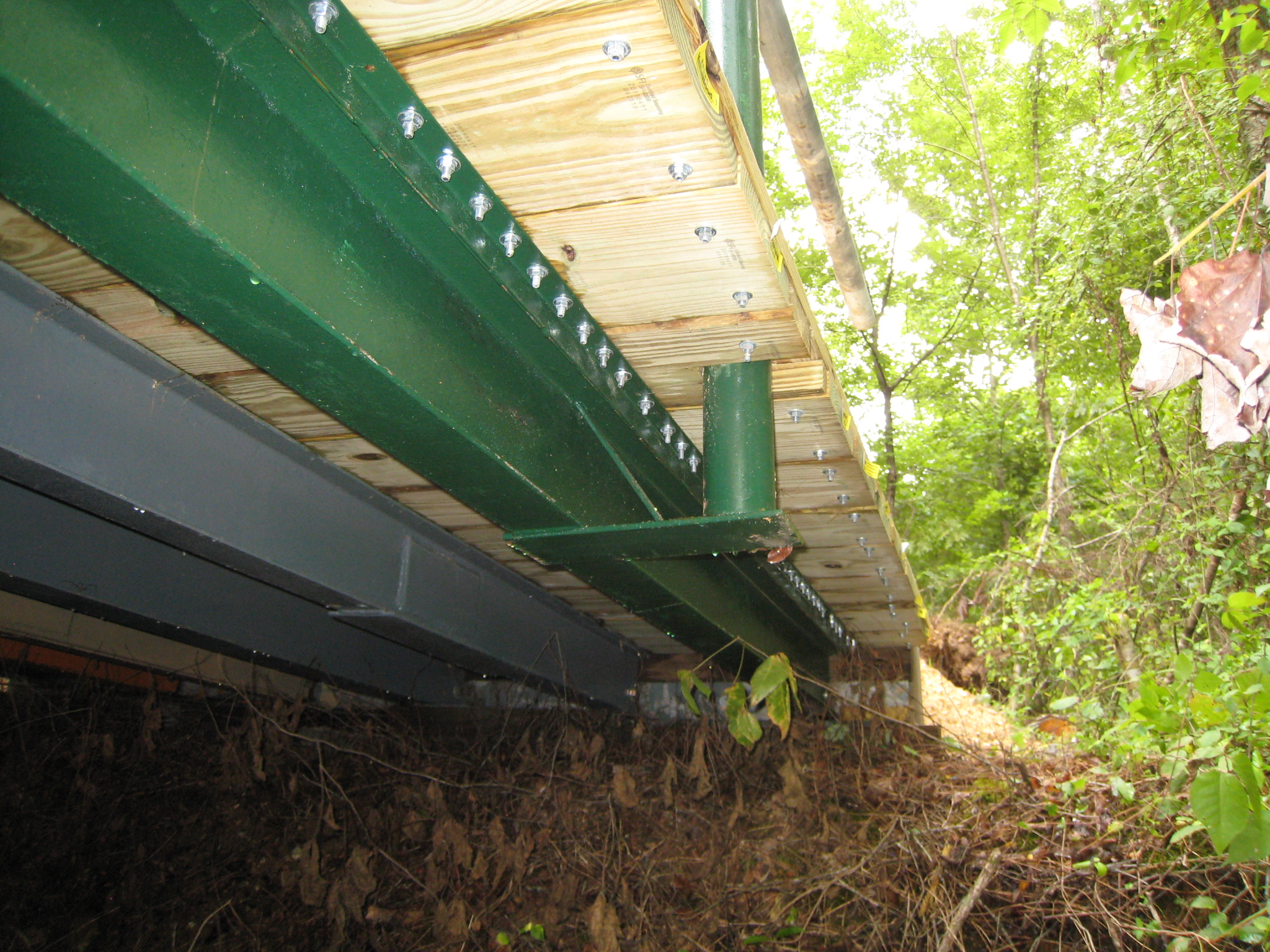

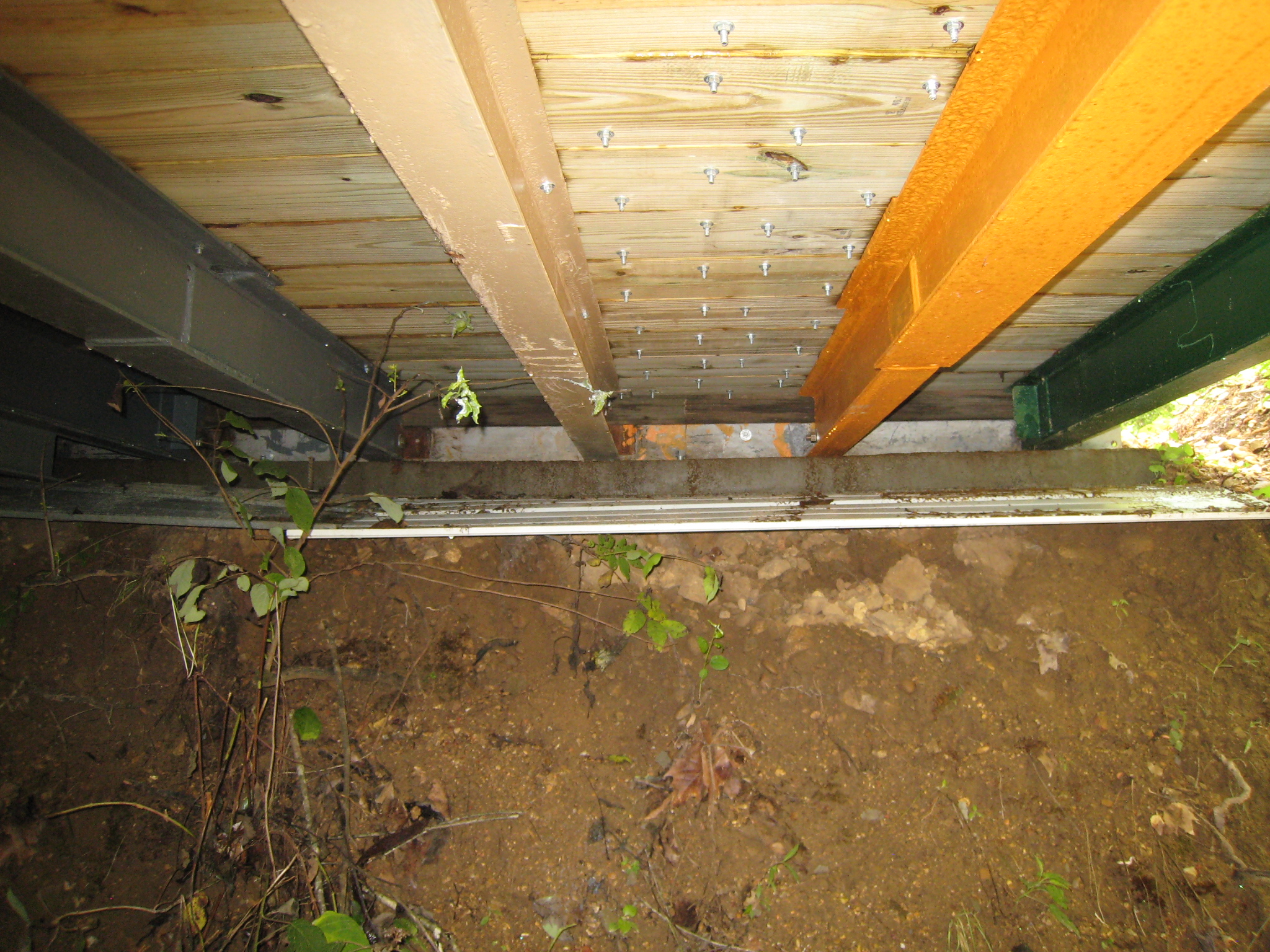

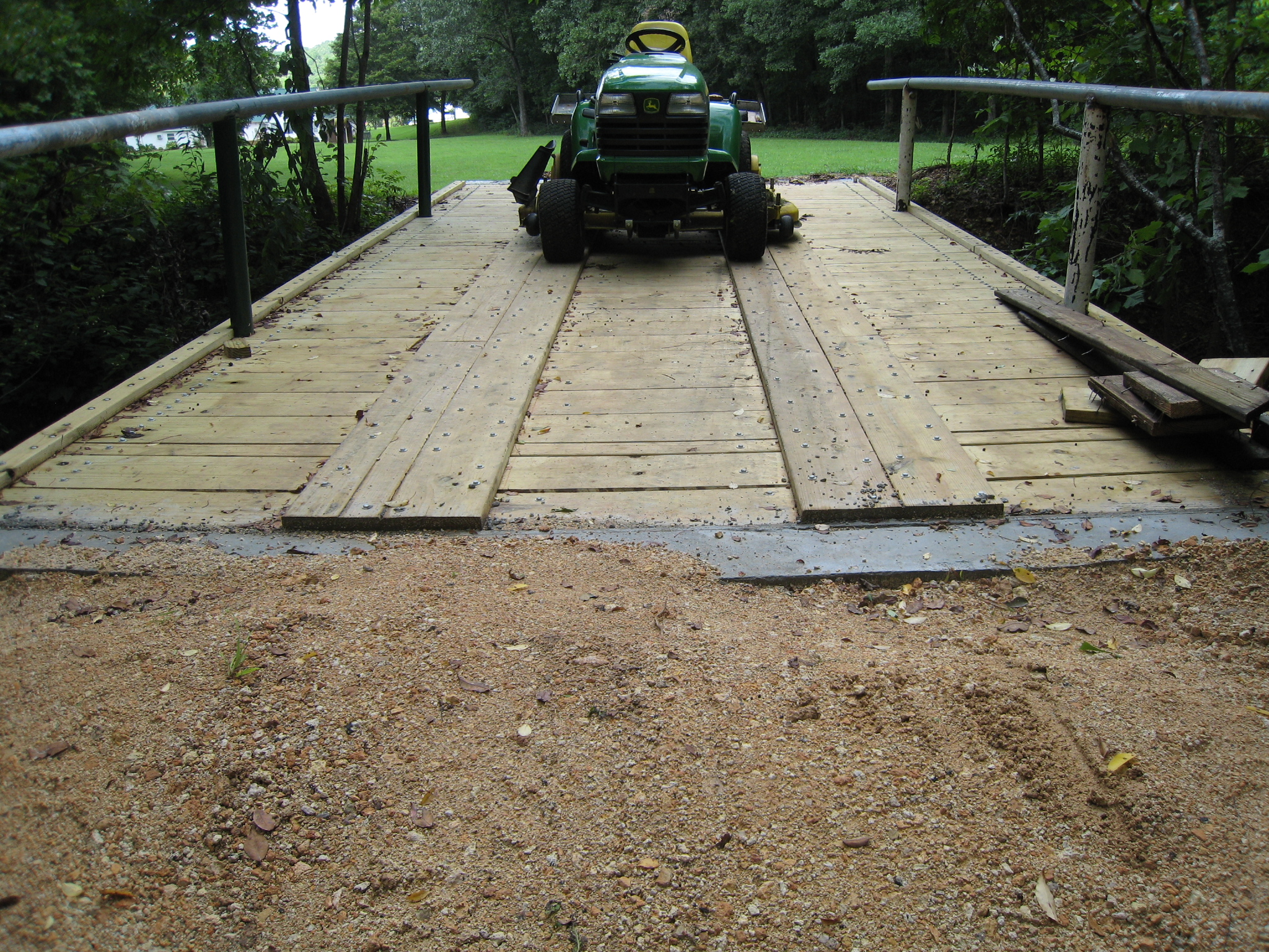

OP here
Eddie; The canyon or gully from bottom to bridge is 8-9 feet. Needed a 7' step ladder to put bolts in center. I used half of an extension latter to get in the gully. I will get a couple completed pics when railing are painted.
Old Path; I can assure you every beam was a 20' I-Beam and every one has a 3' 9" I-Beam piece welded on the end making overall length 23' 9+" using 7018AC rod. Each weld has a 2 foot or so 5 1/2" plate welded on the top or bottom and both sides of each beam have a foot long piece of 5 1/2" plate welded to it. Two beams needed a heavy angle bolted to it at the end so the wood would sit flat on something as in the orange beam.
Both outside I beams have two 1-1/2" angle iron welded together , side to side, with predrilled holes and the angle side without the holes was welded to the top of the beams. From the end view the angles look like a T with one side welded to the top of the beam. This is so I would have a flat surface for bolting to wood. I didn't have any 3" flat stock for bolts so I welded two angles together.
I don't understand the 3" pitch advice. The top end header has a 5" angle iron and was flat but the lower head angle iron warped in the center when welding it together so is lower in the center. When I noticed the warp I left it. Ran out of ambition to cut and reweld. Water still runs off it.
The top end of the bridge is maybe a foot higher than the far end. Flat and level would be better but I didn't want to dig down much on the high end or add much fill on the low end.
