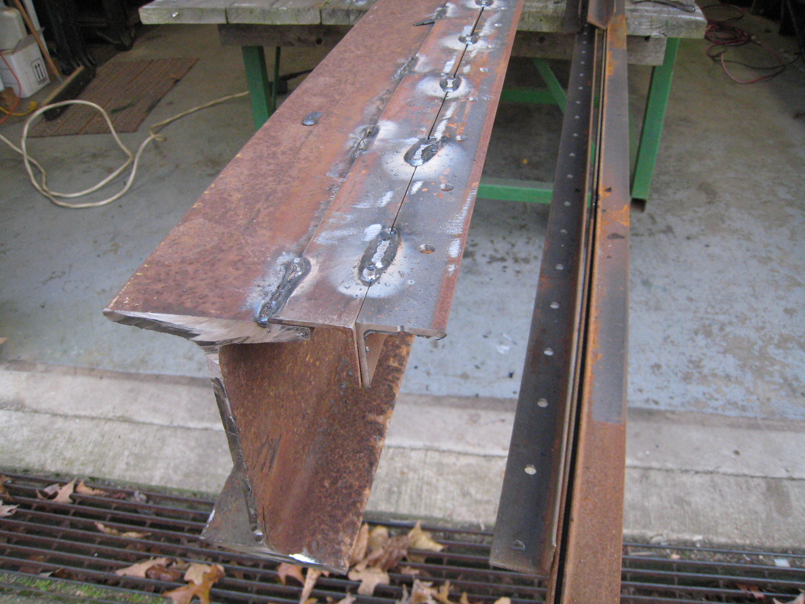

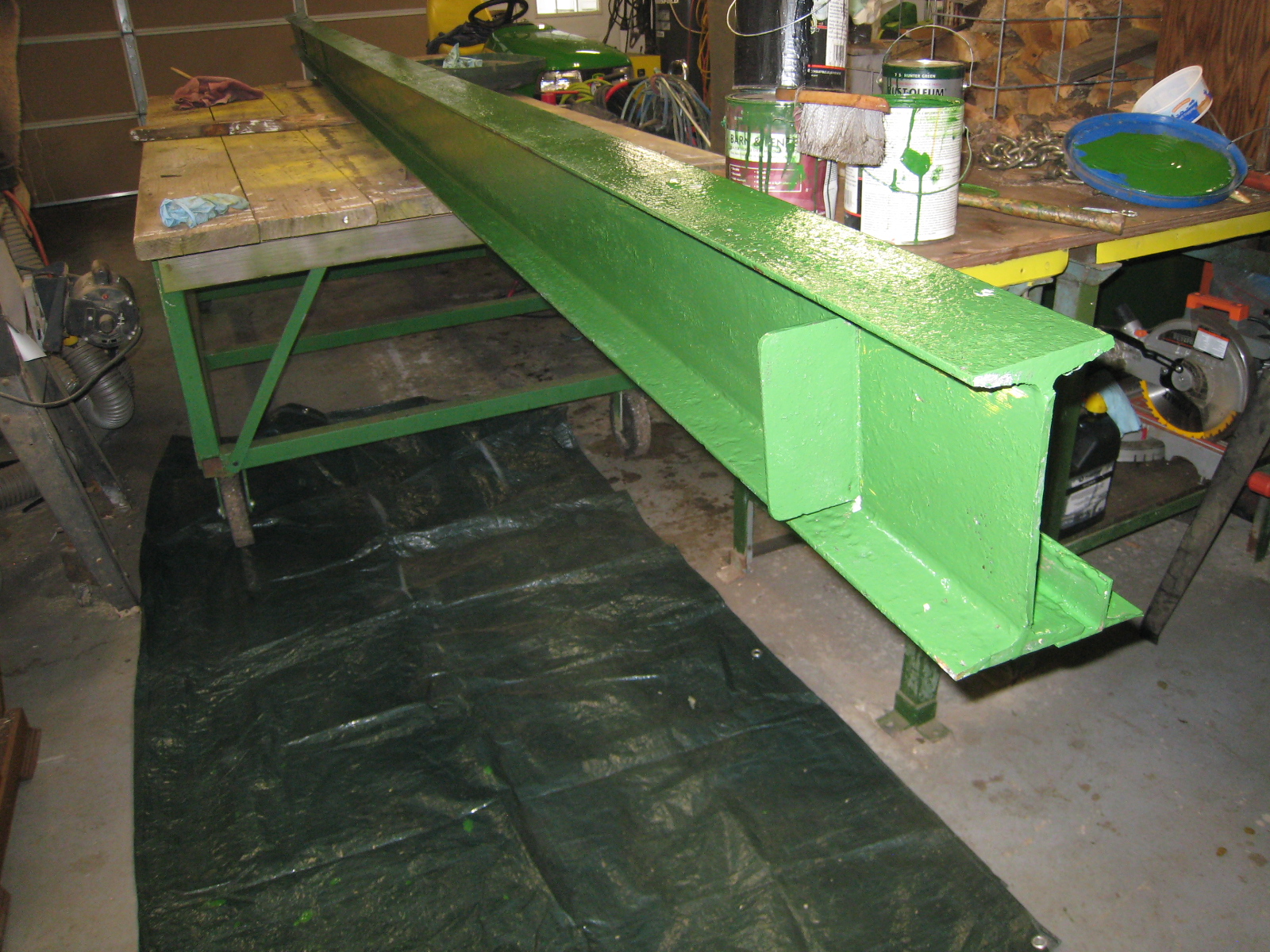

I finally got the beams cut off, squared up and welded together... I used 7018AC rods at someones suggestion and they worked fine for my. I had 10# of 7018 rods that I couldn't make an arc to save my but, so in the pond they went.

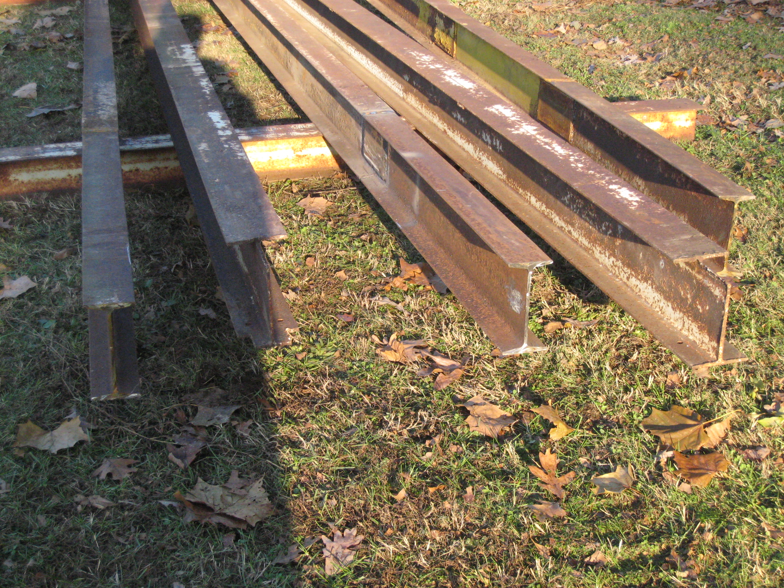

I had some 5/16? x 5-1/2" plate so I welded a 12" piece on each side of the joint. Everything went smooth until I welded some angle iron to an edge of the outside beams. This is for bolts holes to hold down wood. The beam warped sideways maybe a couple inches in the center of a 24' span. The second one I put a chain with a come-along and blocking to hold it straight while more judicious welding and that was a little better, but still warped and inch or so. I will have to figure a way to straighten them out before placing, or maybe not. I set the beam on blocks 23' apart and there is no sag whatsoever so I am happy there.
Now I am wire brushing them, putting rust reformer on and painting John Deere Green of course. Or whatever good oil base paint I have around. The chipmunks won't complain either way.
I will be working as the weather allows in my little garage but want to try to get them painted and then place them eventually, maybe in February.

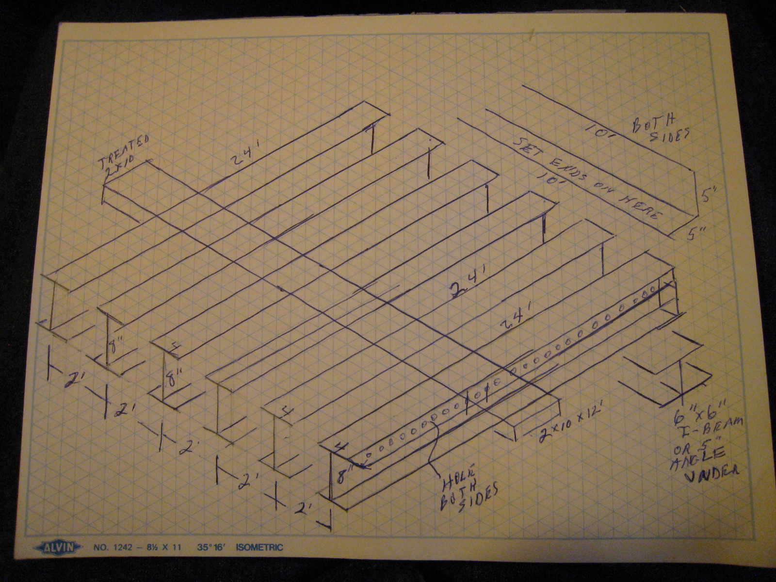

The ends will sit on either a 6" I-beam on concrete or 5" galvanized angle iron. Not sure yet. With angle iron I won't have to go so deep for header concrete. Fot the other end maybe I will just let is sit on the ground and ramp it up with dirt to wood level.
The wife is finally accepting my conglomeration and is on board with it. .
Without pictures it didn't happen so here are a few.
