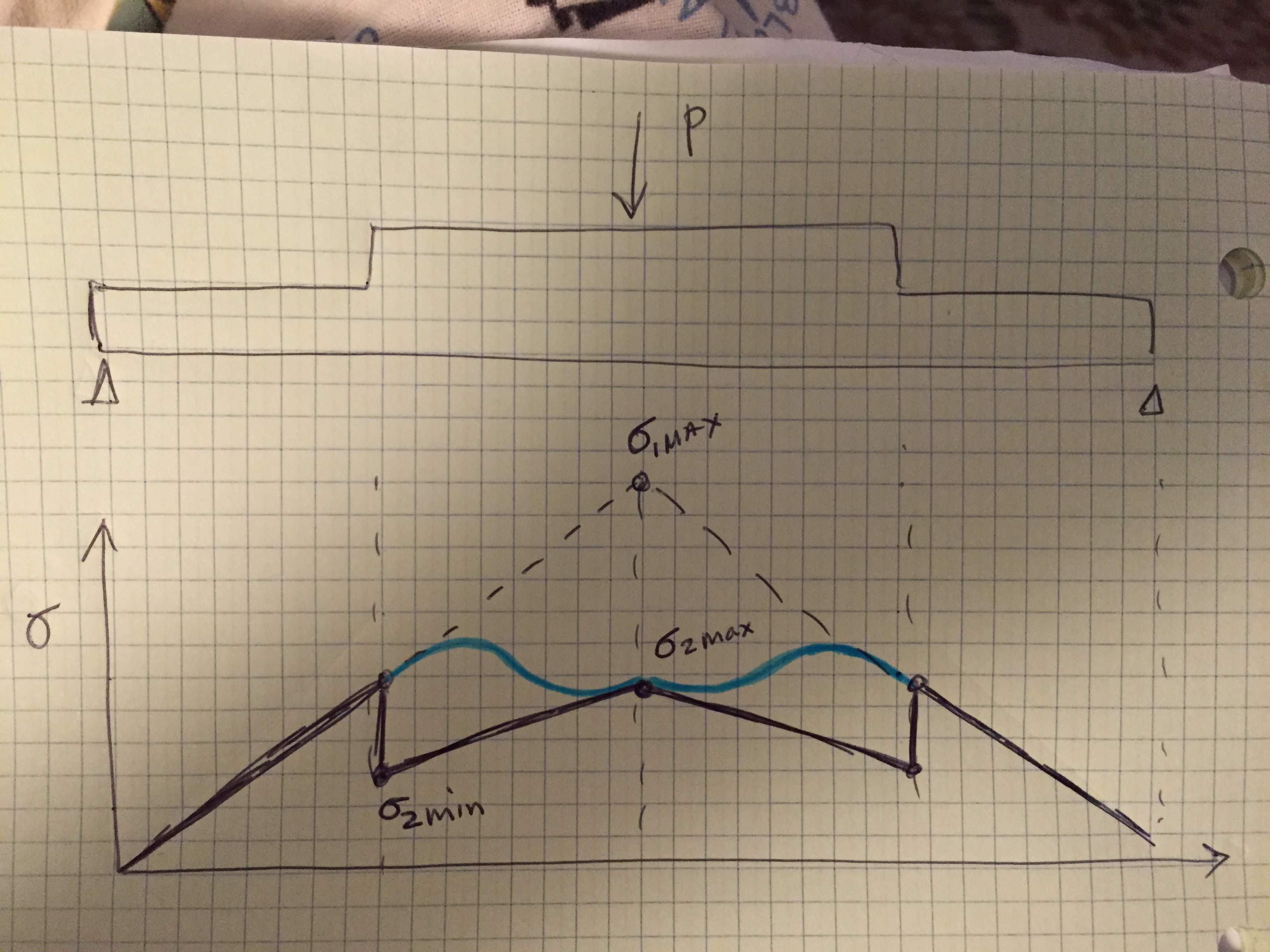

Does the same process apply for calculating stress of a double stacked beam?
Actually, the stress is far simpler -- it's just a function of the bending moment and the beam's local I. In the middle of the beam it would be:
stress = (P * L * H) / (8 * I)
where P is the load, L is the beam length, H is the beam height, and I is the area moment. This will give the maximum tension or compression.
At any point along the beam, with x being the distance from the end, the stress would be:
stress{x} = (P * H *x) / (4 * I)
In the case of a beam that is stacked in the middle, there is a non-trivial transition of stresses where the stacking starts, and that is not something we can compute directly on paper. But you can bracket the problem.
Going back to the example I sketched, I'd calculate the stress for the unstacked beam at both x=L/4 and x=L/2. The first instance is what the stress would be where the stacking starts. The second would be the max stress in the middle if there was no stacking. Let's call the second sigma-1-max on my sketch below.
Now calculate the stress for the stacked beam at x=L/4 and x=L/2. The first is what the stress would be at the stack section if we could miraculously transfer all stresses into the stack, and lets call it sigma-2-min. The second will be the max stress in the middle with stacking, sigma-2-max.
The attached sketch plots what the stress would look like. The actual heights and slopes depend on I1 and I2, but here I just assume I2 is higher so that the slope is less in the stacked section of the beam.
If stresses transferred into the stack perfectly, you'd get the jagged sawtooth profile with a discontinuity. But that won't happen -- initially the lower beam would continue carrying the load, so the stress would continue growing along the dashed line towards sigma-1-max. At some point, probably 1-2 beam heights from the start of the stack, the stresses will blend (blue curve) to the stress profile of the stacked beam. By the time you get to the center of the beam, the stack would be taking the full load over a good portion of the center of the beam. The shape of that transition is what would be hard to compute on paper, but if you could draw this plot with exact inputs for I1, I2, and the other data, you can probably get a good eyeball idea how it will look. That's what I would do, and I'd consider that an 85-90% confidence assesment.
