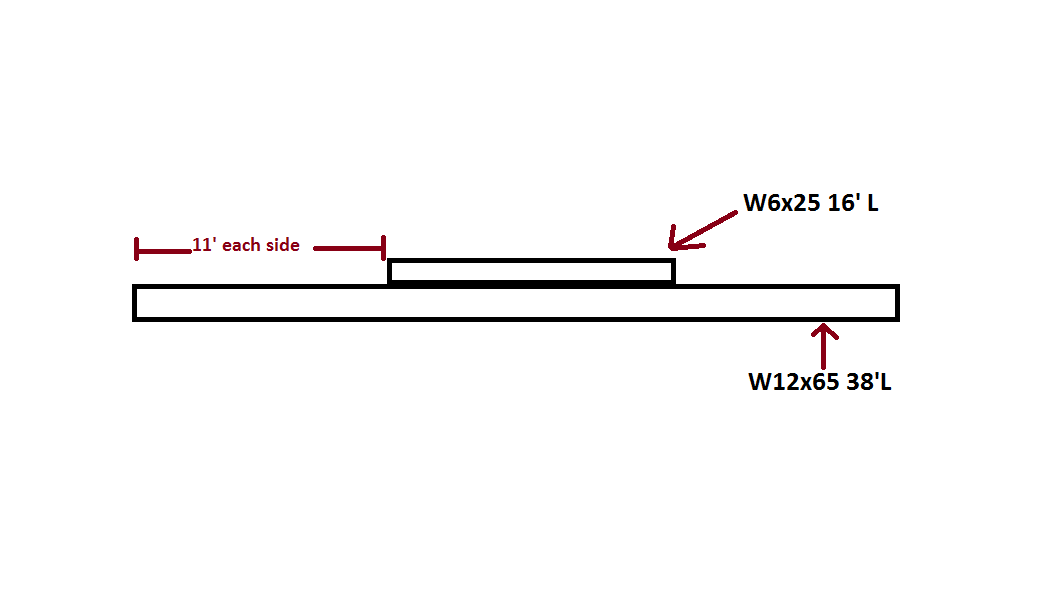

But its a moot point. IF anyone knows how to calculate stacked beams where they are only stacked in the center part of the beam for a given length I am all ears.
IE: like this...

For the portion of the beam of the beam that is stacked. You would calculate loading based on that section. For the portion of single beam you would calculate based on the single beam strength.
If you have noticed bridges with reduced weight limits, this is how the reduced limit is calculated based on deterioration of the steel beams. Different beam section give different loadings

But what if the stacked section were 6' shorter? or 12' shorter? or 22' shorter like my examle? How does that effect total capacity.
Lots of MFG bridge cranes taper down at the ends. The extra mass is not needed there as on long spans, beam shear near the supports is rarely an issue, rather stress and deflection near the mid-point. But where the beam is narrower at the ends....how far can that be cheated out and still maintain full strength? and beyond that....how much increase or reduction in capacity at varying lengths of the second beam?
   / Bridge Crane designs and ideas...38' span #96
For the 11 ft at each end calculate as single beam . For the middle calculate as double beam. You make load chart by combining the appropriate section of the charts from each beam section
You can make as many steps in the beam as you like. I have worked on old bridges with up to four different beam sections. For rating bridges, the beam was rated at the tenth points of each span typically.

For the end 11 ft the beam will have the stress and deflections as if a single beam was loaded for the entire span. The middle will act as double beam for stress , but will have higher deflection. The deflection will be less than single beam though. I hope this helps explain load ratings.

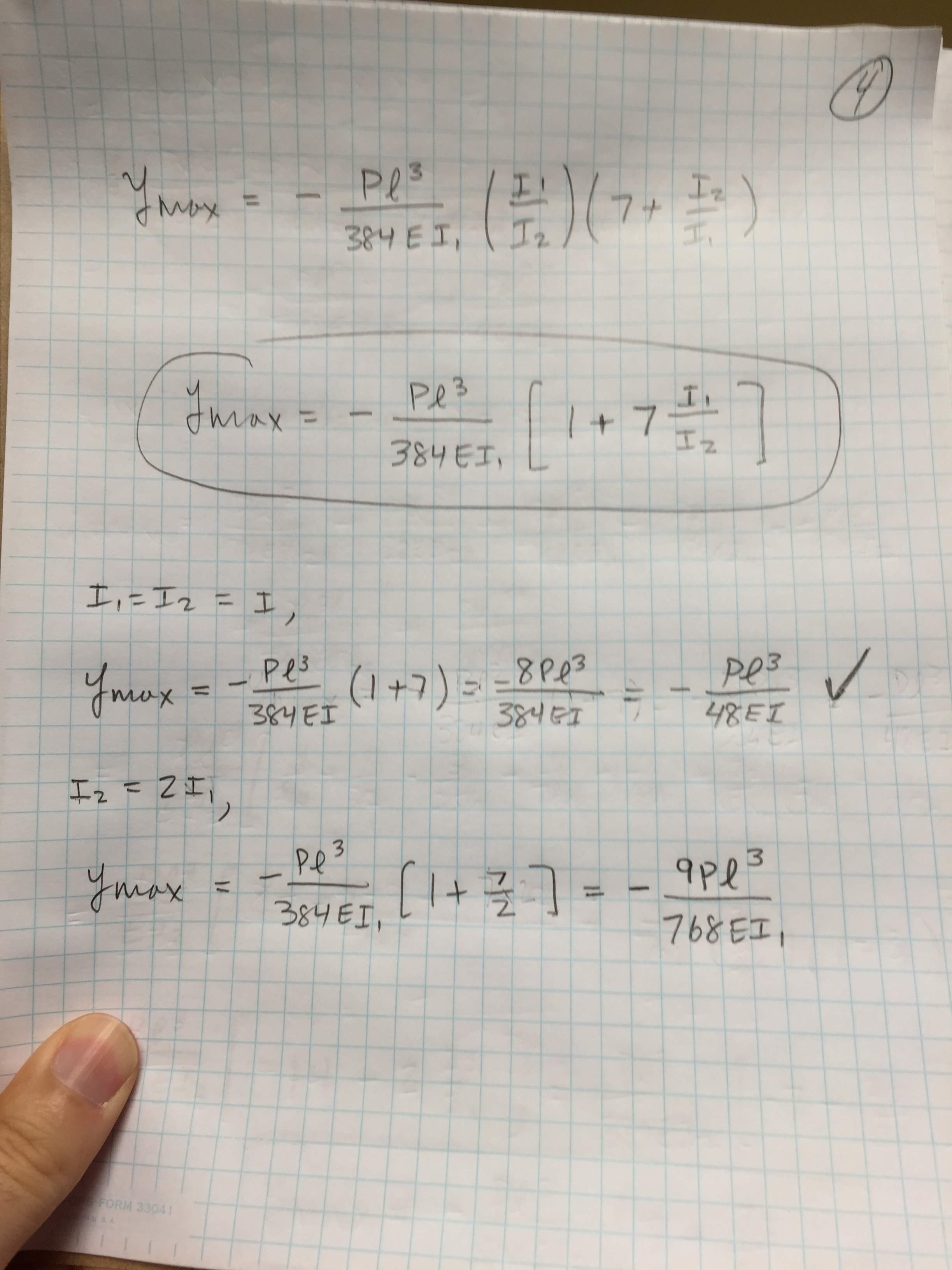

I am still lost on how to calculate the double beams. IF you have the time, could you walk me through an example. Even if its simplified. Like a 20' span and 10' beam in the middle to make things easy.
   / Bridge Crane designs and ideas...38' span #99
Couple tricks can be used for what is basically a beam of variable cross-section.
One way (and this works in both directions) is to replace that double section of beam with something that has the same cross section (I) but assumes a much stronger material. You can use the ratio of I to determine the ratio of E, since they are side beside in most beam equations (i.e., if I is double, then replace with double E instead). However, you would still need to take into account the weakest E at some point, to make sure the actual stresses don't exceed it. This method is often used in reverse for composite beams, say an I-beam with wood lumber sistered in -- I'd replace the lumber with a smaller chunk of steel that has the same net E*I, but later check back to see that the resulting stresses are acceptable for the weaker material -- wood.
The other way is to break the calculation into sections, and label all the unknowns. Draw imaginary saw lines through the point where the single and stacked beam sections meet, and then replace the "connection" with lateral and vertical forces and a twisting moment -- basically, the forces and moments that were otherwise holding the beam together before you sawed it apart. The deflection at the end of the section of single beam will be the starting deflection for the section of double beam. You should be able to solve for all the forces and moments by doing sums in the horizontal and vertical directions, and sums of moments, for each of the sections you sawed apart.
I'll try to draw a sketch if I get a minute today, but hopefully the description makes sense.
   / Bridge Crane designs and ideas...38' span #100

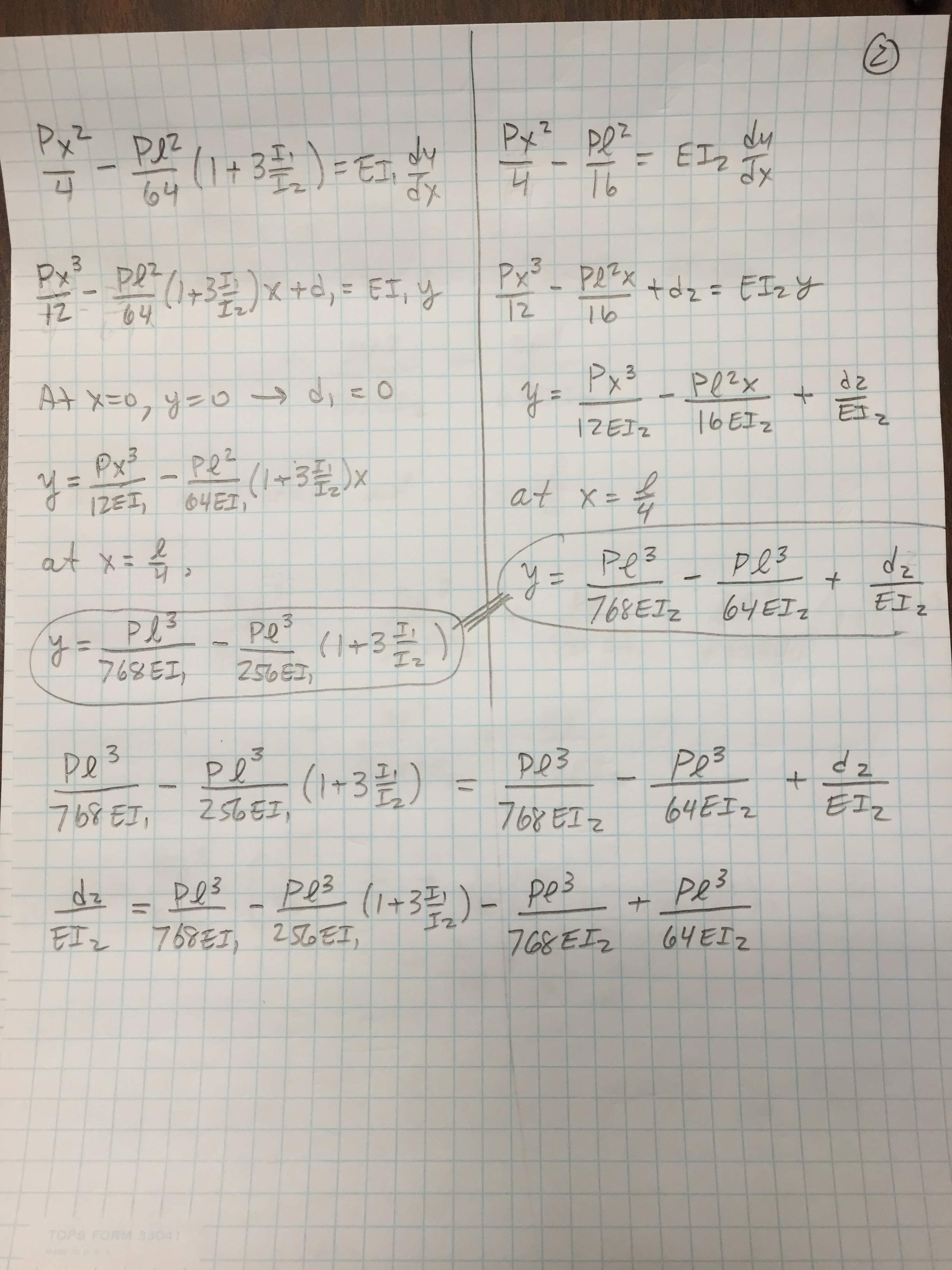

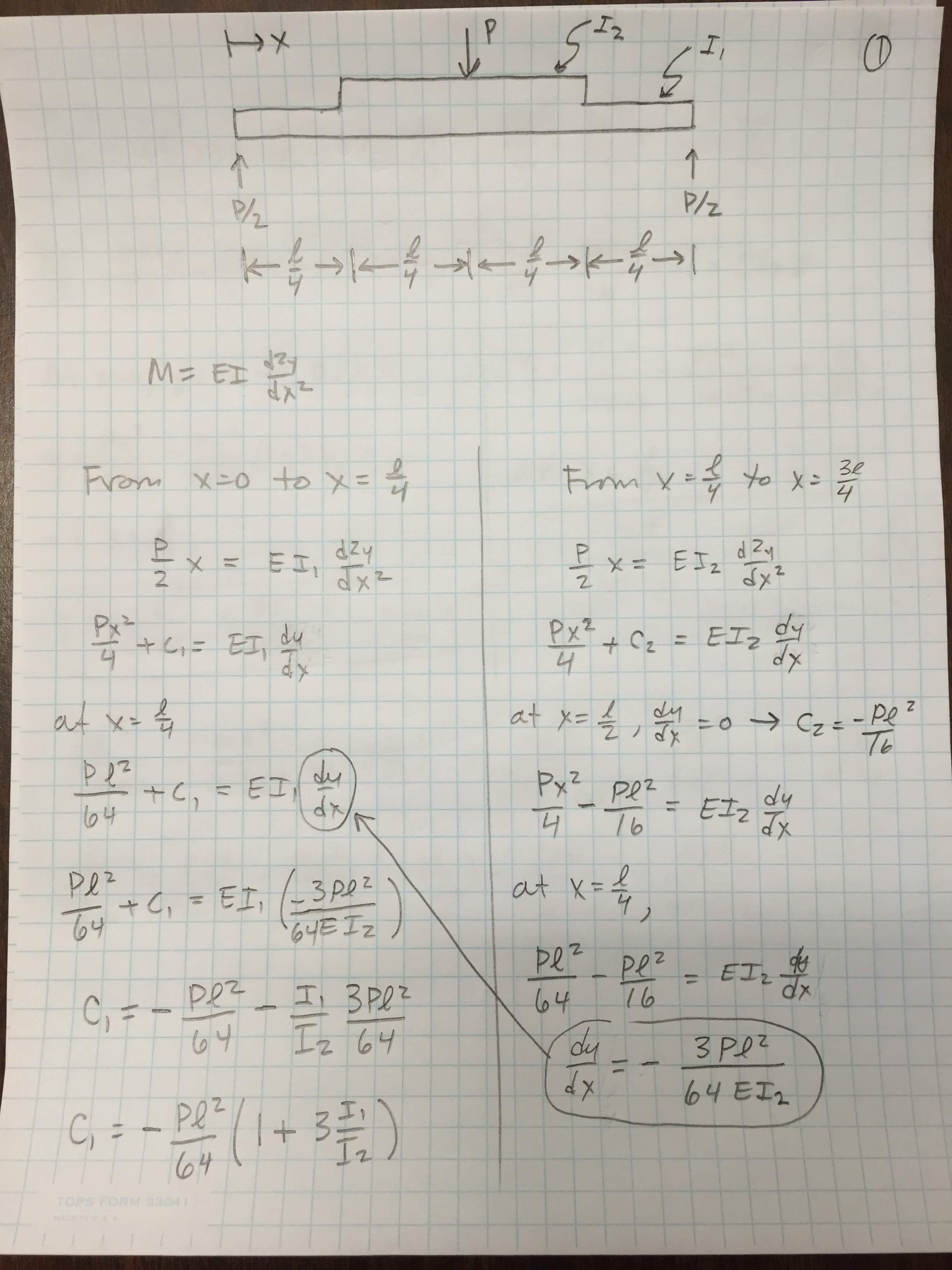

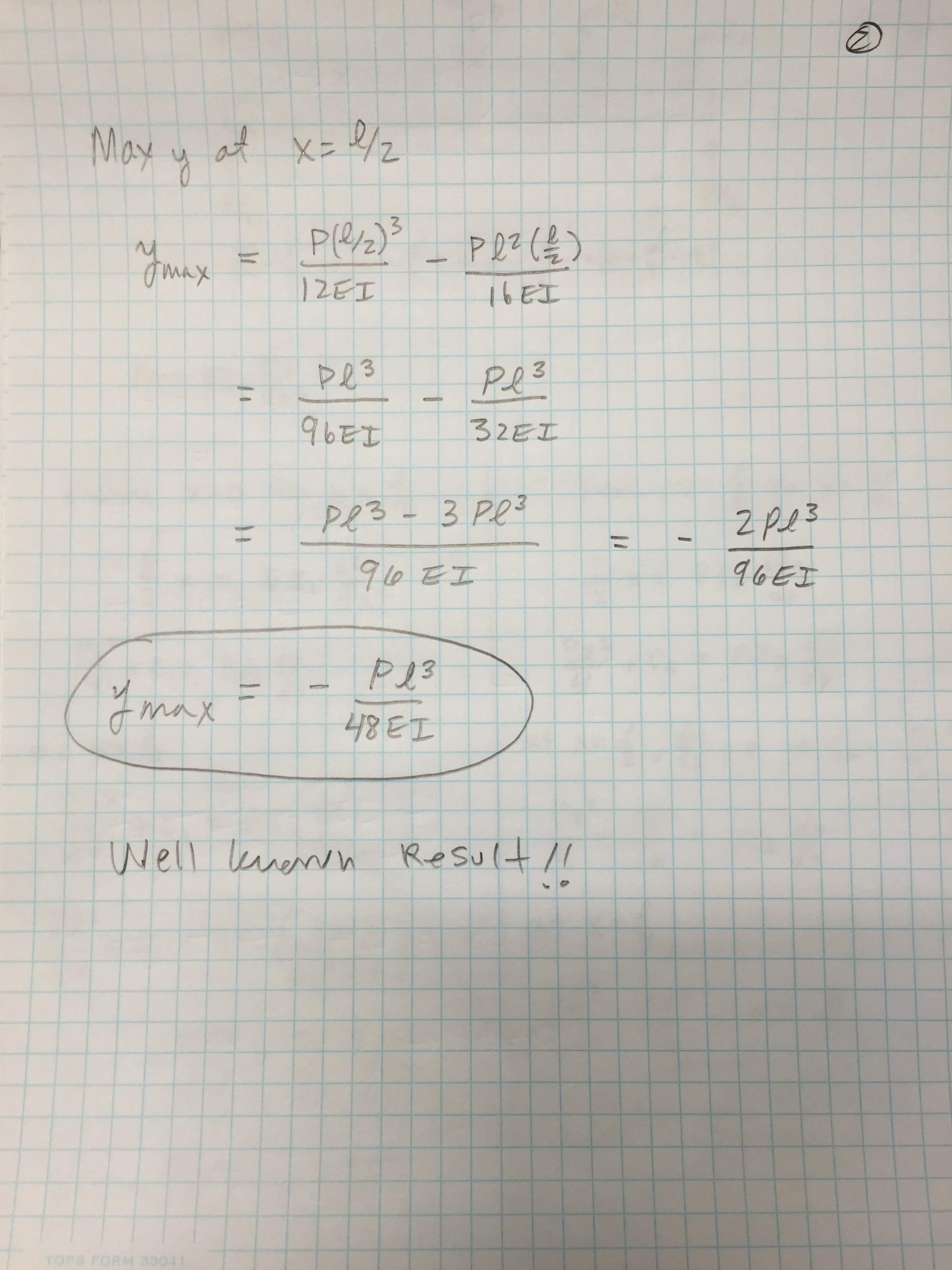

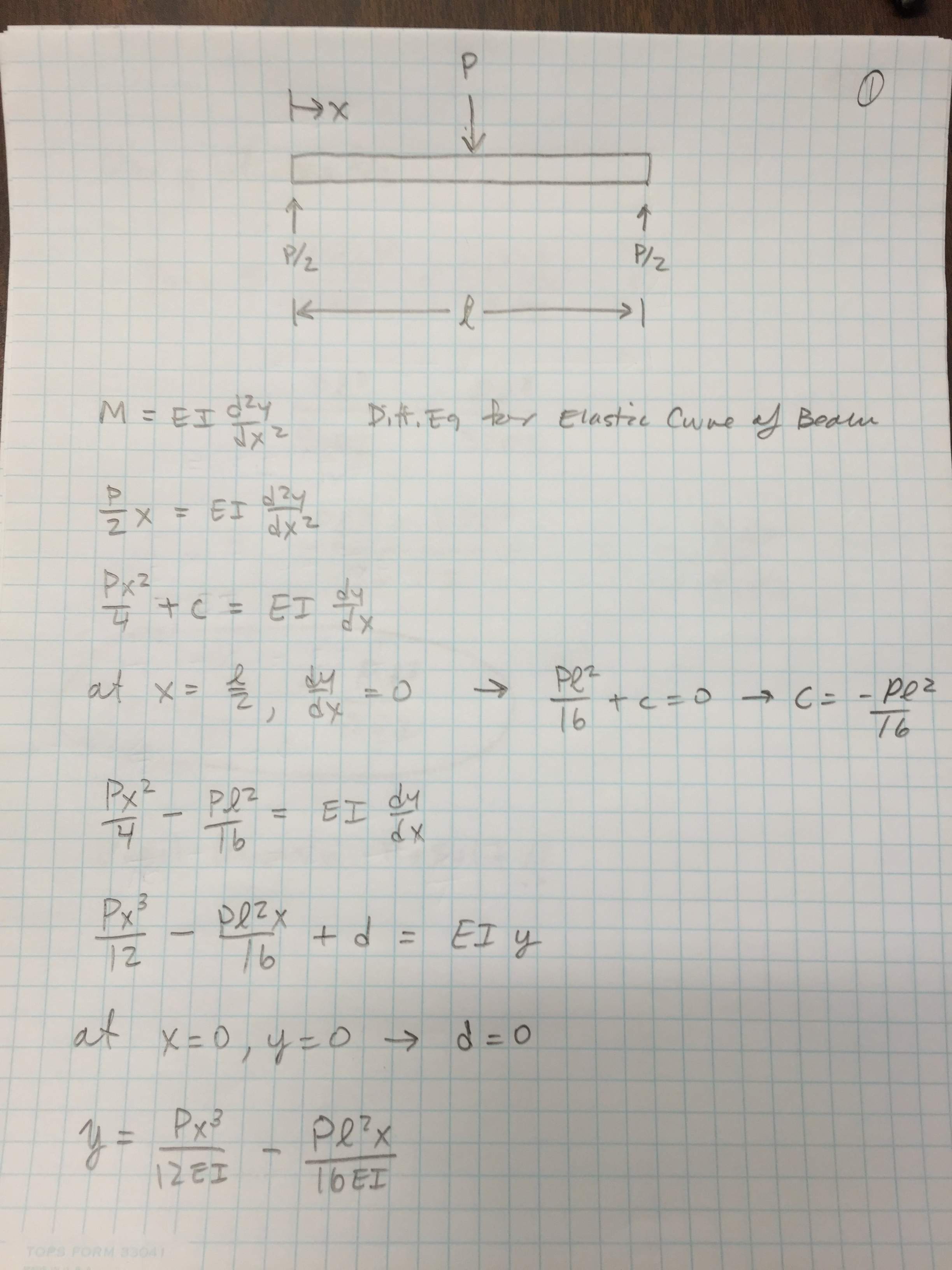

OK, here are a couple derivations that should help. First, for background, here is how a simple beam formula is derived using the differential equation for the elastic curve of a beam, which relates moment to curvature and material/shape properties:
That gives the well known deflection for a beam with simple supports and a point load in the middle.

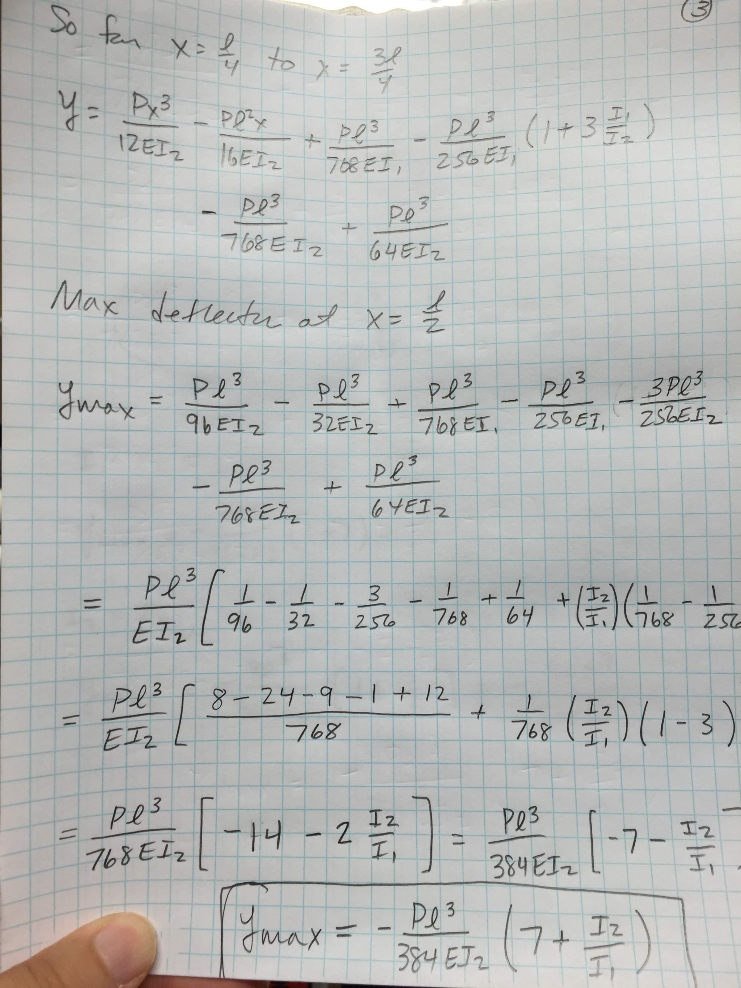

Here's the same approach but for a beam that has a different area moment in the middle section. For convenience I assumed the beam is evenly spaced up in quarters, with the different section taking up the middle half.
I checked to make sure this more complex formula gave the simple result when the area moment was the same everywhere, and it does, which hopefully is a good check on my math. But it couldn't hurt to follow through and check my work. Really the hardest part of these derivations is not the Calculus, it's keeping track of all the math and fractions.
The basic gist of what I did in the second case was the same derivation, but breaking it down to apply to different sections of the beam. We can solve for unknown constants in the process by knowing deflection is zero at the end, that slope is zero in the middle at x=L/2, and that deflection and slope must be equal where the two different sections meet up at x=L/4. That lets us come up with equations for the whole beam.
Anyhow, using the result on page 4, you can plug in I1 (unstacked area moment) and I2 (stacked area moment) and get the deflection in the middle of the beam. Hope this helps!
