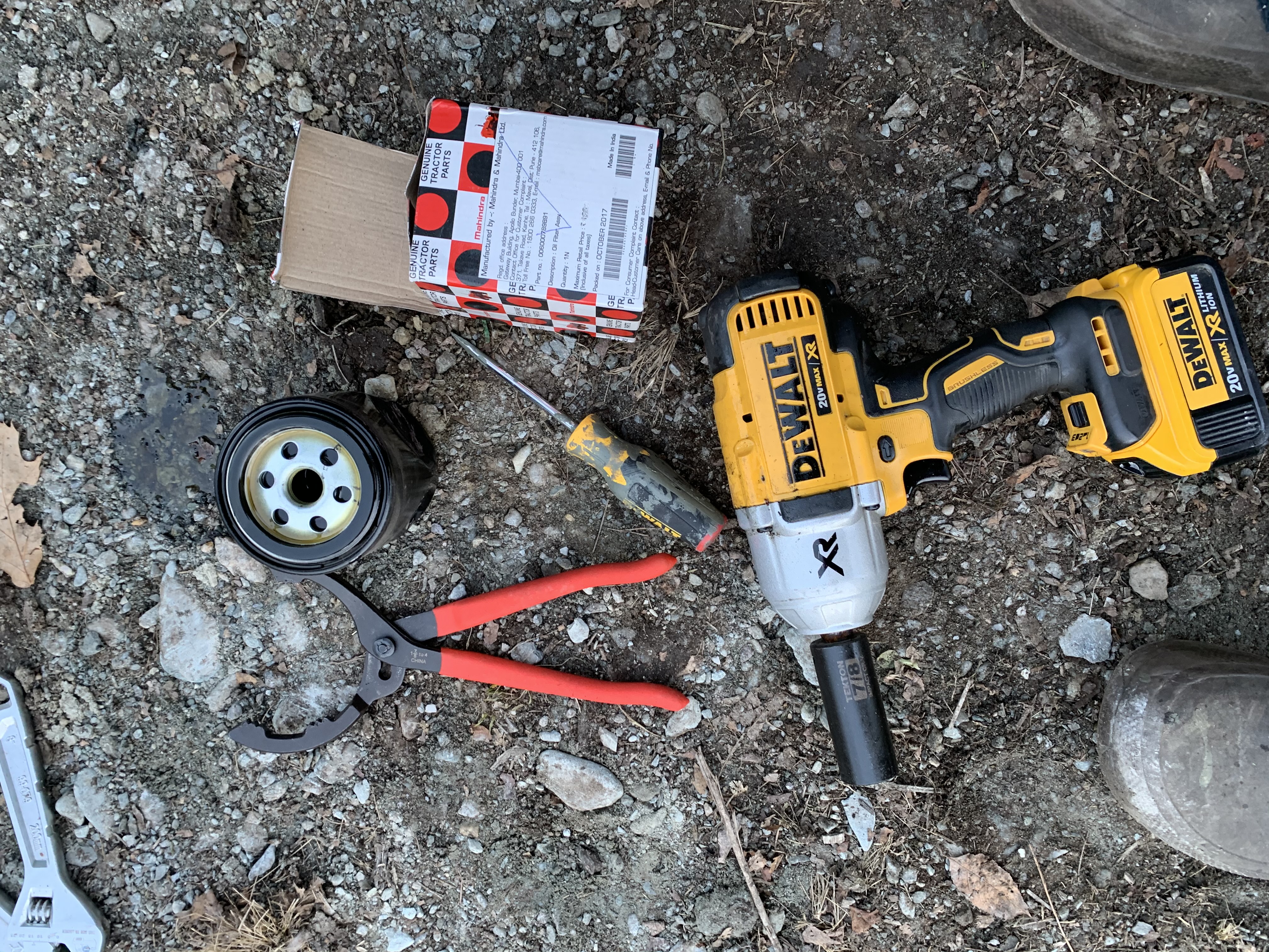

Tools used:
New filter from dealer, part # is visible on the box I believe if you zoom
Screw driver
Impact with 7/8 socket
Oil filter wrench
Pretty simple stuff!

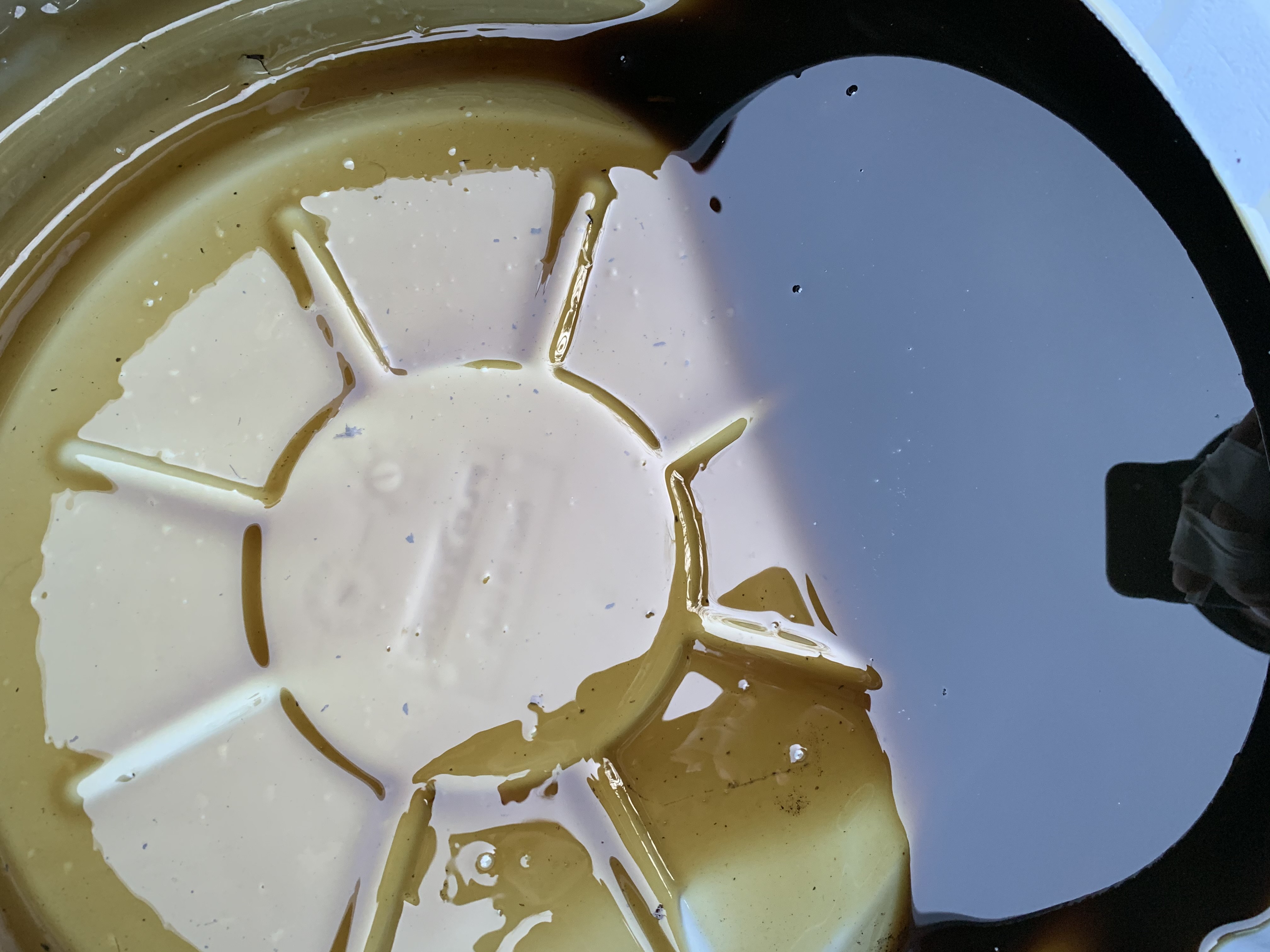

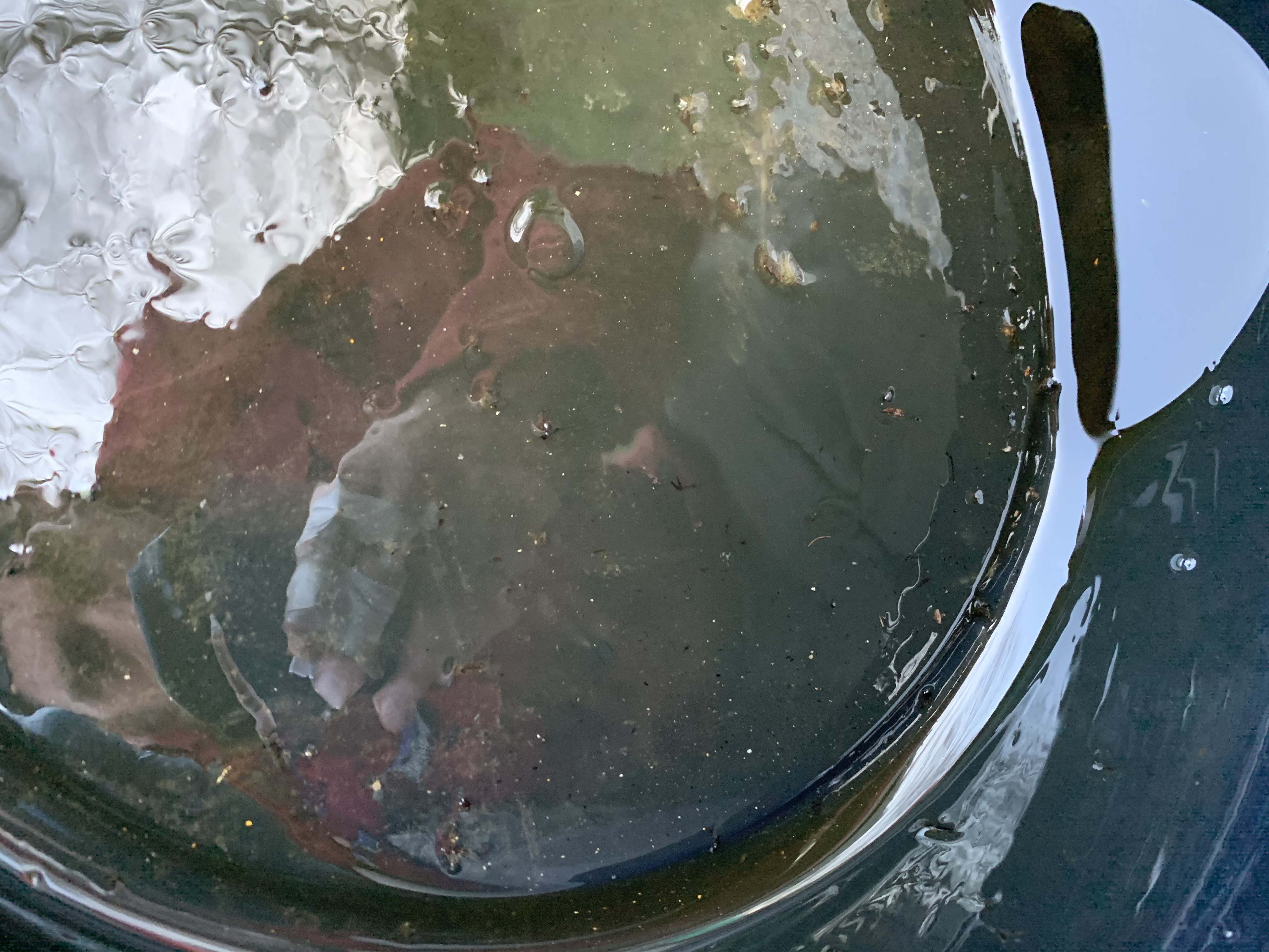

So first things first, get the engine warmed up so the oil drains more quickly, then drain the oil! The magnetic plugs had some goup on them, and once I wiped that off there was a fair amount of metallic sludge. Nothing absurd, but there was enough metal floating around in my oil that I am happy I did the change at 17 hours and not 50. I will change it again after winter snow season, which I am guessing will be the 50-60 hour mark depending on the season.

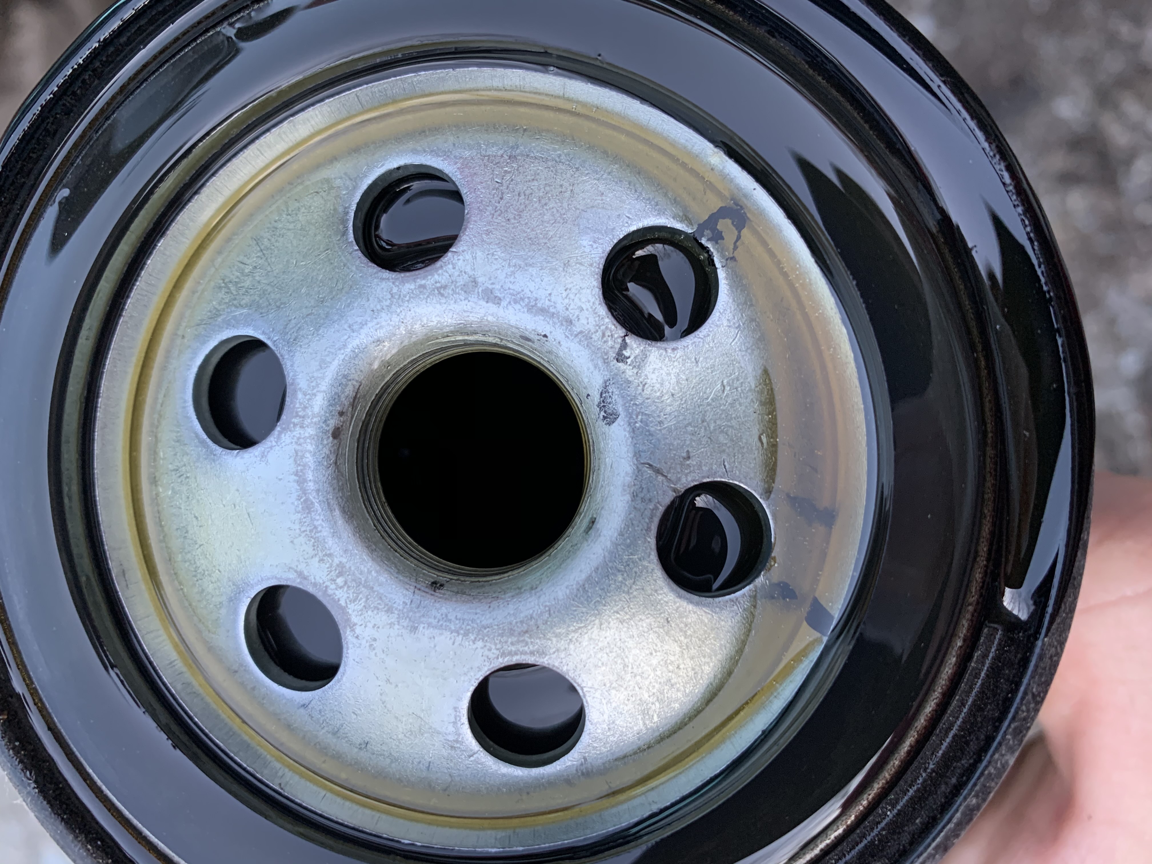

Then I took off the filter to replace the new one, looked pretty good in there! Don't forget to rub some old oil around the gasket! And don't over-tighten it either! I tightened by hand like it said until tight, then another 1/2 turn.

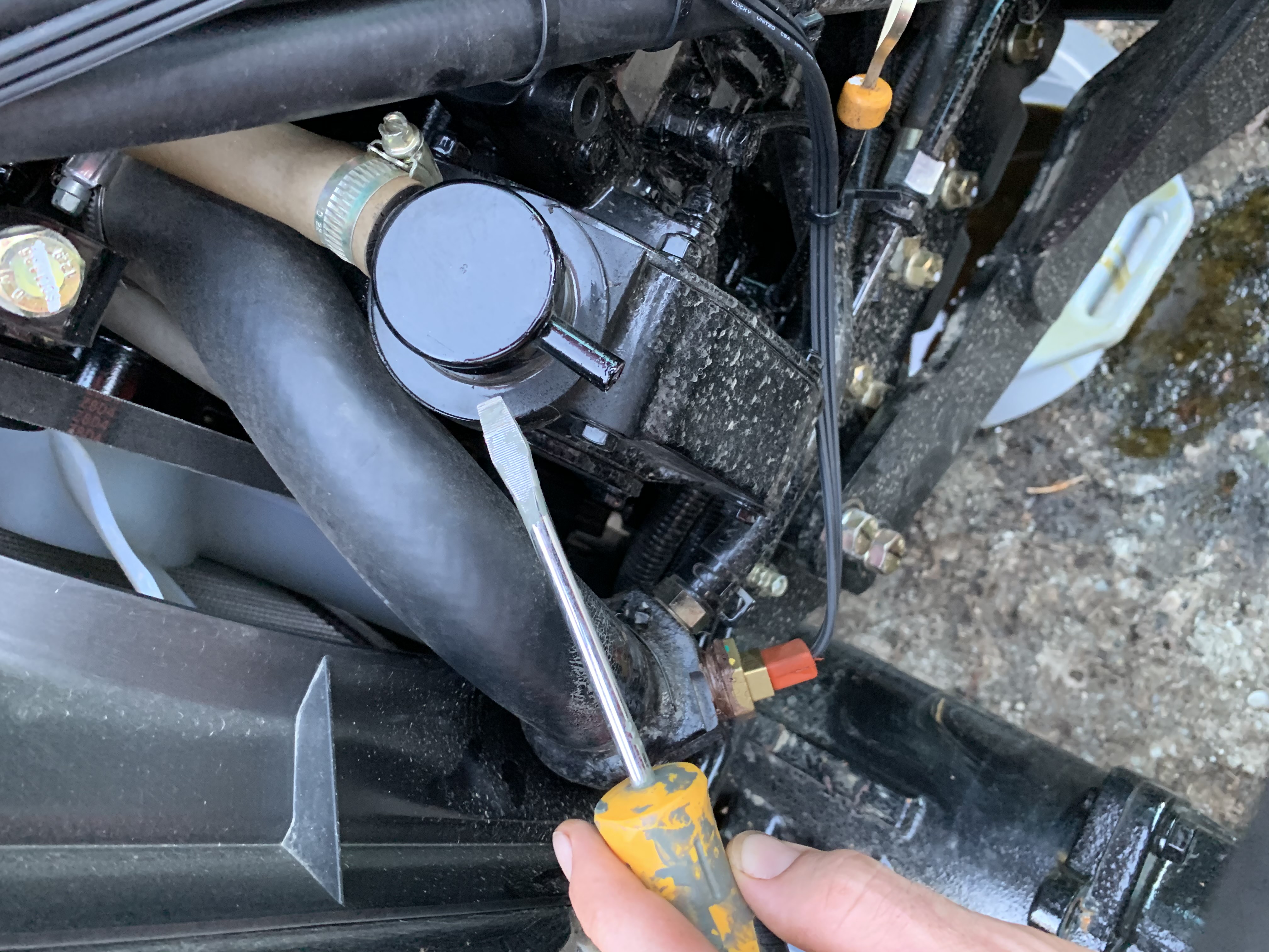

Then put back the magnetic oil plugs, and it's time to refill that oil!! But wait, where in the **** is the oil fill!! This is actually pretty ridiculous IMO from Mahindra here. I have never seen a car, lawn mower, truck etc... without a clearly labeled fill neck, usually with a yellow cap, but most of the time at least the oil symbol. Not here boys! The manual shows where, but not how to open, and if you are doing this the first time it can be confusing I think.
So, put the screwdriver underneath and slowly prop up from around it sorta like a paint can. Be careful to avoid the nipple and hose as you don't want to damage them. A good smack or two puts it back into place.
