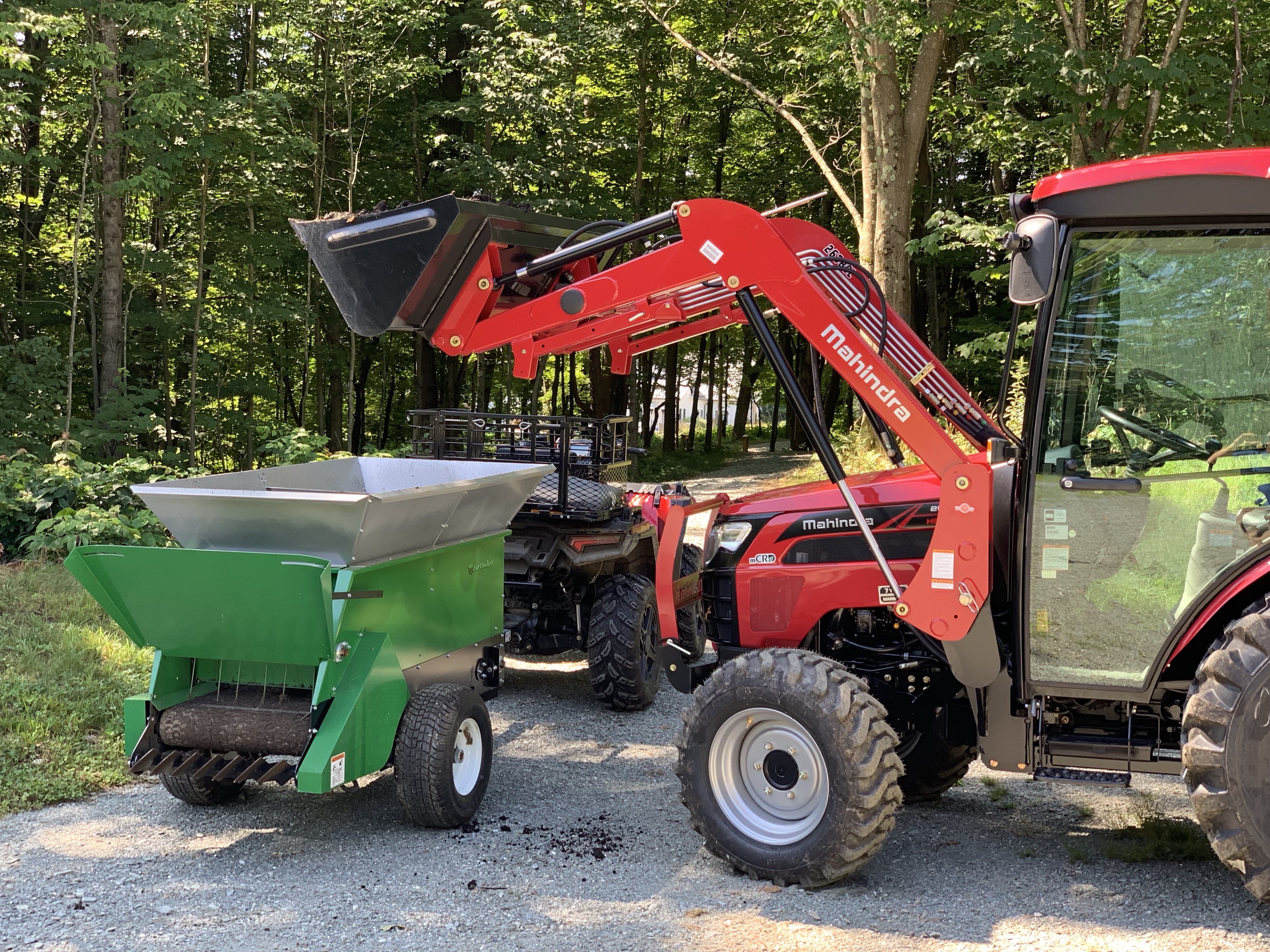

I wanted to make a thread that I could consolidate all my questions, any possible mods, and my reviews on implements I use etc...:thumbsup:
I got a 2019 2638 w/Cab and HST dropped off yesterday, had 4 hours on it. I added 2 rear spools, and will add 3rd function later on. Got the quick hitch for the 3pt but need to put it on still. I've only got about an hour of seat time on the Mahindra so far. Before this I've used my father's Cabbed 90's JD and early 2000 Kubota, the JD is mid 50hp and the Kubota is low 40's. I like the Kubota the best, but the JD certainly was the go too for bigger things or pulling someone out in the snow.
I got this to primarily load a compost spreader during growing season to build my turf, plow and blow in the winter to keep parking lots and our driveways open. I also want to get a box blade/land plane eventually as well to clean up and smooth out my trails and old logging roads. The main reason I went with Mahindra was price, dealer location and this series seems to be reliable and well made.
Right now I only have an hour on it, primarily just playing around with loader bucket and getting used to the driving modes and seeing where I fit on existing trails. With the loader on the front, the rear tires have very little traction to push up hills or small brook banks. I need to find someone local who can fill tires, and get some rear implements going to balance out the weight. The loader itself seems to run very smoothly and I have been happy with it. The only thing I am not really concerned, but wondering about is the hydraulic squealing sound when accelerating, I've never heard that on other tractors? Am I running at a wrong RPM or not doing something? Or are these tractors just a little noisey? I've also noticed reverse isn't super smooth. I'm wondering if that's a result of my weight imbalance a little bit though as well.
Anyways, any tips or suggestions would be great. I did read the manual and actually found it somewhat useful despite what people have said on here. I will admit that for anything more complex than changing fluids, I'll be searching youtube for better examples. There were a few points where it told you to look at another section for information then it wasn't there.:confused3:
Anyways, so far I'm happy, and as I get used to operation and adjust to everything I'm sure I'll be even happier. :dance1: I have a 40 foot HC shipping container coming hopefully next week for storage.
Not sure why photo is upside down, and tips on that appreciated as well. IMG_0566.jpg
