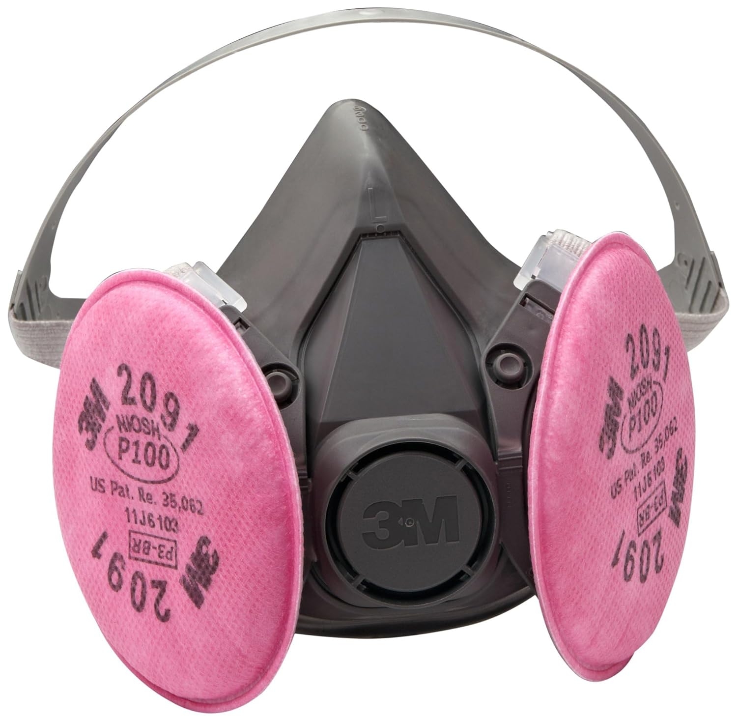

What mask do you guys recommend for under the hood protection?

I use a 3m respirator with p100 pink discs. https://www.3m.com/3M/en_US/p/d/v000093499/
And I use a harbor freight auto tinting mask.
I used to weld without the repsirator and the **** that came out when i blew my nose was unnerving. Using filters completely changed that.
What I use as well, it fits under the hood well enough I don’t notice it at all. Just make sure you’re getting a good size/seal.

I also use the 3M Half-Facepiece and 3M 2091 filters. As already mentioned, make sure you get the correct size facepiece, (6100-Small 6200-Med 6300-Large I think)
I ended up getting a medium and a large to see which fits the best... Amazon > one will go back.
/ Breathing mask for welding #10
Somewhere around 60-75% of people fit in a medium and almost all the rest in a Large. Very few smalls out there, unless you are talking about folks from SE Asia. This is generally true for all half mask respirators, though it will certainly vary with different designs and styles. Some only have 2 sizes and other have 4 or more.
As for filters even N95 will cover most welders, especially hobbyists, until you get into certain specific things like Chrome (a component of Stainless), but P100 is also very common. Either one will do fine and are the most common types. You can also find ones that have some activated carbon in them and will take out "odors" or "nuisance vapors" like the paint you singed when repairing something with your welder but don't have enough carbon in them for working with spray paint, for example.

I wear a 3M half mask (same as the picture in post #8) with the pink pancake filters (xx97). I think both the xx97 and xx91s work for welding - it will say in the description if it's suitable for welding. I also weld only under a carport open on 3 sides, so if it's windy I have to wait for a better day for MIG welding.
