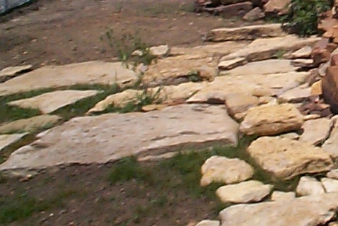

I have quite a few LARGE shelf rocks laying around that I would like to break up/cut up. The rocks are from 6inch to 12inch thick and average from 5 to 7 ft long, 3 to 4ft wide. Now it would be real nice if I could break them for easy wall building and movement. By shelf rocks, I mean that they are flat on both sides.
Any ideas on how to reduce the size of these rocks.
Already tried hammer and chise- makes a nice surface line, but couldn't keep it up long enough to break even a small rock.

Will your 33 roll them over or lift one end? If so, you might experment with some well placed round rocks placed underneath and dropping them. However, I can't say if that will work on the thicker slabs without some line drilling to create a fracture zone. 12" thick is pretty stout. I've read something about people drilling most of the way through in a line and placing expanding cement in the holes to promote a fracture. Never tried it though. A heavy air driven jackhammer may have some use too? That and a spline or SDS MAX hammerdrill would handle it. Still real work and expense though. Somebody who's actually done it would be rather more help.
I know what to do with real big round ones or rock veins. Call the air track/explosives guys in at big $$$. But that's not a solution for you. Be cheaper to buy them.

When I work with flagstone, which is closer to 4 inches thick, I cut the bottom side with my circular saw and a masonary blade.
For those, just an inch or less will allow me to break them where I want. This allows me to shape them to fit where I want and still have a natural edge to it.
It might work on those big ones, but you might also have to score them deeper too.

Try the masonry blade approach and see if you can't break them along the score. I'd try scoreing all along one flat side maybe 1 inch deep, lifting edge and placing metal pipe under stone along score, hitting lifted edge with sledge hammer and hope it breaks along the score. The limestone here cuts amazingly easy with a masonry blade in a skill saw.

There is also a product called Dexpan to split rock, concrete etc.. that is non-explosive. However you need to drill holes.
I don't think there is any easy way other than a backhoe with a jack hammer attachment.

I'm in a 4wd club. We use a clubmembers property to have a Rock Crawling event. We wanted to make a easier access road for a concession stand and to remove broken vehicles easier. I don't know the name of the stuff, but we drilled holes with a hammer drill, poured in the expanding grout. This stuff is amazing. Went back with long steel rods to help move them around the next weekend. If we had more practice on our drilling technique we could make gravel out of the whole hillside. The drill bit and the grout were about $200.

The easiest way I know of to break those puppies is to lift it up and drop it. If you can only lift one end then lift that corner and place a stone under it, then drop it.
They appear to be a sandstone type stone and will break easy this way.
A good hammer drill and wedges will also make quick work of it too. I use a twelve inch Stihl with diamond blade and it'll go through them quickly.
But if you want to break them try to move them without breaking them. It works almost every time. /forums/images/graemlins/grin.gif

This is what I was going to suggest. Typically they are callled "feathers and wedges". The ones I have use a 1/2 inch hole and about a 3 pound hammer. Very easy once you drill the hole.
