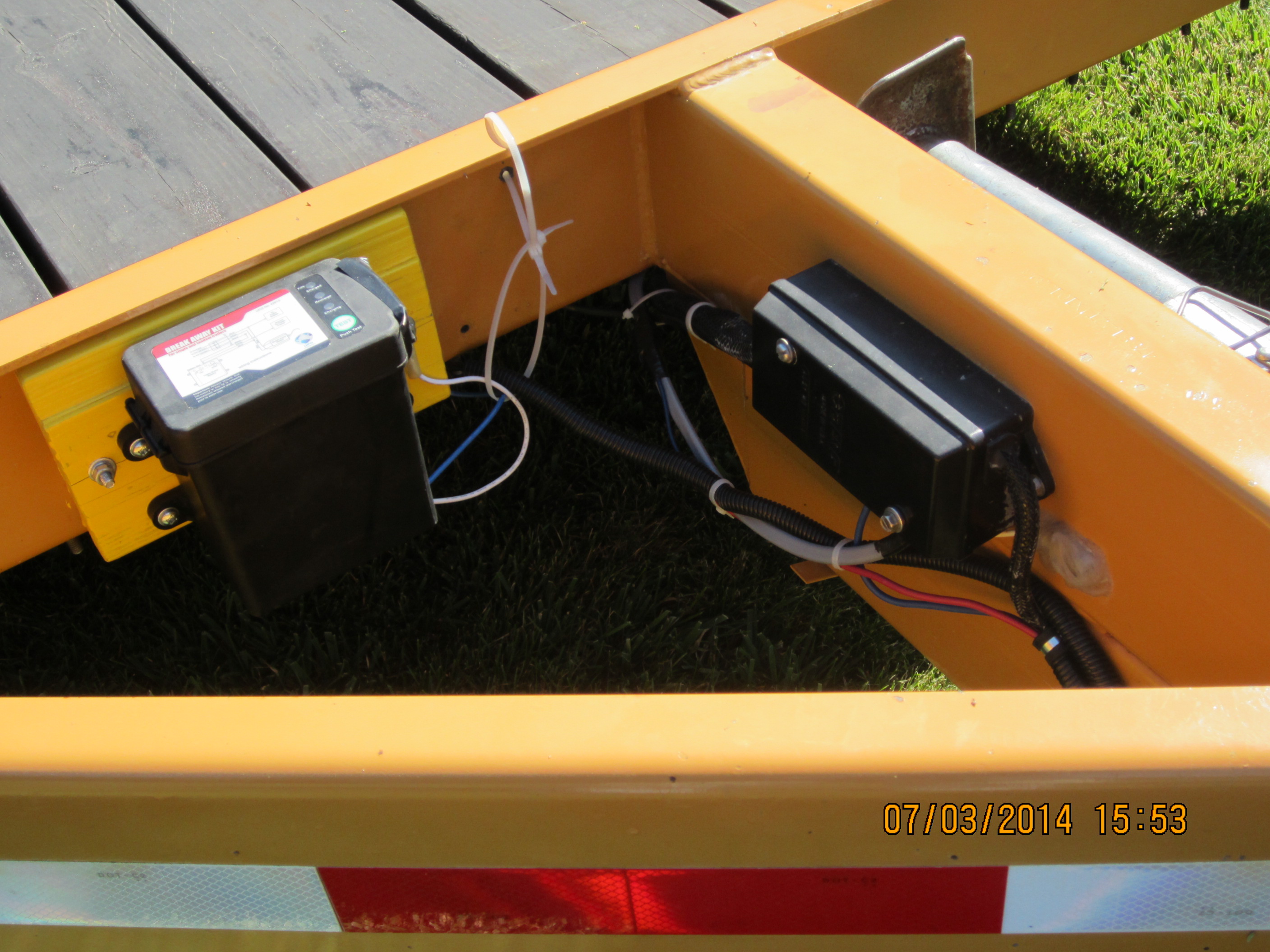

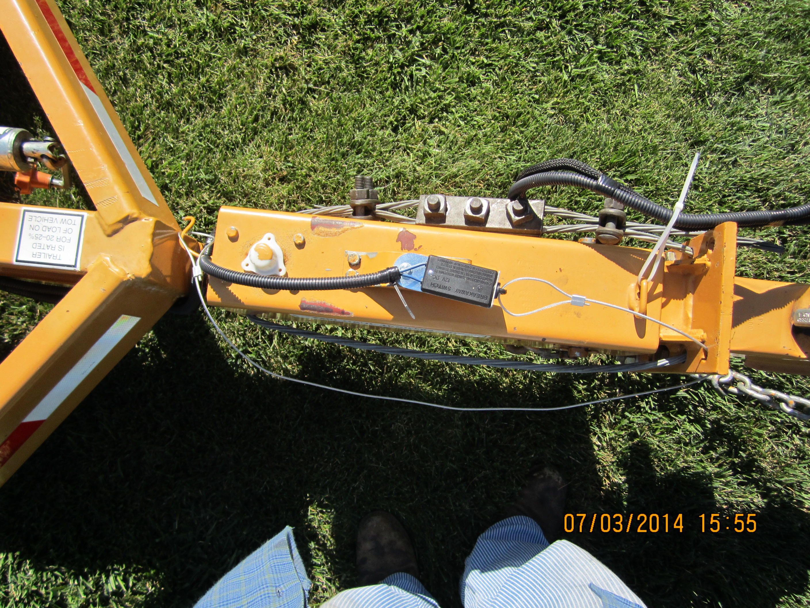

Hi TBN'ers
Can one test the function of the Break Away system by simply pulling the key out of the switch with the trailer not connected to the tow vehicle? Shouldn't one hear the electric brakes 719.JPG722.JPG engage? I know the battery is okay (new), but the indicator lights on the box don't light up; as though the battery indicators are dead. I've checked the continuity of the ground wire, but ain't all that savvy with wiring.
Cheers,

It will work connected to the tractor. Pull the pin the brakes should lock up. I don’t think you can check it without tugging on it.

Jack the wheels up on one side and see if they turn. That’s how they do my safety inspection on my trailers.

You can here them some times, but the click may be only 1 engaging. The fool proof test is to jack one side and check each tire like already stated. Then you know for sure that each one is working properly.

Your welcome. I've come behind someone at work where they "checked" the brakes by listening for the click. Only one side was working. The other side was so rusted up that I had to replace the brake assembly.
Other time, they checked a set of hydraulic surge brakes by just engaging the brake away. That one had a crimped brake line so it was tight and had plenty of pressure. But wasn't actually engaging the brakes. That was on a piece of towable equipment that weighed 10,000 lbs. If someone lost it, the person who said the brakes were good would probably be in jail if someone got seriously injured.

When jacking the trailer up, built up rust may make you think brakes are working but in reality may not be working very well. IMHO the sure test is when hooked up trying to pull when the breakawat cord is unplugged. You can unplug the 7 pin cord if you want to, unplug the breakaway and step on the gas. You should be dragging the trailer.

IMHO the sure test is when hooked up trying to pull when the breakaway cord is unplugged. You can unplug the 7 pin cord if you want to, unplug the breakaway and step on the gas. You should be dragging the trailer.
