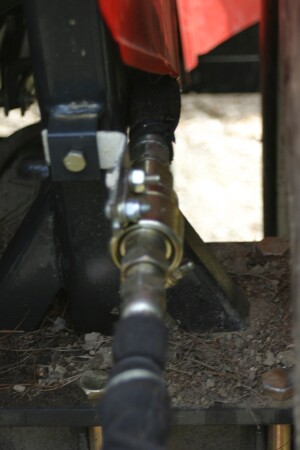

Hey Rob,
Here's a couple pic's of mine. This one has a control as the seat and only guessing is part of the $400.00 kit??? The close up is of where the too lines are going.
The other rear hoses running the backhoe is tied in with the front loader.
Steve

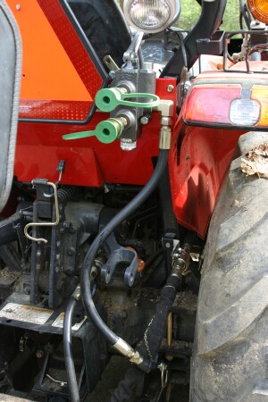

Adding a rear remote set to a Branson 4220/4720 which came equipped with a backhoe is a piece of cake (took under two hours) and can be done for about $150 (you of course do so at your own risk; working with hydraulics requires care, and sloppy work can create a danger to the modifier and/or future operators of the machine). Other models should be just as easy. Even if you didn't buy a Branson backhoe, your tractor may have the hose loop with QDs needed to connect one; this consists of a hose which runs across the top of the PTO rear shield with a right angle elbow and female/male QD set behind the right wheel (as viewed from the rear); one end of this hose goes up front to the FEL valve out port, while the other end goes to the three-point lifter inlet behind the left rear wheel. First, get a Cross Converta-valve (about $90) at Tractor Supply (TSC), along with a two foot 1/2" hose, two 1/2" male/male unions, two 1/2" female Q/D couplers and two 1/2" female to 3/4" male couplers (one of these should be a right angle type). Take the hoe off, and turn the tractor off. Be sure to lower the FEL and exercise all hydraulic controls to relieve pressure before opening any connections. Keep hoses as high as possible while open to minimize fluid loss. Start by disconnecting (separating at the QD) the two hoses you'd normally have plugged together when the hoe is not mounted. You'll likely find the sump hose (the one with the male quick disconnect) has considerable free length tied off behind the the left wheel; remove the wire ties so you can extend it fully, and remove the male QD from its end. Install this QD on one end of the new 1/2" hose. Screw the two new female QDs onto the two new unions, and then screw the two unions into the two 1/2" work ports on the Converta-valve. Screw the two remaining couplers into the in and out 3/4" ports on the valve (the right-angle coupler goes on the inlet side pointing toward the bottom of the valve), and connect the remaining threaded end of the new hose to the coupler on the inlet side. This leaves you with a hanging hose long enough to plug into the original supply hose female QD, which you should do. If you really want to do yourself a favor, remove the right angle elbow from the supply hose, so the QD can be mounted with a bracket (TSC sells a neat little $14 kit for this) facing out the rear of the tractor. My 4720 has a unused welded attachment point in just the right place to anchor the bracket to. This makes plugging and unplugging the backhoe supply hose MUCH easier, because it gives you something to press against. This QD used to be a real animal to connect, and I have the skinned knuckles to show for it; now it takes ten seconds and almost no effort. Lastly, connect the sump hose to the outlet side of the valve. Now you have a complete remote circuit; connect your hydraulic upper link or whatever to the two work ports and have at it! You'll find the valve can be permanently mounted right at the top of the sheet metal (right side behind the seat) in such a manner that the handle ends up right where it can be easily operated but doesn't get in the way (when assembling the valve handle, orient it so it extends over the back of the valve; this puts it right next to the seat back), and that hose dress is a breeze (my sump hose runs behind the caution trangle; the right angle adaptor aims the inlet hose right where it needs to go to plug in to the supply hose QD).
Some caveats;
1) This arrangement puts your new valve in series with the three point hitch lift; if both are operated simultaneously, the motion of both will be slower than normal (just as one backhoe motion interacts with the other two). Note that this series arrangement is the same one used by Branson for the FEL and three point (or hoe); the supply hose you're working with comes directly from the FEL valve outlet!
2) The remote circuit isn't operable when the hoe is connected, just as the three-point hitch already wasn't; I can't imagine a need to use both at the same time.
3) The Converta-valve is not meant for metered lifting (I'm not sure whether a hydraulic upper link qualifies as a lifting load, but my best guess is yes); TSC sells a very similar one (the SBA2; 18-20762) for about $120 that is intended for metered lifting. I use my remote circuit to operate the horizontal cylinders on a towed "soil mover" (grading box), so the nonlifting valve works fine.
4) Watch your valve and hose placement! Make sure the three point lifting yoke and links will clear your valve and hose arrangement throughout the full range of movement before you permanently mount the valve and dress your hoses. There's plenty of room, but placement is important to avoid rubbing and hose snagging.
TSC stock numbers used;
(1) 18-20128 valve
(1) 18-19240 hose
(2) 18-22403 QDs
(1) 18-18731 coupler
(1) 18-18749 90 degree coupler
(2) 18-18082 unions

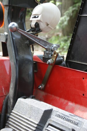

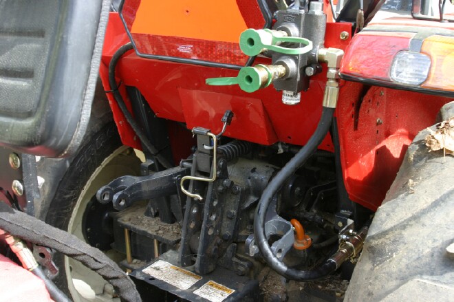

The first image shows the completed install, with the hose connected for normal three-point and remote operation; note the right-angle coupler orientation on the supply hose, and how the sump hose runs behind the trangle. The angle the image was taken from makes the new hose appear to be quite close to the three point lifting yoke; there is in fact plenty of clearance. The second image shows the backhoe hoses connected; the hose running to the valve inlet is simply left disconnected, just as it was in the original arrangement. Shown in the third image is the bracket I created using the TSC kit and a L angle cut to size. The last image shows how the valve handle sits; note the brace holding the valve (this came as part of the QD mounting kit) and the Sears "truck size" tool box which fits in the space behind the seat like a glove.

The design I described earlier works but is imperfect in that the converta-valve is not correct for the task and may leak (mine did after about a week of use). The install described should be modified in the following ways. First, a Cross SBA2 valve with the optional Power Beyond sleeve kit should be used instead of the converta-valve. The SBA2 is a special order item at TSC, can handle metered lifting tasks, costs about $105, and is about the same size; the same mounting and hand placement arrangement used with the converta-valve works with the SBA2. The existing (long) hose which runs to the three-point assy (goes behind the triangle in the images) gets connected to the Power Beyond port on the new valve. Next, a new 24" hose with a female QD at the far end should be attached to the outlet port (right angle couplers at both ends would make this neater and might allow use of a 15" hose, but are not essential). This QD plugs into the same existing male QD used for the return hose when the backhoe is mounted (this QD is located just to the left of the hydraulic filler neck). Since the remote and the hoe will never be used at the same time, this poses no conflict. The inlet port connection is the same as shown for the converta-valve. This arrangement allows simultaneous use of the remote circuit and the three point lift. Need two remote circuits? Simply buy the SBA22 double spool valve; this gives you two pair of work ports. All connections are the same, but make sure you measure first (it's quite a bit wider and heavier; the mounting point may need to be shifted slightly to clear the three point yoke when fully raised). Mind your hose placement so as to avoid chaffing and conflict with the three point links.
An optional (simpler) arrangement which allows the use of the converta-valve (but does NOT allow simultaneous usage of the remote circuit and the three point lift) follows (it assumes the modifications in my original design have already been made). First, disconnect the long hose from the converta-valve outlet port, and reinstall the male QD this hose originally had on it. Then add a new hose and female QD as above to the valve's outlet port. That's it; you"re ready to work. To use the three point, connect the long hose's male QD to the female QD next to the right wheel (same arrangement the tractor originally came with). To use the remote circuit instead, separate these QDs; then plug the converta-valve's inlet hose into the female QD next to the right wheel, and the outlet hose to the male QD located to the left of the filler neck. This leaves the long hose leading to the three point unit disconnected (just as it is when the hoe is mounted). The outlet hose can be left plugged in all the time (except of course when the backhoe needs to be plugged into this QD), even when using the three point.
RE adding a remote up front; the SBA2 will work there too; Power Beyond port on the FEL valve connects to the input; the hose this leaves disconnected goes to the Power Beyond port on the SBA2. The outlet port on the SBA2 gets teed into the hose connected to the FEL valve's outlet port. There is an alternate tank port on my FEL valve that can be used instead of teeing into the line; the service manual my 4720 came with shows a completely different valve, so this may not be found on all Bransons.
