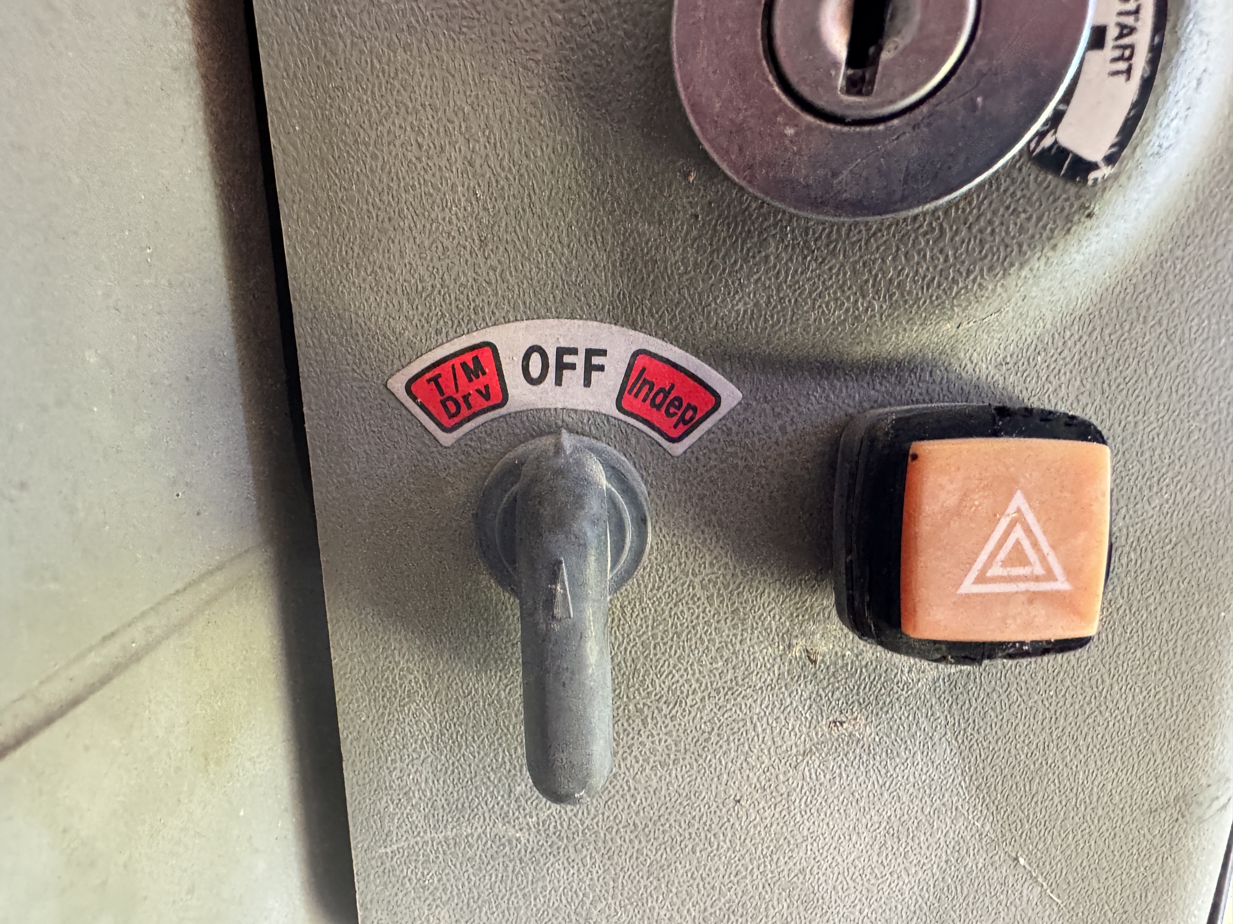

I have a Branson 4720i and I’m not sure I know how to turn the PTO on. I had a Kabota before and it was pretty easy. It was a switch on the dash my tractor has a lever below the seat and a switch on the dash for independent and T W Dr.
If I have both of those turned on the PTO light in the dash does not come on. I have checked the fuse. What else am I missing?

Is your switch labeled independent/off/linked ?
That may be the only switch.
Is yours an i or an h series.
Added;
OK I just saw your picture.
That is likely to be your only switch, with your speed lever in a selected speed then turning your switch to indep the pto should run.
I can’t thank you enough. But I set the speed selector to 540 and I turned the switch on still no PTO. I also tried raising them lowering the three-point hitch no joy. The PTO light on the dash never comes on.
Do you have any suggestions for troubleshooting? Where should I look next?

To which side did you turn the switch? Turn it into Indep (independent) mode.
   / Branson PTO fuses and coil #9
Yes, I tried both sides with the switch and both settings on the speed selector.
Neither seem to work at all. On the Kabota I owned when it was in PTO mode successfully the light on the dash would come on. This Branson has a dash light, but it never comes on, should it?
