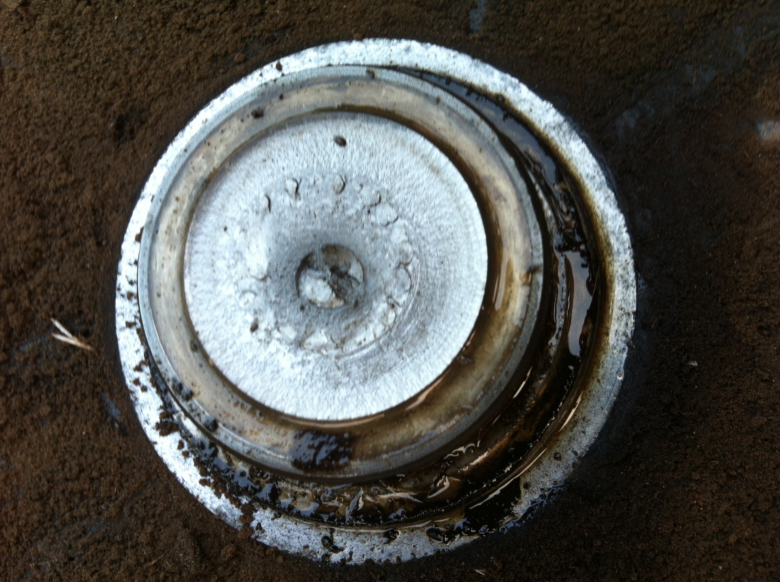

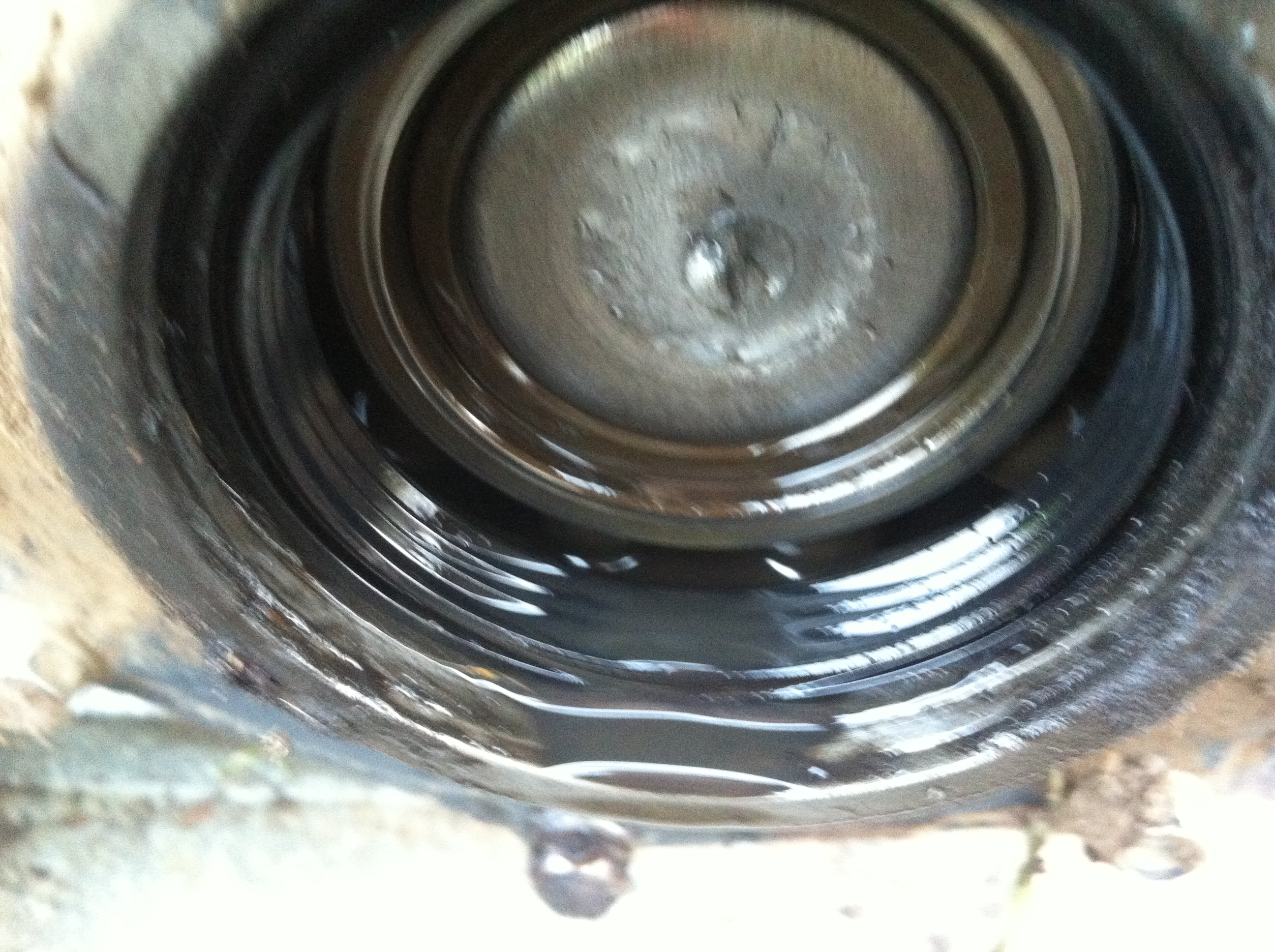

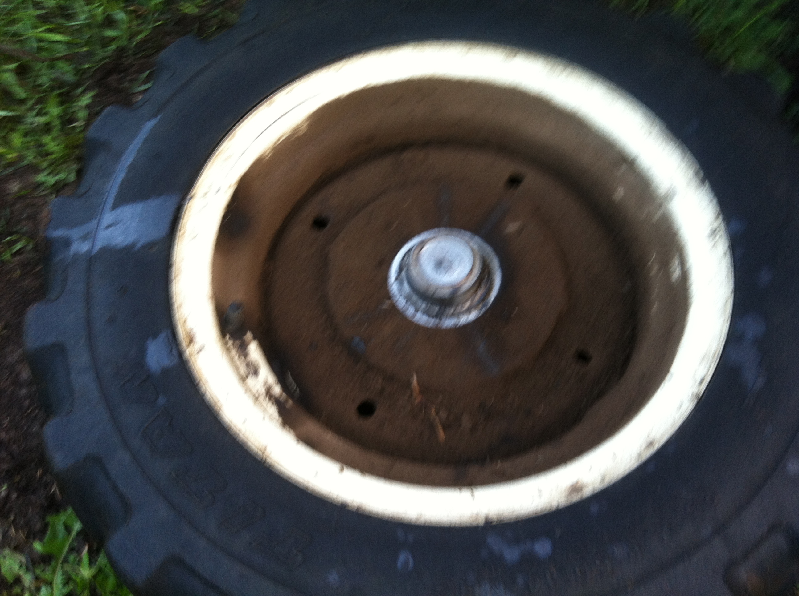

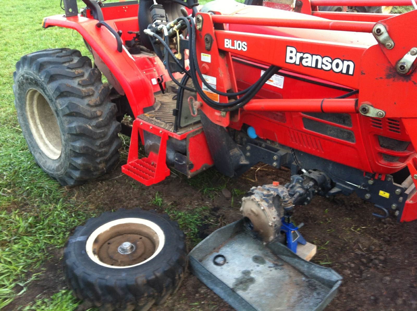

For those that are interested, I have attached some pictures of the tractor and wheel axle as failed. The wheel lies on the ground as it came to rest after departing the tractor.
View attachment 498382View attachment 498383View attachment 498384View attachment 498385View attachment 498386

Today Aug 2021 the left axle broke completely off. This happened when backing up with no load.
The heaviest thing this tractor has lifted is 4 x 5 round bales of wrapped haylage. I've used it for stove wood. I've used it for not too large cedar and pine logs bring in the moat I'm putting them on the wagon or on the sawmill.
In my humble opinion I think the turning radius is to sharpen these tractors and also I think the loader is design for lifting heavier loads than these axles can sustain.
I will try and attach a couple of pictures of my issue. I contacted Branson of course and their answer is sorry sir there's no way we can help you. I think this problem is more common than you think and I know there are naysayers out there who say it isn't a big problem but I think it should be addressed and if enough of us get together maybe they will recognize there is a problem.

@guitarman59, I would take the axle to a good machine shop and ask them to build one. With the issues you have seen, maybe have two built.
Just out of curiosity, what type of terrain do you have? Lots of hills? Also, do you run in 4WD most of the time?
Something you do needs to be modified because of all the front end problems you are seeing. If you think the turning radius is too short, you can adjust the stops so it is less. If the loader lifts too much, you can adjust the pressure relief to a lower pressure setting on your loader valve.

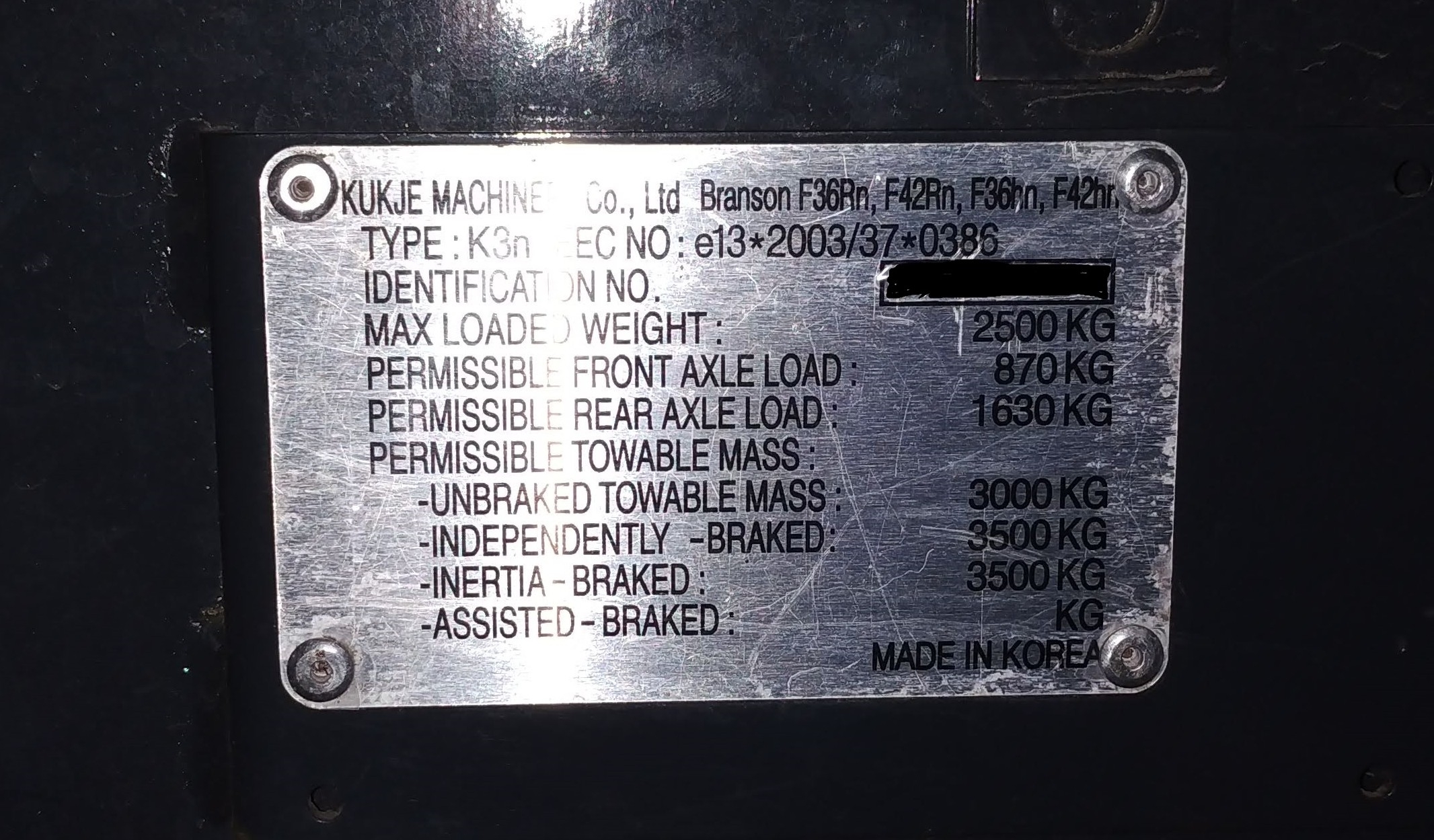

Today, I unsuccessfully looked for my front and rear axle maximum loading capacity. I looked at my 2004 Branson 3520 and it has one horizontal tube on the lower L&R side connecting the base of the Ansung BL20 loader frame to the L&R side of the rear axle. So hopefully this design will reduce front axle stresses.
I’d like to get my maximum axle capacities, loader, backhoe weights so I ‘feel’ safer regarding this issue. After looking at those videos some axles can only take a little over 100+ pounds before it is overloaded. Seems like $15k+ might be a stiff price to lift 100 pounds.
/ Branson Front Wheel Axle Failures #96
On my tractor, it's listed on the plate with the chassis number and also listed on the title.

Other than a few exceptions here and there, we don't really get the so called "OEM" loaders here. Only aftermarket ones, probably built better and with better features but that besides the point.
Being aftermarket, the loaders will have a relief valve for the lift circuit only that is adjusted so the lift capacity to matches the axle ratings. I'm speaking mostly about Portugal, but I imagine it's very similar across the EU.
For my tractor (equivalent to the 15 series in the US), the loader would have a capacity of around 800 kg / 1800 lbs versus the 2200 lbs in the US, if I recall correctly. Honestly, that's plenty of lift for a tractor this size and there is really no need for more.
With all these ratings in mind, buying a tractor based on lift capacity it's a moot point, since they all lift the same based on tractor weight, size and axle ratings.
I'm always surprised manufacturers don't list the axle ratings in the US and then use that info to deny warranty claims, because let's face it, a lot of the warranty claims on front axle issues is clearly caused by over loading and not using counter weight.
I mean, people needing to replace wheel seals with less than 200 hours like I've read several times over the years? I can only imagine what that tractor as suffered.
