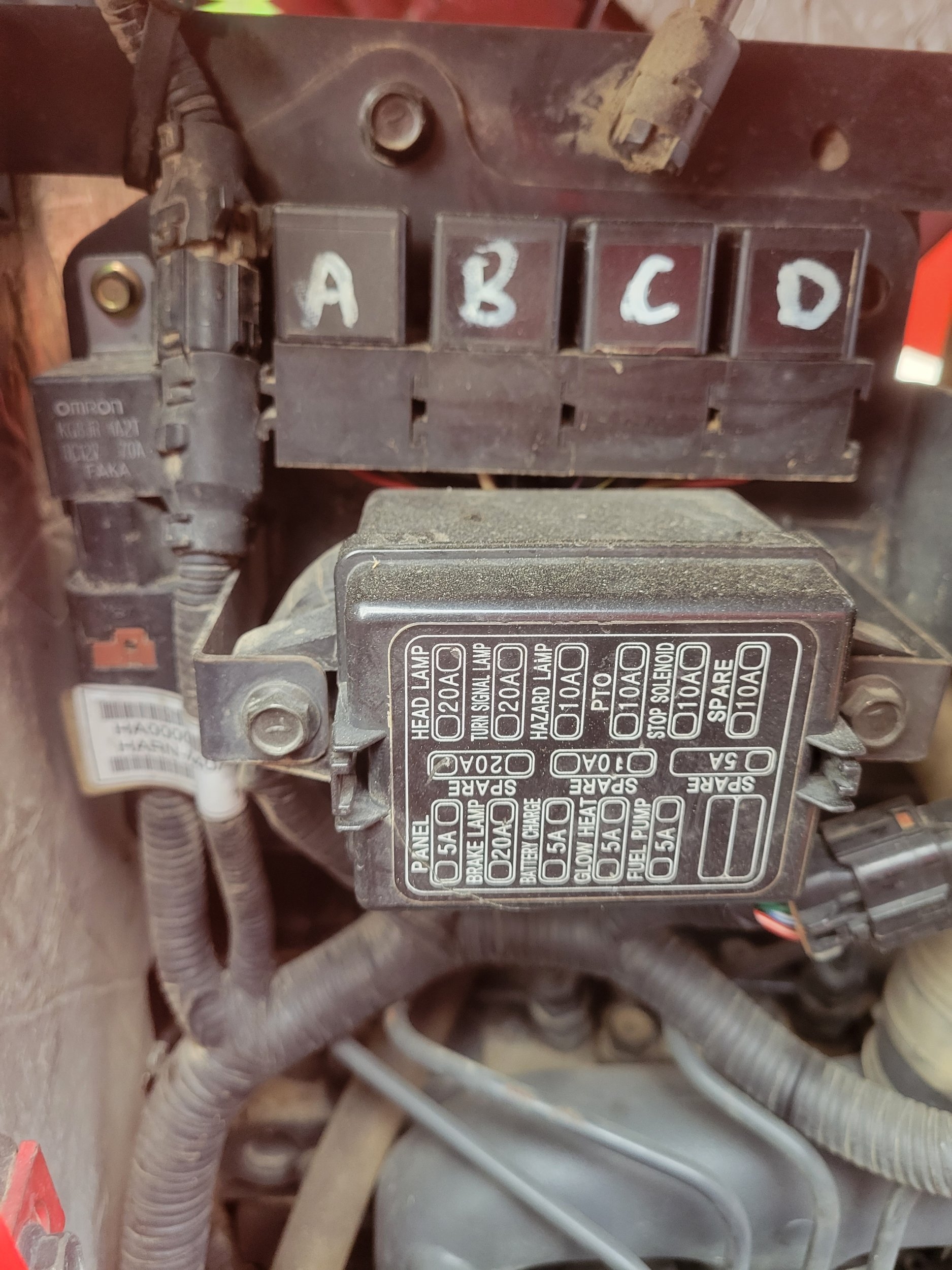

Last week l turn the key at ylthe first step the lightin the dash open l try to start but after 8 time evrery cut.
So turn the key off and l turn at the first step no light in my dash and the starter wont try.
The battery is good 12.7,the starter 12.7 the fuse is good to and l blow,maby the small realy over the fuse but l dont no how to check.

I was waiting on a reply from your other thread. Did you confirm voltage is getting to the fuse panel? The easy way to test a relay is swap them around. But I doubt that is the problem if no lights on the dash.
Electrical issues are tough to find sometimes. Finding the issue is a process or you will be chasing ghosts.
/ Branson 5520r wont start #3
Check your battery cables, remove them, clean them and tighten them back up.
