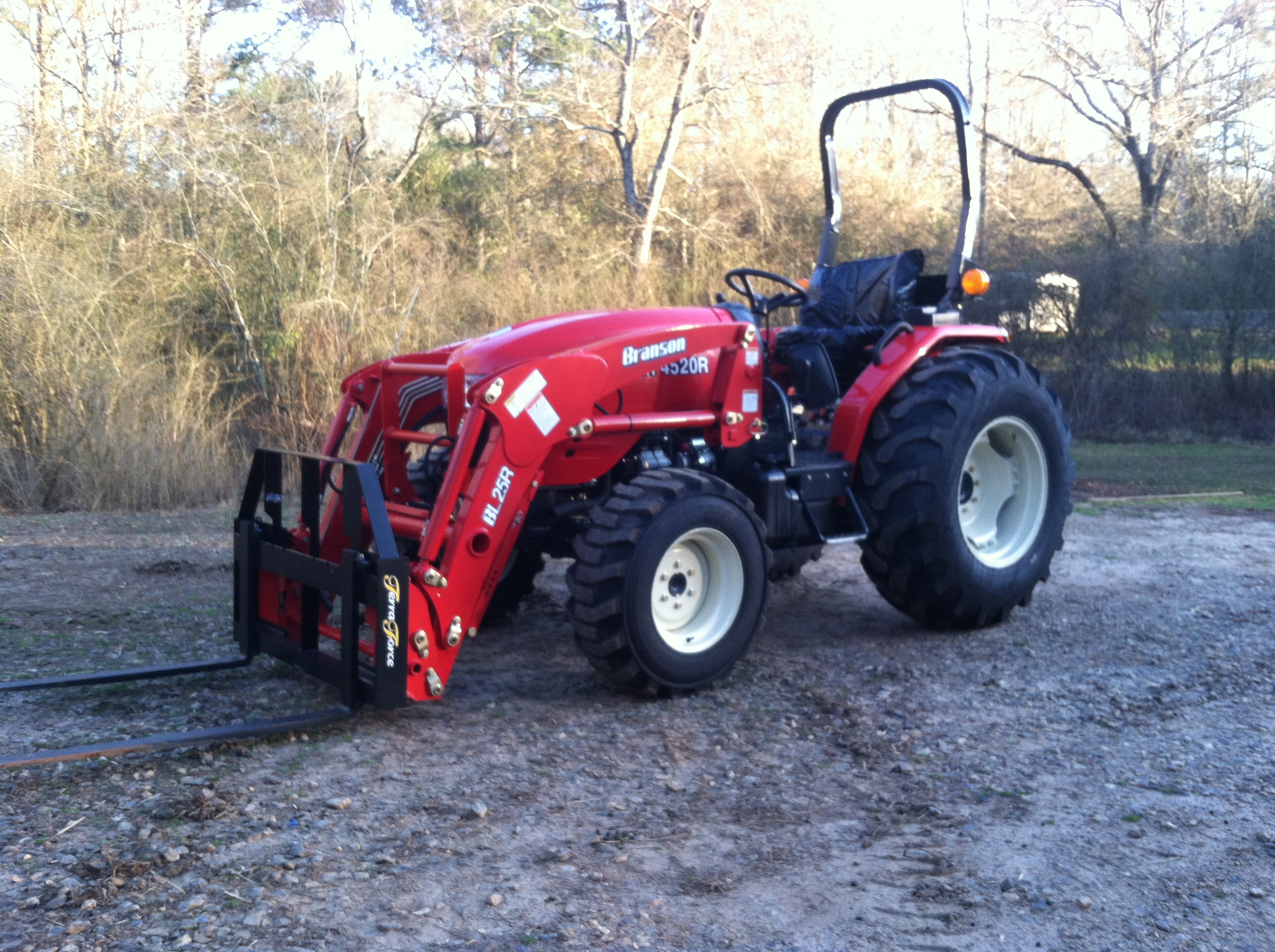

After much research and several test drives of other brands I ended up purchasing a 2016 Branson 4520R today. I also picked up a 6' bush hog, 6' box blade and a set of ssqa pallet forks. I didn't find much in the way of reviews on this particular tractor on the web so I intend on documenting things here as time goes on. This is my first tractor and I am going to use it on my 7 acre home site.
On to the pics!

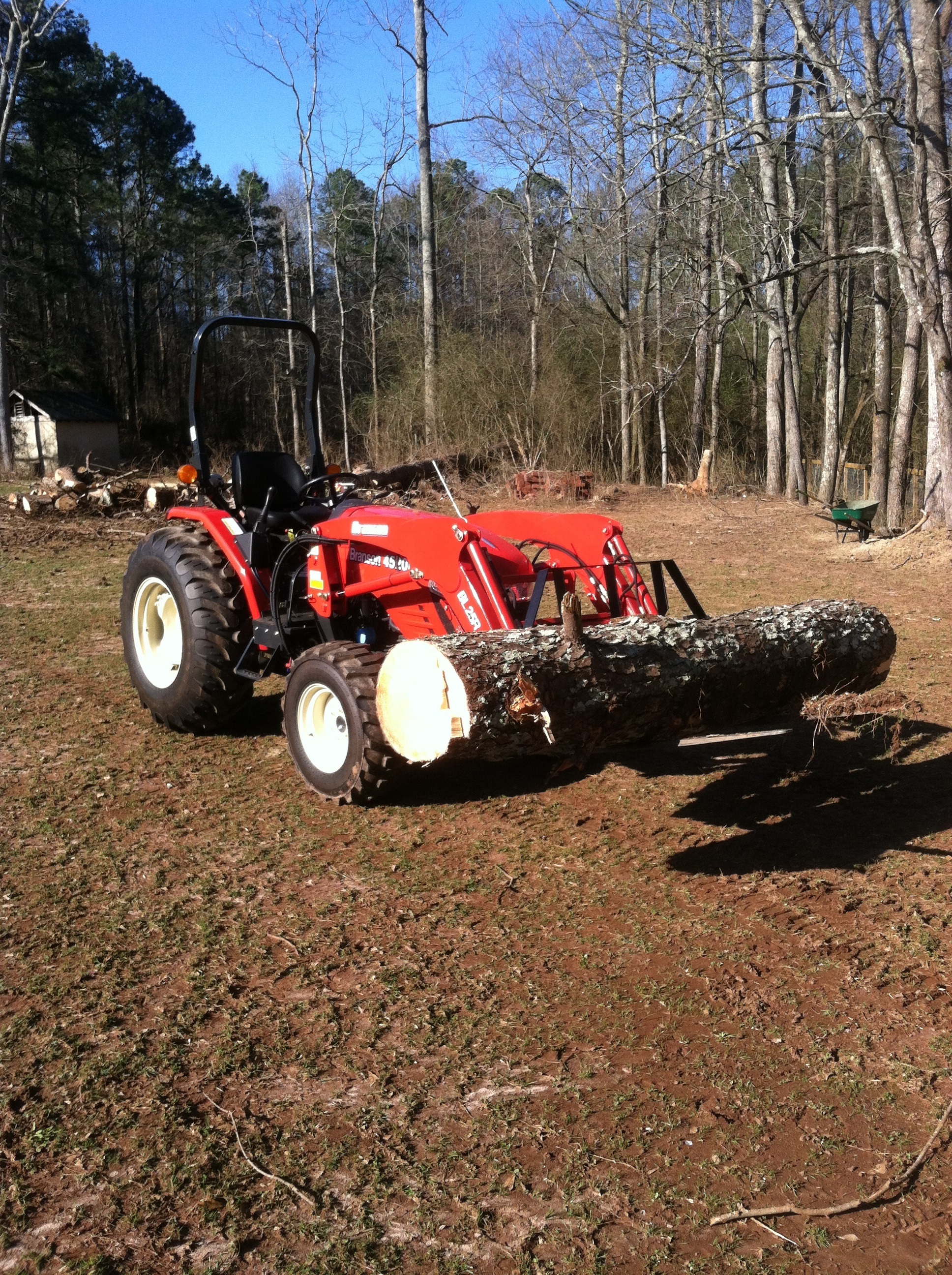

Did some work on pine trees today.
Found the relief valve on the loader pretty quickly!
After putting the tractor in the garage for the night I attempted to remove the nuts that hold the tire/outer rim on in order to gain some width on the back for next time out.
Quickly realized that when bolts are torqued to 200 + Ft Lbs a 1/2 breaker bar and a cheater pipe aren't enough. Going to Harbor Freight to pick up a 3/4 breaker bar, 3/4 6" extension and a 3/4 24mm socket.
I'll document the width in the rear prior and after I extend both sides, should gain 3-4 " I would guess.

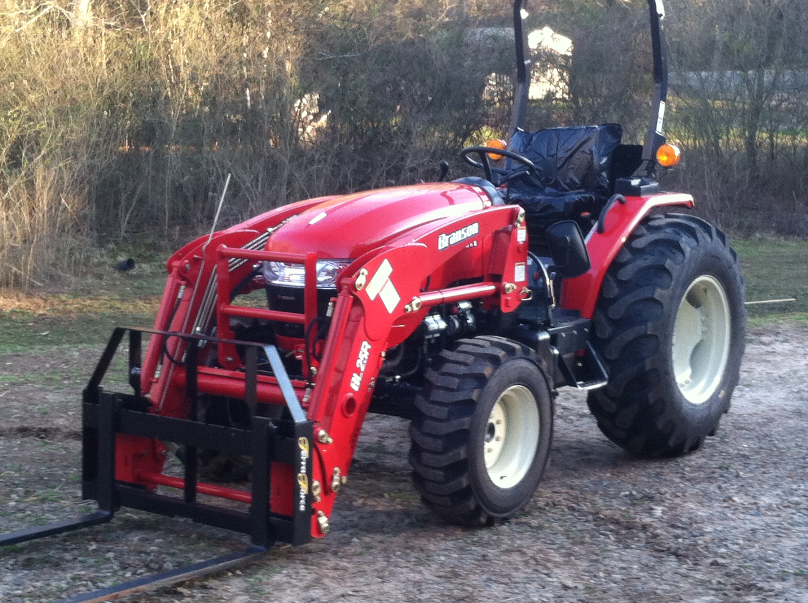

Curious as to why you have ag tires on the rear and industrials on the front. Industrials don't grip like ag tires if you plan on using your 4wd that much. Flip side is that with the almost continuous rib down the center industrials ride smoother than ag. Gotta decide what's important. My 6530 has both ag. to do ag chores. The 2400 has ind and ind and is an around the house helper and grass mower. Don't need a lot of traction but want the soft ride.
If you are going to do something about what they sold you, now is the time to do it. Don't wait.
/ Branson 4520R New Owner
The torque spec is actually 250 # torque on outer wheel bolts according to the manual.
The pictures must be deceiving because all 4 tires are R4.
Fronts are Galaxy 12X16.5 XD2010
Rears are Galaxy 16.9-24 EZ Rider R4
You made me look though. :thumbsup:

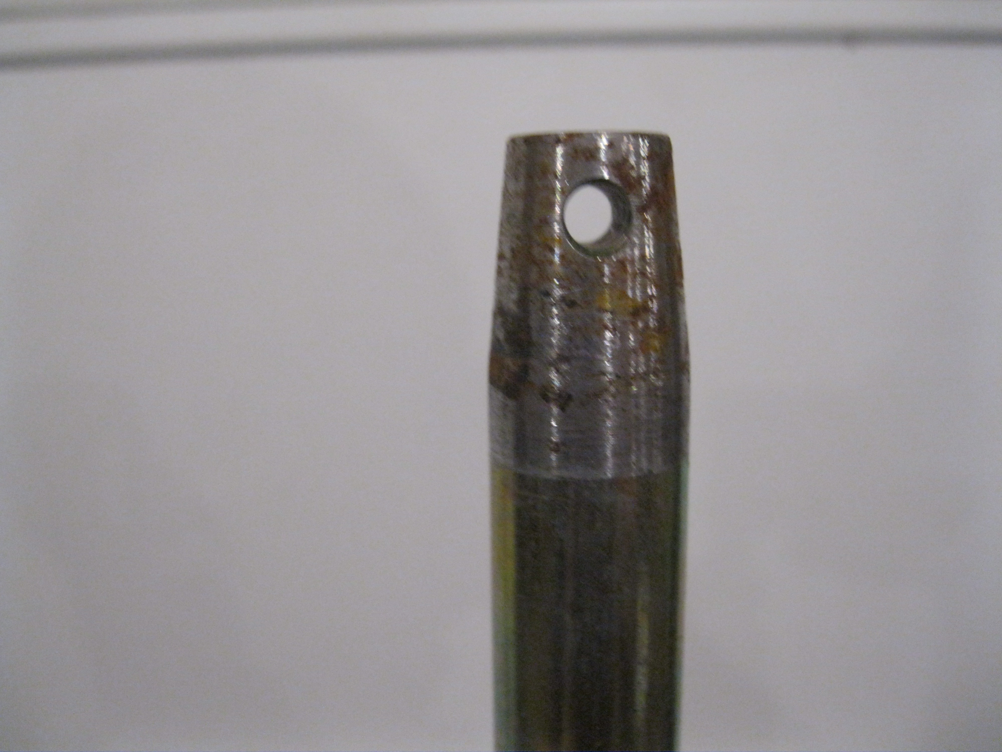

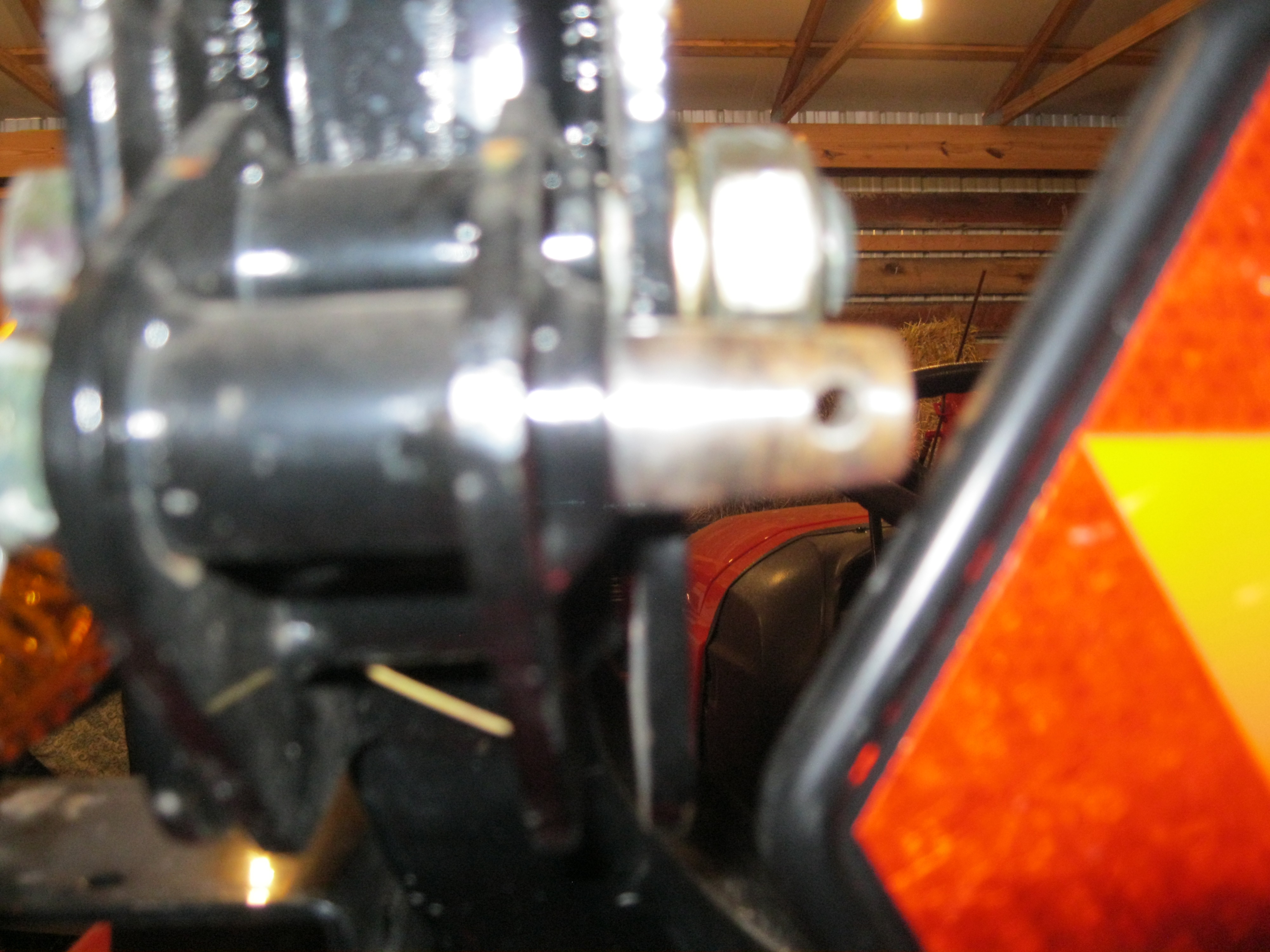

So far only minor things on mine like one of the rops pins is a pain in the *ss to get in and out. Upon inspection it just doesn't line up as good as it should, I'll have to see if I can bend it into position or maybe just grind some of the material off of the pin.
Thanks
I had the same issue with mine, I took them to work and turned them on a lathe to get some lead in on the ends. I will post a few pics of how I modified them. No issues now.
/ Branson 4520R New Owner #10
Here is the way I modified my ROPS pins to make easier to remove. I am not sure of the taper in degrees but you get the idea.

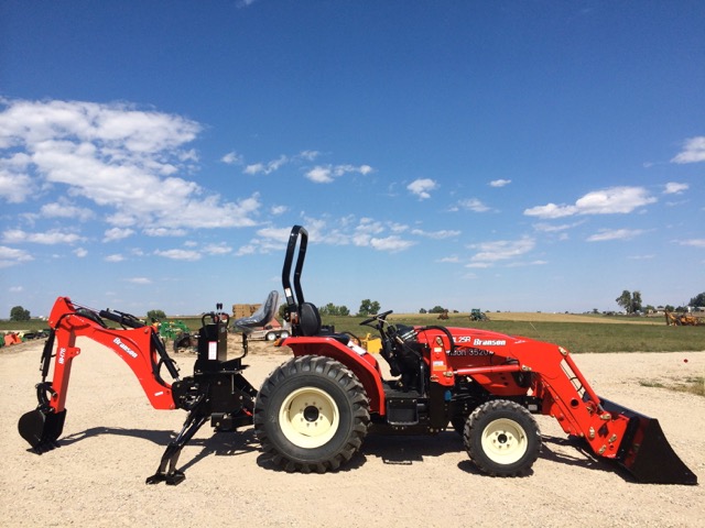

Congratulations on the new tractor. I'm sure you know by now that you made the right decision. I have a 2015 Branson 3520h that I bought a little over a year ago and my wife and I both love it. She thought I was crazy buying a "big" tractor. She thought our Craftsman garden tractor was all we needed. Now, she LOVES the Branson and uses it as much as she uses the garden tractor. Different tools for different jobs.
My Branson has a 6' box blade, the bucket that came with the FEL and a set of pallet forks for the FEL. We also have the Ansung backhoe option that we bought with the tractor. I am purchasing new attachments as needed... one at a time. My next acquisition will be a post-hole auger.
My wife is always switching out the pallet forks for the bucket, and vice versa. You don't know how much you can use a good tractor until you have one.
Here's mine
Phillip
